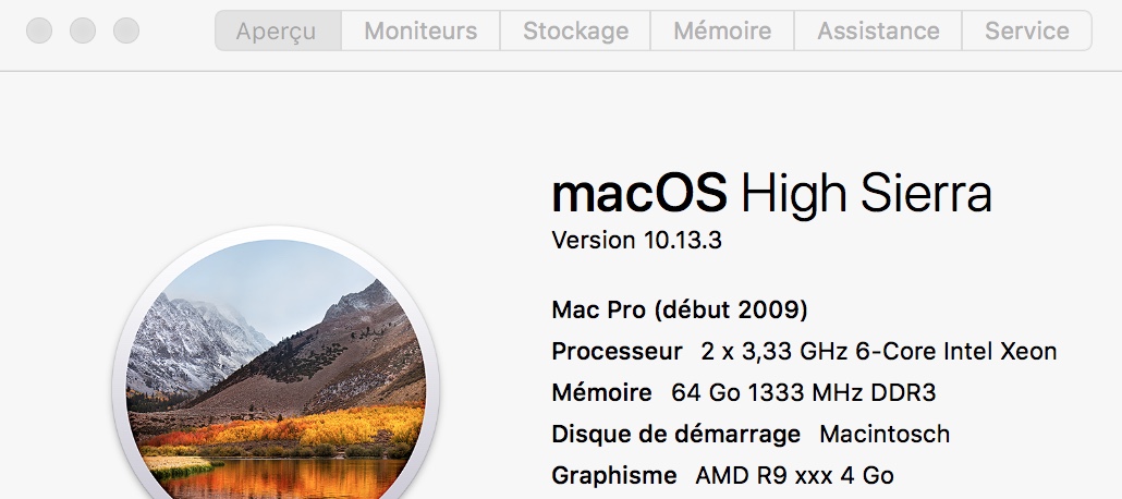

I followed your advice and bought a "GIGABYTE RADEON RX 560 Gaming OC 4G" REV.2 (REV.2 = work without power cables) Windforce edition to handle a LG 43" 4k@60Hz (via DisplayPort),I'm on High Sierra 10.13.3 Mac Pro early 2009 / 4.1 flashed to 5.1 .
The graphic card work OOTB but , I don't know why she 's stated AMD R9 XXX 4GB and make lot of noise when watching youtube HD video for example.
Any suggestions ?
Thanks in advance !

[doublepost=1521898747][/doublepost]The Graphics Card identifier in "About This Mac" is written in the driver I guess a file? Theres post on here about it and editing that file, but not easy and does it really alter how the card perfumes NO! You may find in 10.13.4 High Sierra which is in testing they may, I say they may! have a fix? Yes theres no Boot screen with the RX 560 but Cmd R recovery works, yes you have to wait but it works for me. If you need to Boot from another drive set the "Start up" drive when in High Sierra and reboot? I still have the GT 120 also so can get the Boot screen with a cheap monitor. I tried to switch the monitor cable using one monitor to the RX 560 but does not work very well? As to noise I think thats in a different area?
Thank you very much Sg335man,
I will wait for an update of High Sierra with new drivers !
Is it possible to enable audio on DisplayPort on High Sierra 10.13.3 ?
