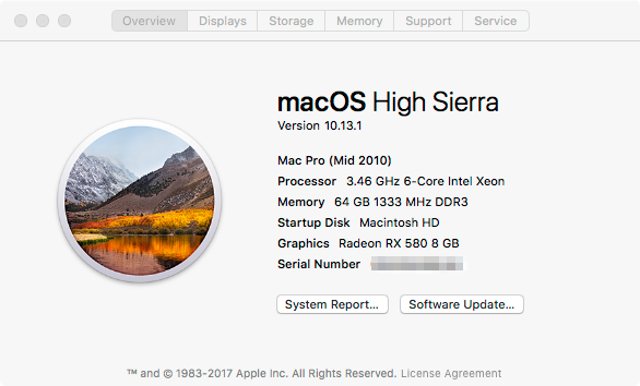

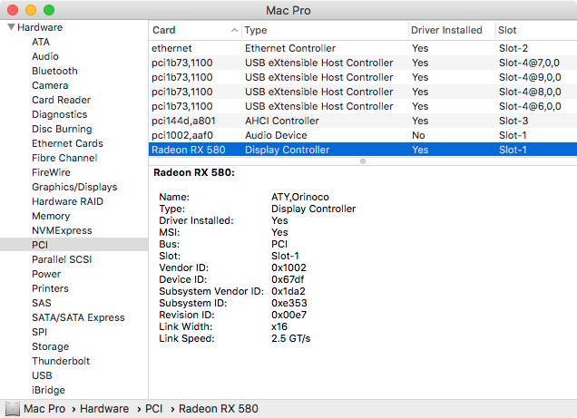

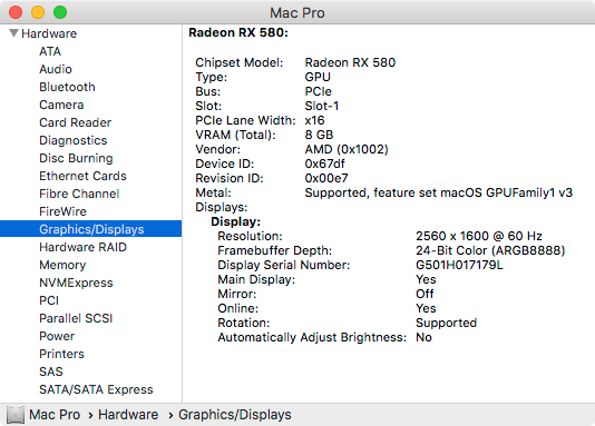

Having just installed a Sapphire RX 580 Pulse 8GB I can't recommend it highly enough.
No boot screens but otherwise it's perfect. Good performance, recovery works fine, it does 4K/5K @60Hz, plenty of RAM and natively supported in macOS.
