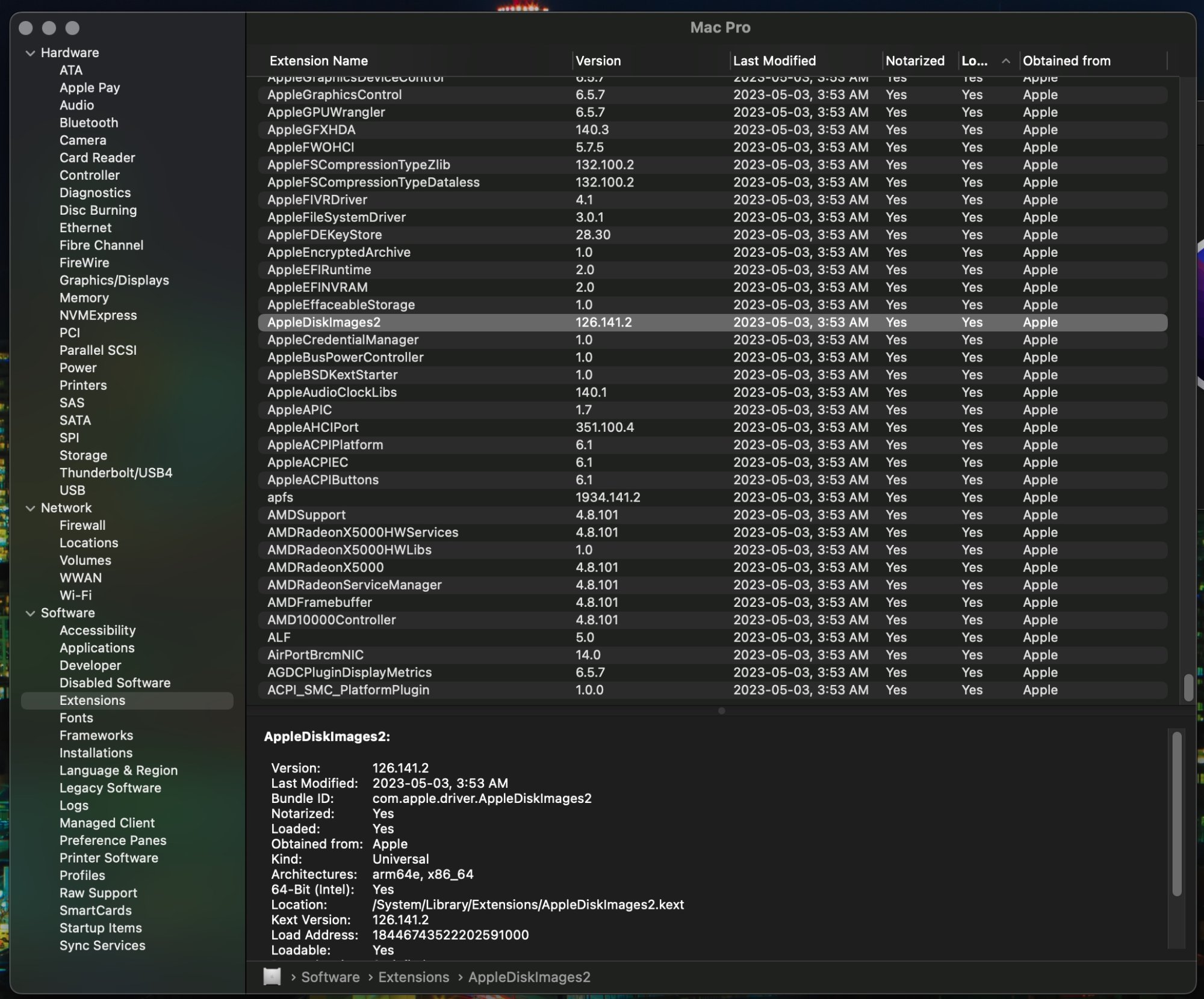

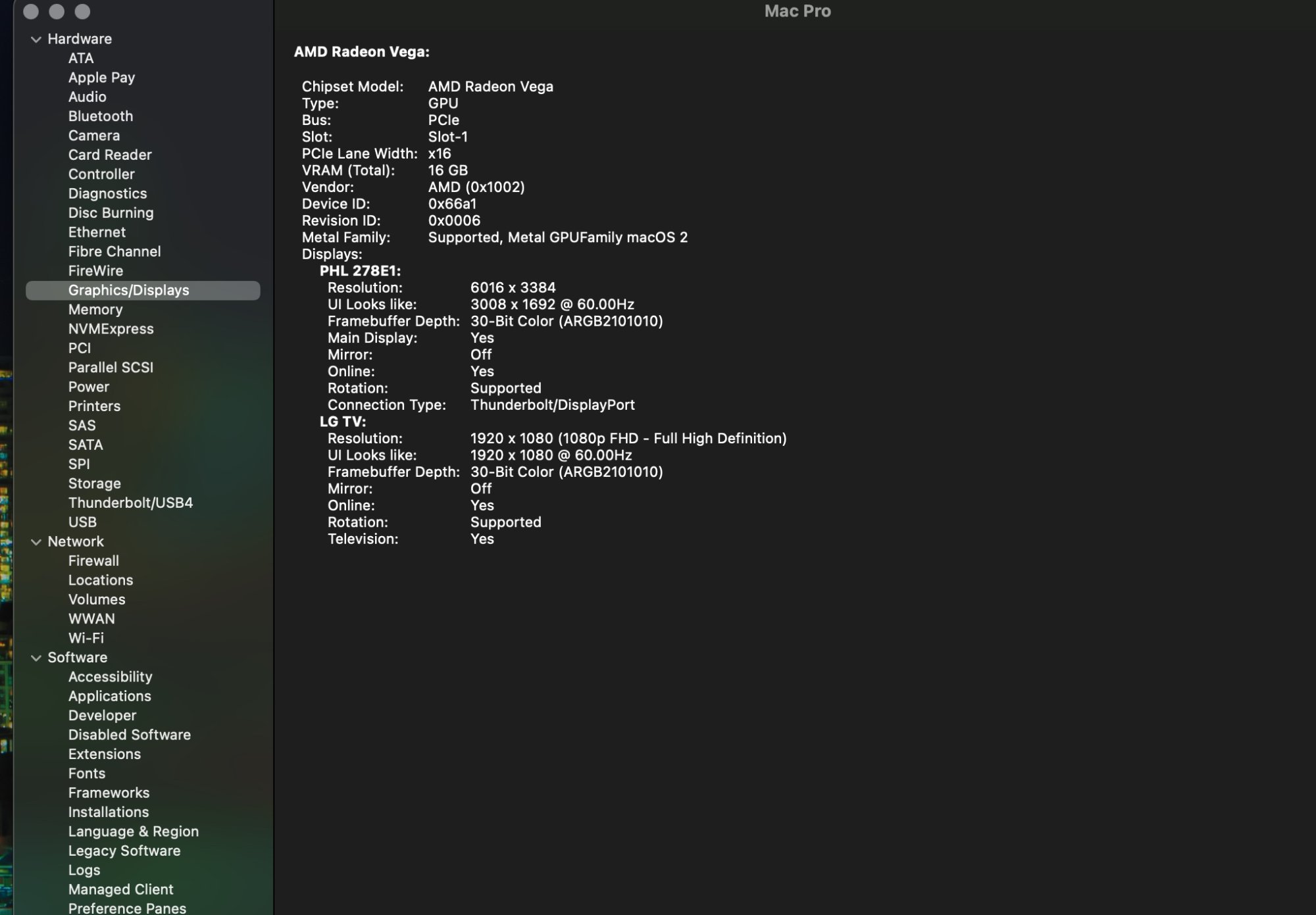

Don't know how to read the info that you've asked for so just posting it here. I'm on Monterey if that means anything.
UPDATE: So the Radeon Pro VII is working great. Other than not working at full capacity for most renders/exports. I've somehow gotten a little more juice after a fresh install, more on the processor side of things. And barely on the GPU side of things. The Luxmark results are great. Full on both. But exporting in both FCPX and Davinci are meager (30% max) even with ProRes, but definitely seeing a better result for CPU's.
Other than that, the cable fixed my original problem of image cut-outs/black screen. I'm guessing if anything the speed boost of fresh install might be because I'm running on a PCIe boot drive now. Which is great to have back. I'm ok with results at the moment given the improvement PCie boot is giving me. That said, if there's anyway to actually get the max use of GPU I'm all ears.
UPDATE 2: So reading over the other posts you made @h9826790 I used OCLP to inject GOP, and seem to be getting a little more performance. I couldn't actually get your package to work properly with my system. Even after fresh install on a mojave drive. So currently going with the tried and true OCLP but with the GOP injection option selected.

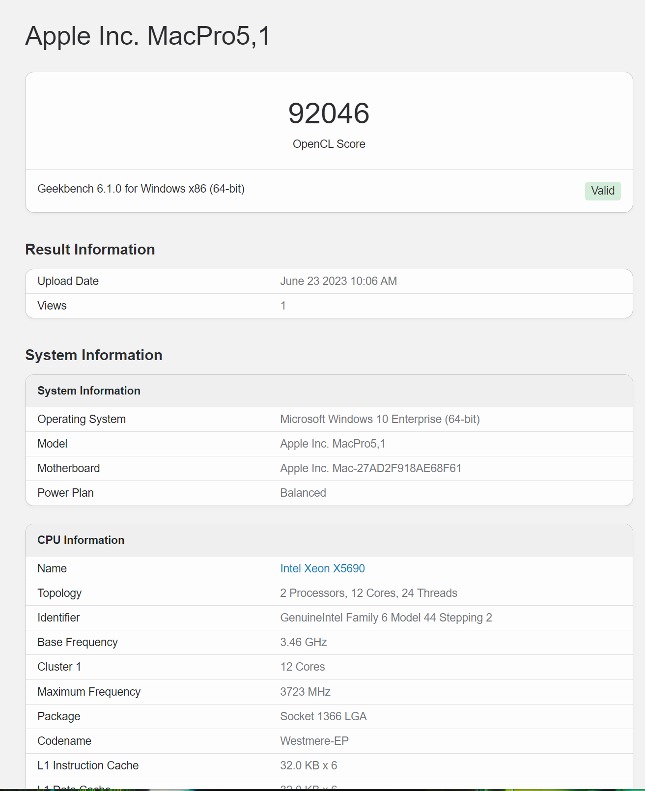

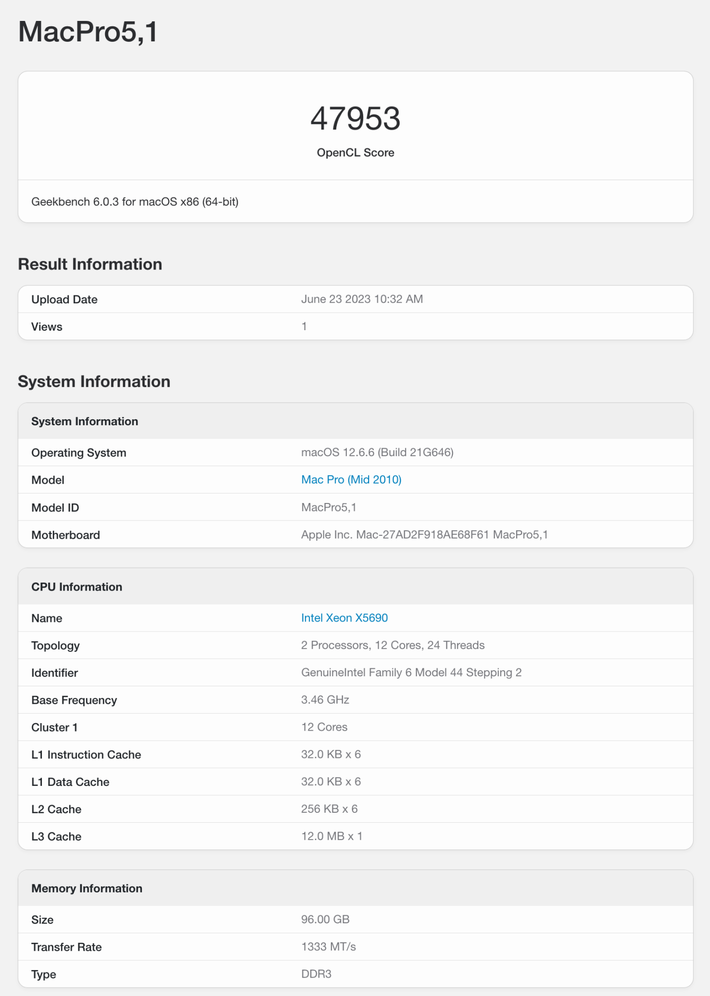

Another interesting fact. Kind of annoying knowing this.

Ah, there we go. Lots of GPU is being used. Like 80% average with barely any CPU support. I guess I just figured the GPU would be used a lot more when exporting in various codecs. Especially with FCPX (although I am fully making the switch to Davinci so yeah).

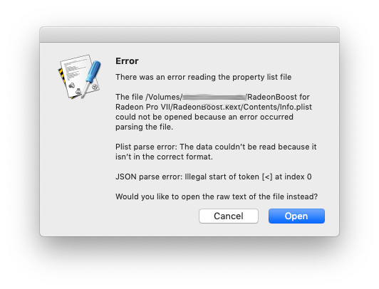

This is the RadeonBoost kext created by CMMChrist, but I modified it a bit to fit Radeon Pro VII. Hopefully the extra device properties injected can make Mojave ident your GPU as a Metal device. If you don't mind, you may try this kext. It's a codeless kext, should be no harm. And you can open the info.plist to see what's injected.
If you are OpenCore user, you may simply inject the property via OC config. Or inject this kext via OC should also work.
If you installed this kext to /L/E, then something goes wrong, then a NVRAM reset to re-enable SIP should automatically disable this kext.
There is a mistake in code and so plist file can't be opened. Seems you forgot to add <integer>0</integer> after <key>PP_DisableULV</key>
Here is correct version:
