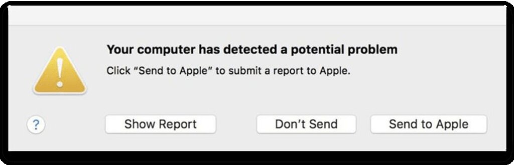

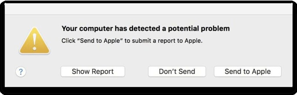

Hey there @ikir — just curious if you have gotten any instances of the "your computer has detected a potential problem" pop-up since you did the "12.3 Beta v5" work-around. Have you seen anything that looks like the pop-up below?
That's not a problem. It's just an EFI check. The system detects a mismatch because the beta firmware version isn't listed in its database.
Thanks — that's kinda what I figured, (and hoped). I'm still awaiting some word back from Apple Engineering to see if there's a way for them to properly run "Apple CaptureData.app" on my machine (it keeps crashing part way through)
