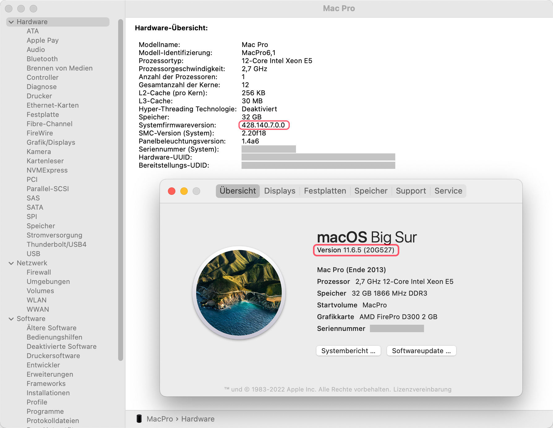

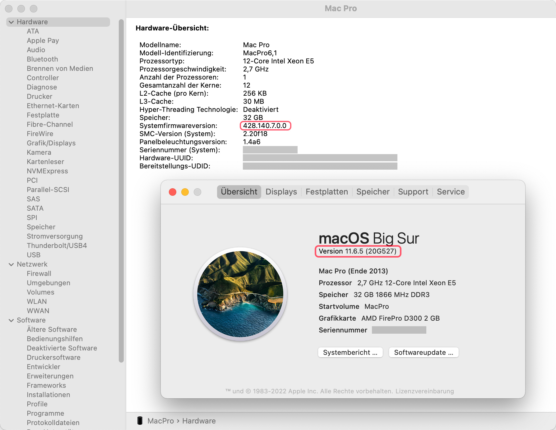

Good news for those (few) who haven't updated yet but want to for security reasons:
Using the createinstallmedia method and installing OpenCore to the USB device to fake a higher SMBIOS version lets you update only the OS without firmware.
I don't see the point in switching to Monterey yet, therefore I installed the latest Big Sur 11.6.5 from some days ago which also has the 429 firmware since several versions.
