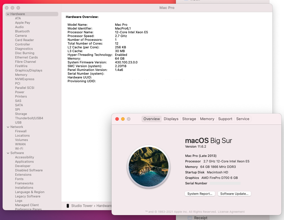

Its fixed :) updated to 430.100.23.0.0 firmware and its not crashed once. Thanks @MisterAndrew for the initial find.
For the inevitable questions:
1. Running 12.3 - public release
2. 1TB Intel SSD
3. MP 6,1 /w Xeon 12core proc, D300 graphics.
4. To grab the 430.x firmware; install 12.3 beta 5. I cant comment on earlier betas; but this is the latest one prior to the release candidate builds and this contained the 430.x firmware update for me.
I'm not sure if the forum permits linking to these builds; so either utilise the installmacos.py script or Google!
Okay, so I have just completed the same process you did. I am now on the 430.100.23.0.0. My Mac Pro 6,1 has the exact same config as yours. Fingers Crossed, I hope I wont have any more of the dreadful sleep crashing. I will post my updates on how it goes.

Just wanted to provide an update. It's been about 24 hours since I the firmware update 430.100.23.0.0 from Beta 5 and so far, my Mac Pro has not crashed during sleep. I must also admit that my bluetooth mouse and keyboard are more stable. I previously would experience Magic Mouse stuttering and drop outs -- and now this has gone away. I will let you know how it goes with the sleep-crashing in the next 24 hours.
Update #2: Not so good. My Mac Pro crashed overnight. I was optimistic and left it running with most of my apps open, i usually Quit all my apps to avoid crashing. -- so I'm unsure what has caused it to crash :(.

It wasn't very easy to find the page it's listed on, but I found it here: https://mrmacintosh.com/macos-12-monterey-full-installer-database-download-directly-from-apple/
I just downloaded the 12.3Beta V5 from that link on Mr. Macintosh, and using a spare USB SSD I was able to install the beta / my machine is now showing 430.100.23.0.0 — I'll start my clock now and report back over the coming week+. Worth noting, I'm the one who's running Big Sur on this machine and still continued to get the crash-during-sleep even after taking ALL versions of Monterey off of the machine. So, it was very clearly NOT just the OS causing the crashes — if this FW keeps my machine from crashing during sleep, I'm gonna hold fast on ANY updates until they have a release that officially includes this FW.
If nothing else, this (if it solves the problem) will allow me to eventually sell-off the machine with a clean conscience, once I do finally move up to a Mac Studio.
Thanks for your efforts too, eager to hear your results later.
I'm running Mojave on external NVMe now on a D300 429.60.3.0.0., up six days now. Tried some sleep, no crash, but no long sleep yet. Will try that next. I couldn't find all the variations tested, so I'm trying myself.
