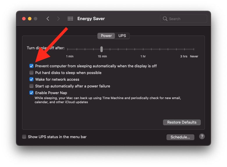

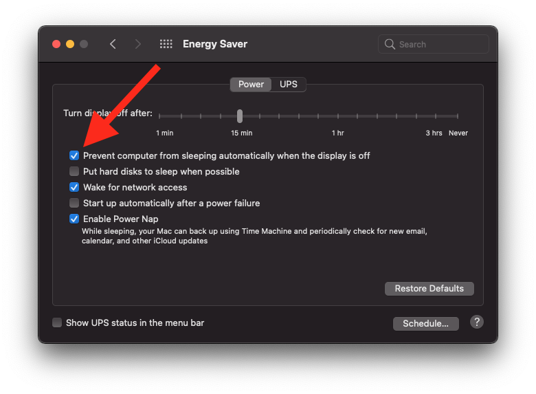

BTW, it won't do any harm sending Apple a link to this thread via their product feedback page. Apple Support will not look at a link sent to them and suggested sending the link to product feedback at https://www.apple.com/feedback/. Hey, desperate times...
Actually, that earlier instruction was likely made in error. The first option in the Energy Saver pane is a negative tense in the sense that when it is selected is turns off power management ("Prevent computer from sleeping automatically when the display is off"). This option should actually be turned on which prevents the computer from sleeping and thus, crashing. For a couple days now I have not experienced a crash on either Big Sur or Monterey with this option selected.

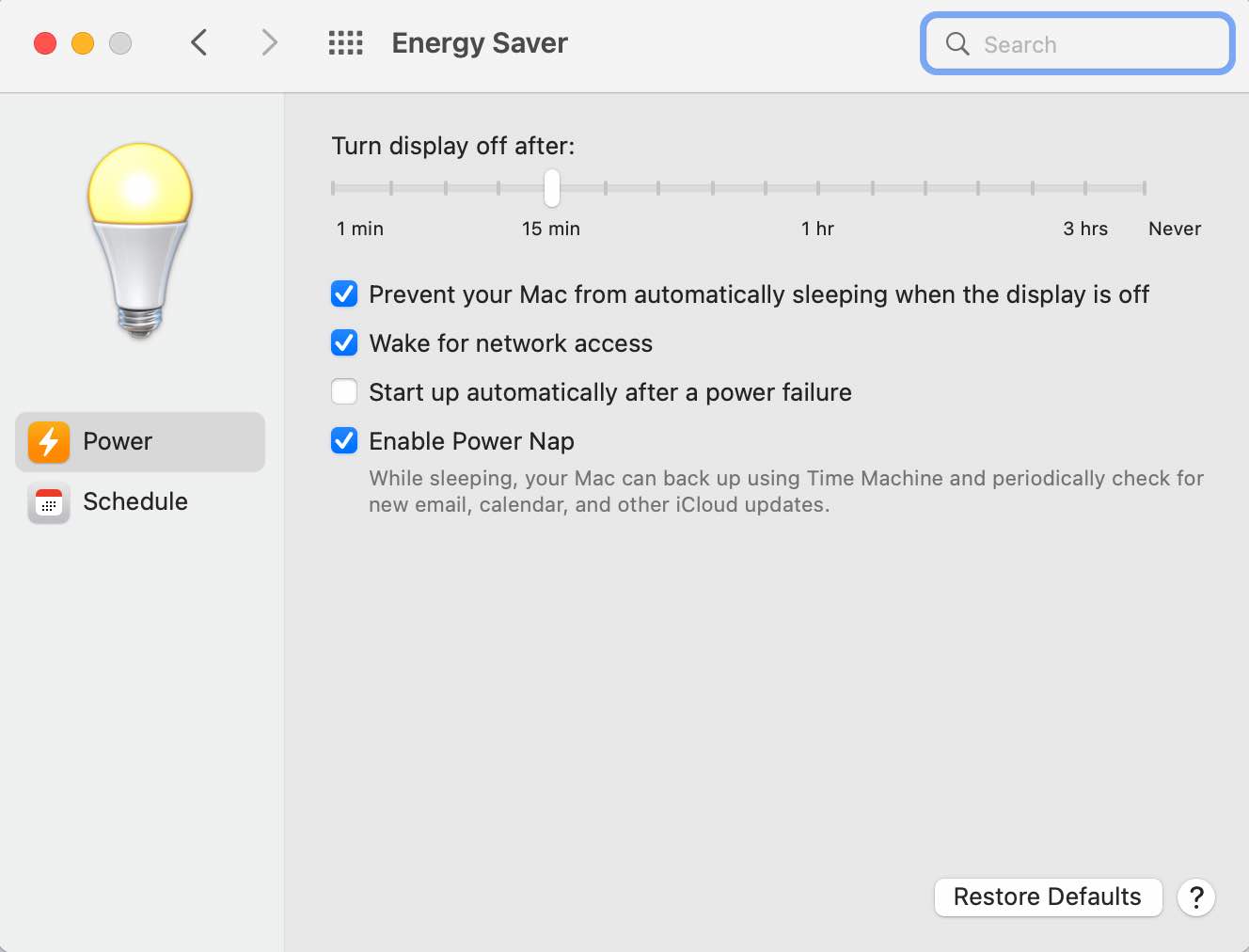

Thanks for the follow-up. That option was checked originally when I first experienced crashes. I turned it off as it was earlier suggested that this may help. It didn't.
I am not sure this will help but it doesn't hurt to try again. However, I am not trying to prevent the computer from sleeping when the display is off. I manually Sleep from the Apple Menu at the end of the day or when I just want to put the computer to sleep when I'm not using it, which is why I don't think this will help. I will update again after enabling this option again and seeing how it behaves.
If I'm enabling this option, I'm not experiencing crashes anymore because I don't put it to sleep manually.
