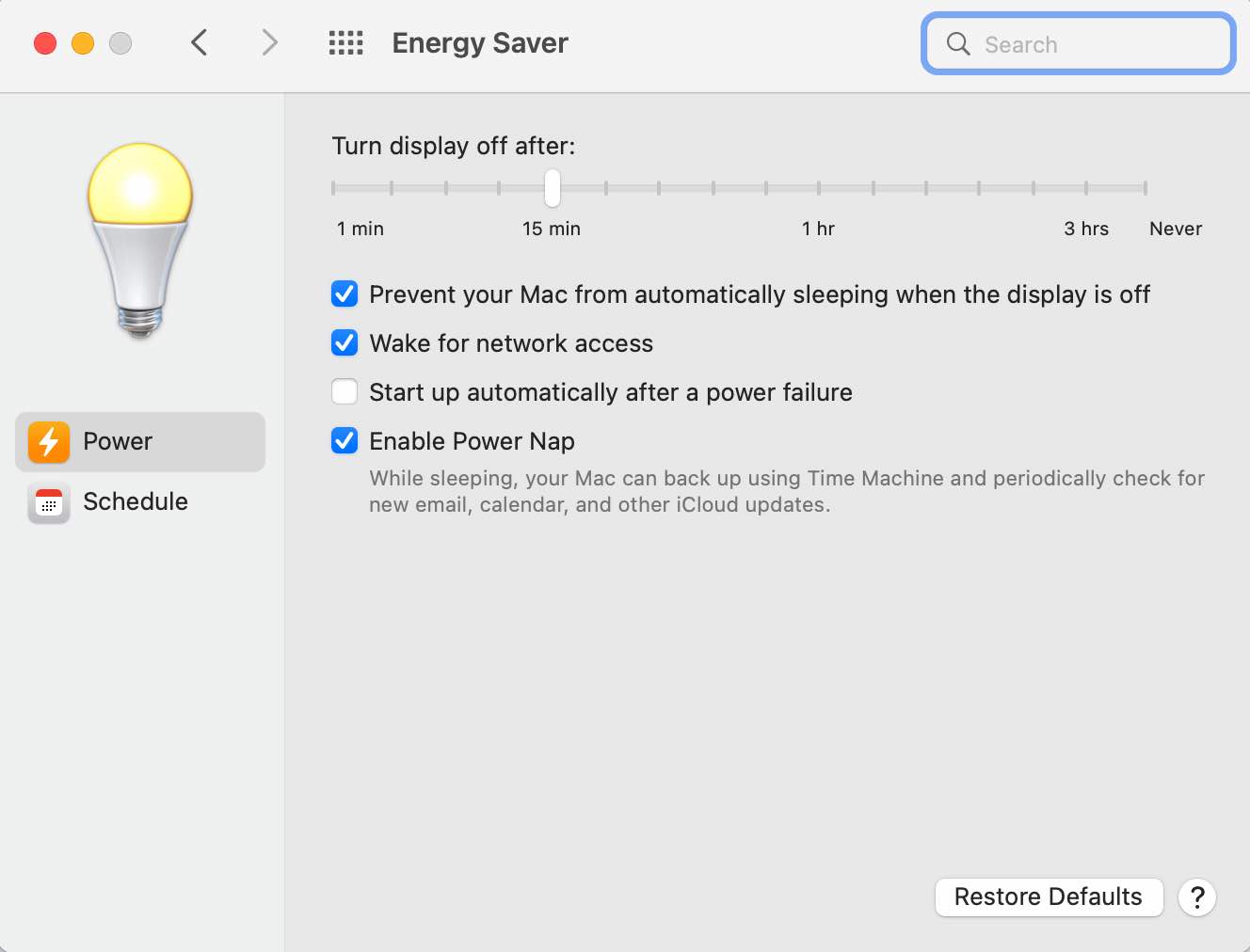

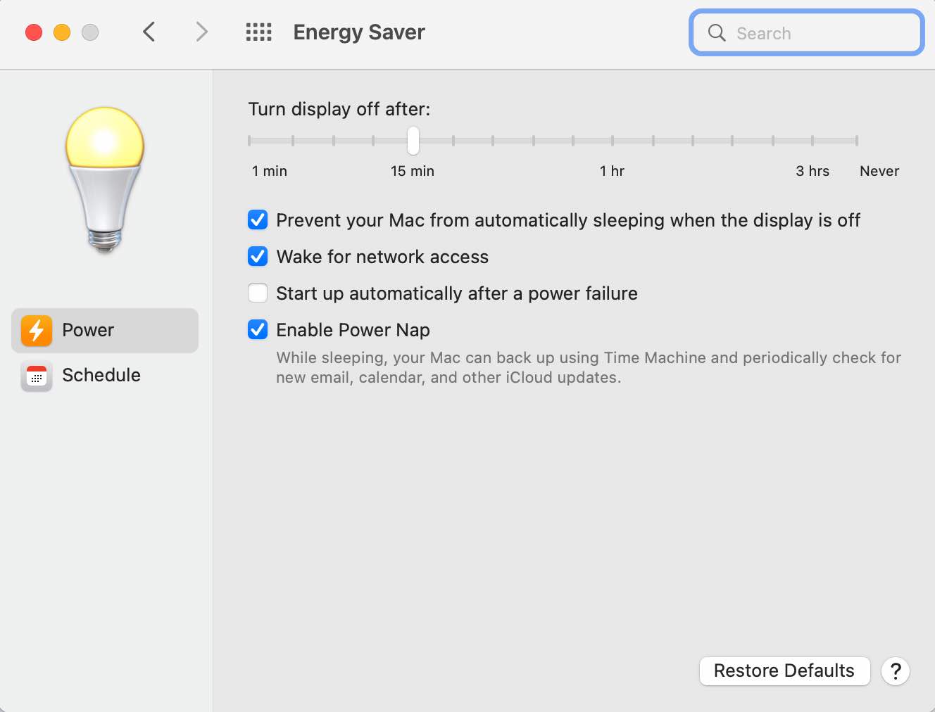

My mistake. I looked back at my first post to this thread and I unchecked "Enable Power Nap" and "Wake for network access" as a troubleshooting step, which didn't work. I'm guessing that nothing will work at this point but it doesn't hurt to try certain suggestions so I am currently running with the following settings.
I am using a Mac Mini with an LG TV connected via HDMI so after 15 minutes the computer goes into low-power mode (wakes up with a keystroke or mouse movement). In this case, I don't believe the "Prevent.." option applies. Anyway, it hasn't crashed in almost 2 days but I don't expect that to last. If it does crash again I will just shut it down overnight or for long absences until this is fixed.
An update on my situation since my last update had some errors on my part and I wanted to clear that up. With the settings above, my display would turn off after 15 minutes and would go into "display sleep" meaning the Mini is still running but the TV would no longer show the output from the Mini. The "Prevent your..." checkbox ensured that it didn't fully go to sleep and it was just "display sleep". Naturally, it didn't crash (~5 days) when I woke it up because it wasn't coming out of a full sleep and was actually running the whole time.
This seems pretty obvious to me now but I managed to confuse things along the way. Anyway, it of course crashed again once I unchecked the "Prevent your..." option. As it stands now, I will no longer have it manually or automatically sleep and will just shutdown when I know I won't be using it for more than a few hours since it's better than "display sleep" or having it crash.

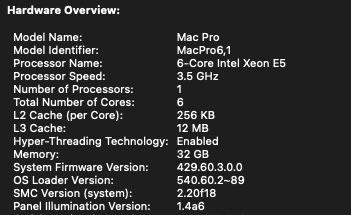

Where would I find the bootrom version in 12.1? In system information, I only see what's attached. I wanted to check as I've been running a third party Auro Pro X2 SSD in my Mac Pro for a couple of years, but have also had this intermittent crashing bug since Monterey launched.
