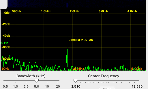

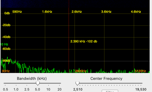

To test my Ultra to see if the whine was present I placed a microphone on my desk midway between (6" both directions) the rear of my MS Ultra and a speaker pointed directly at me. There was a monitor about 3" behind the Ultra which would reflect any sound from the Ultra back toward me and directly toward the microphone. I hear absolutely no whine from my Ultra even if I place my ear inches away.
I was seated 18" directly in front of the speaker. I played the YouTube test tone recording from the comment above at a volume that was just barely detectable to me seated 18" in front of the speaker in a very silent room. (So barely detectable I would have had to look to be sure the test tone was playing if I wasn't controlling it.)
Here's a picture of the audio spectrum with the Ultra always on with and without the test tone playing.
Notice the barely detectable test tone is more than 30 dB above the Ultra's noise level in the frequency range around the test tone.

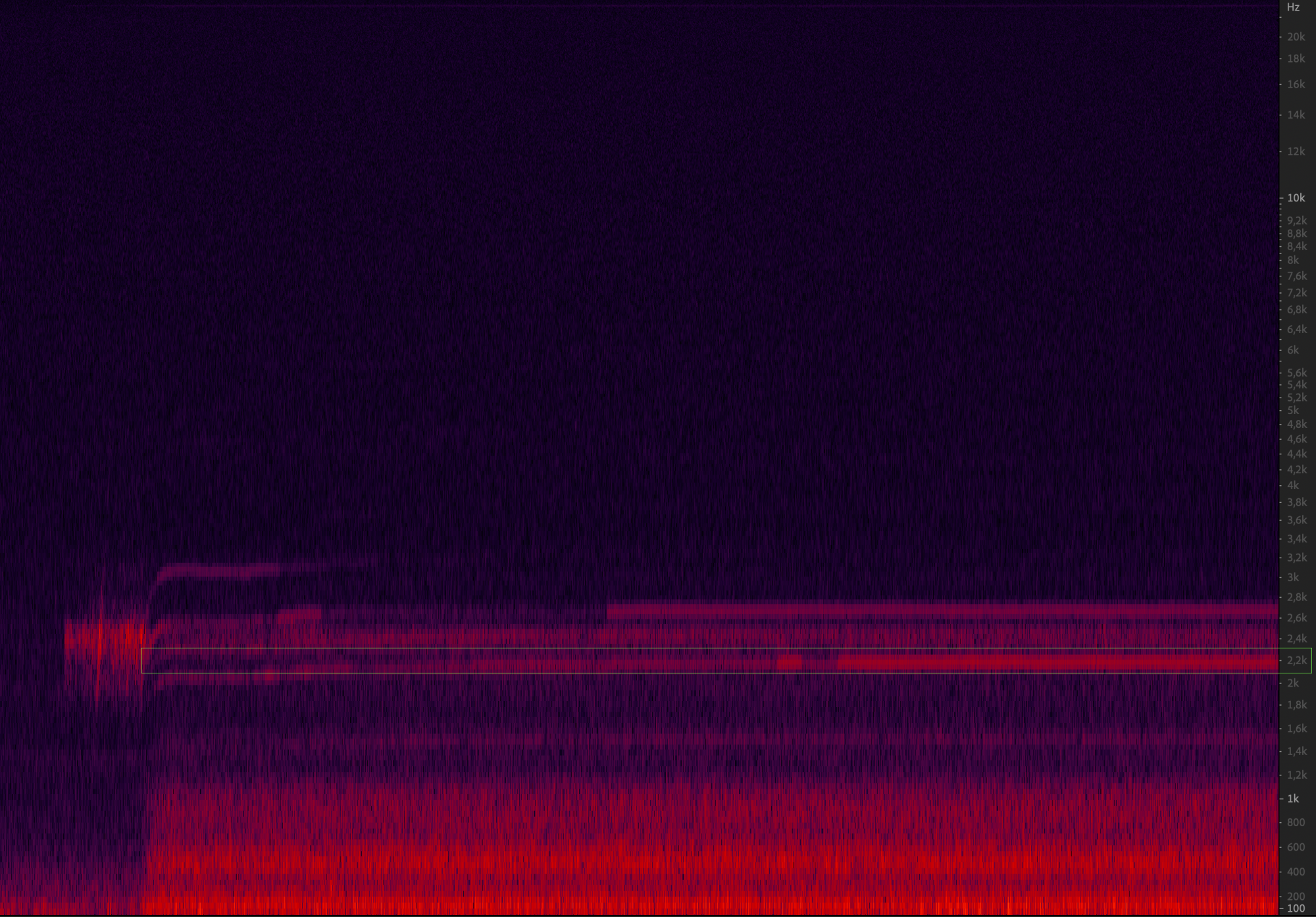

I have the same problem with the whistling. Sometimes it's not audible and if it starts whistling it can be heard all over the room. It's about 2.2k Hz and annoying. A preview of the spectral frequency when running Studio. Immediately after start up it is not audible until after about 25 seconds. At higher speeds the whistling is more audible, only then does it fade into the airflow noise.
Interesting. I wonder if the frequency changes at different fan speeds? This would indicate whether or not the noise is caused by the fan through vibration or friction as it spins.
On second thought, if vibration/friction was the cause, you’d expect this to cause the noise immediately, not 25 seconds after startup. Hmm.
1300 rpm = 21.6 rp sec = 1/100 of the frequency shown above. (Probably meaningless, just thinking out loud).
At higher fan speeds, the fan changes intensity, gets louder, and increases in frequency.
At normal speeds, covering the left side of the vents, as viewed from the rear, can dampen this whistling. Overall, the noise is immediately less audible. Maybe it just doesn't penetrate to the outside.

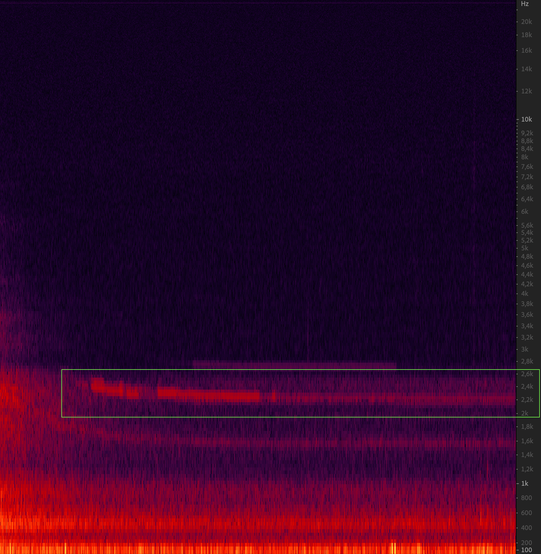

Whistling like this?

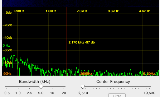

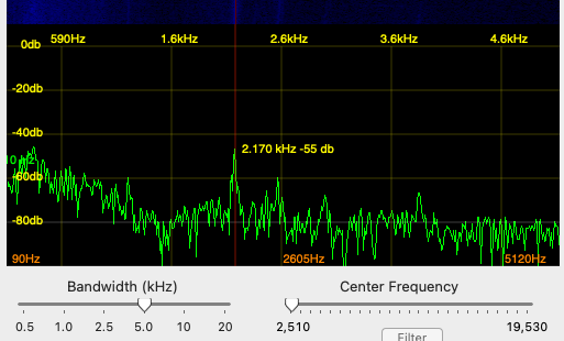

I played your recording through a speaker and the first image clearly shows the 2.2 kHz "whistle" about 30 dB above the noise floor.
The 2nd image is my Ultra (made in Malaysia) with the same mic 2" from its rear, in fact facing its rear - not a good idea in general, but I didn't want to miss a higher frequency whistle if it was there. There's nothing around 2.2 kHz that's above the noise floor.
I'm simply trying to show the "whistle" is not a "feature" of every unit - likely faulty fans.

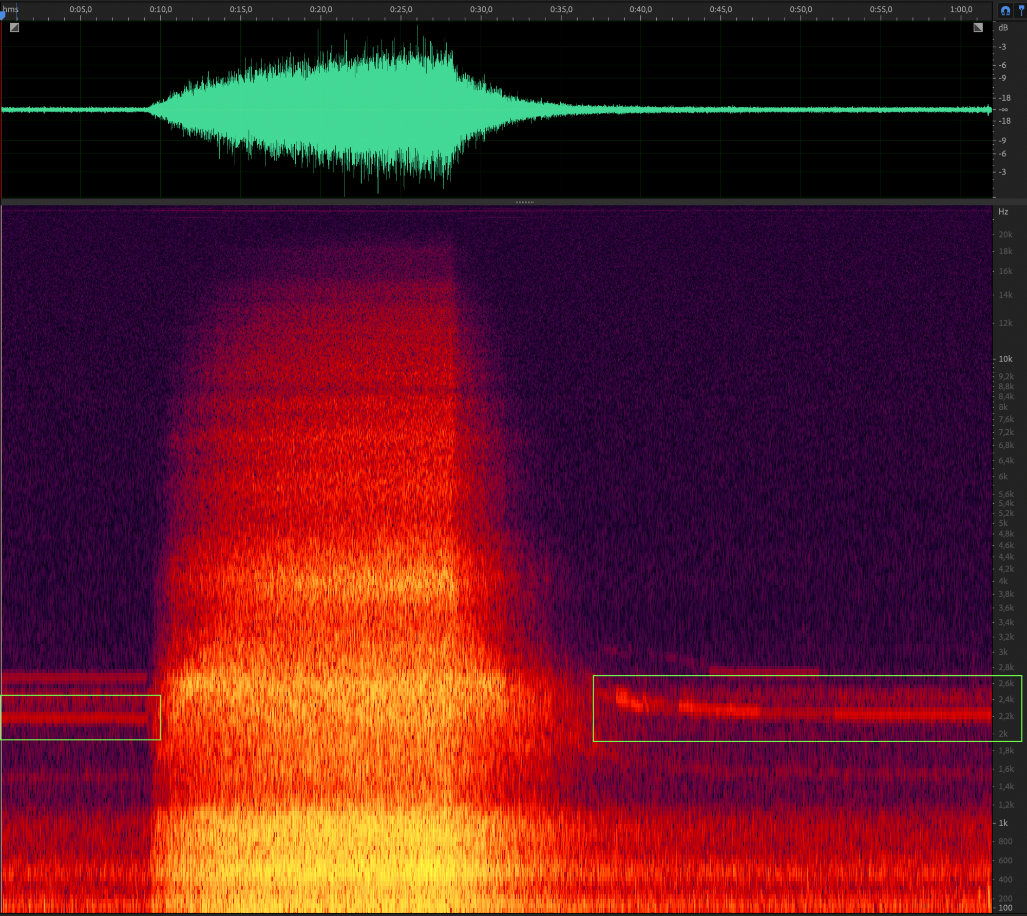

I'm sending a preview and audio. From idle speed to max and then back to idle speed again. Microphone about 10 cm away.
I noticed that after the first run, the beeping sound came after a few minutes. Maybe something must have warmed up.
This is an Ultra model made in China.
  • noise.mp3
    1.9 MB
