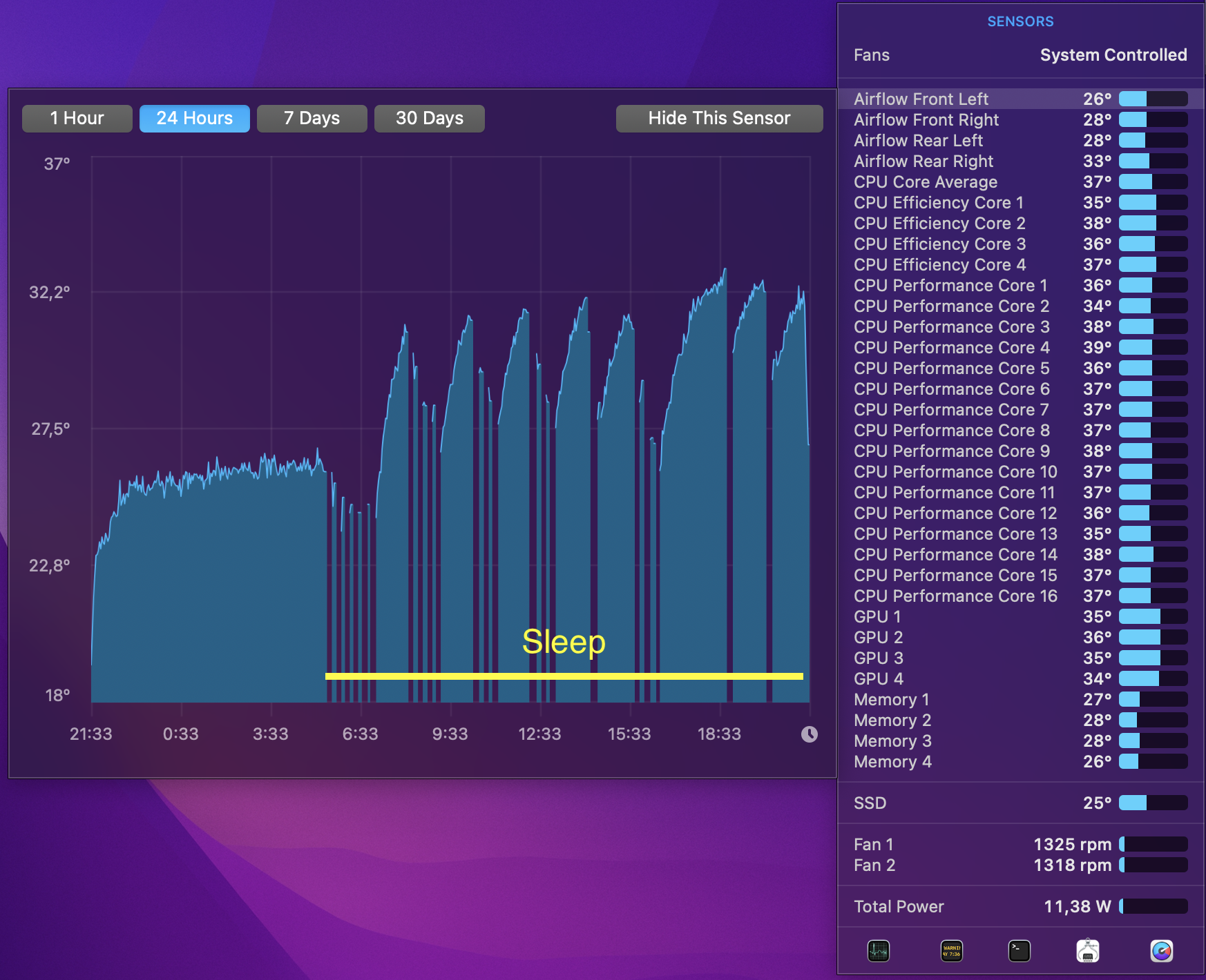

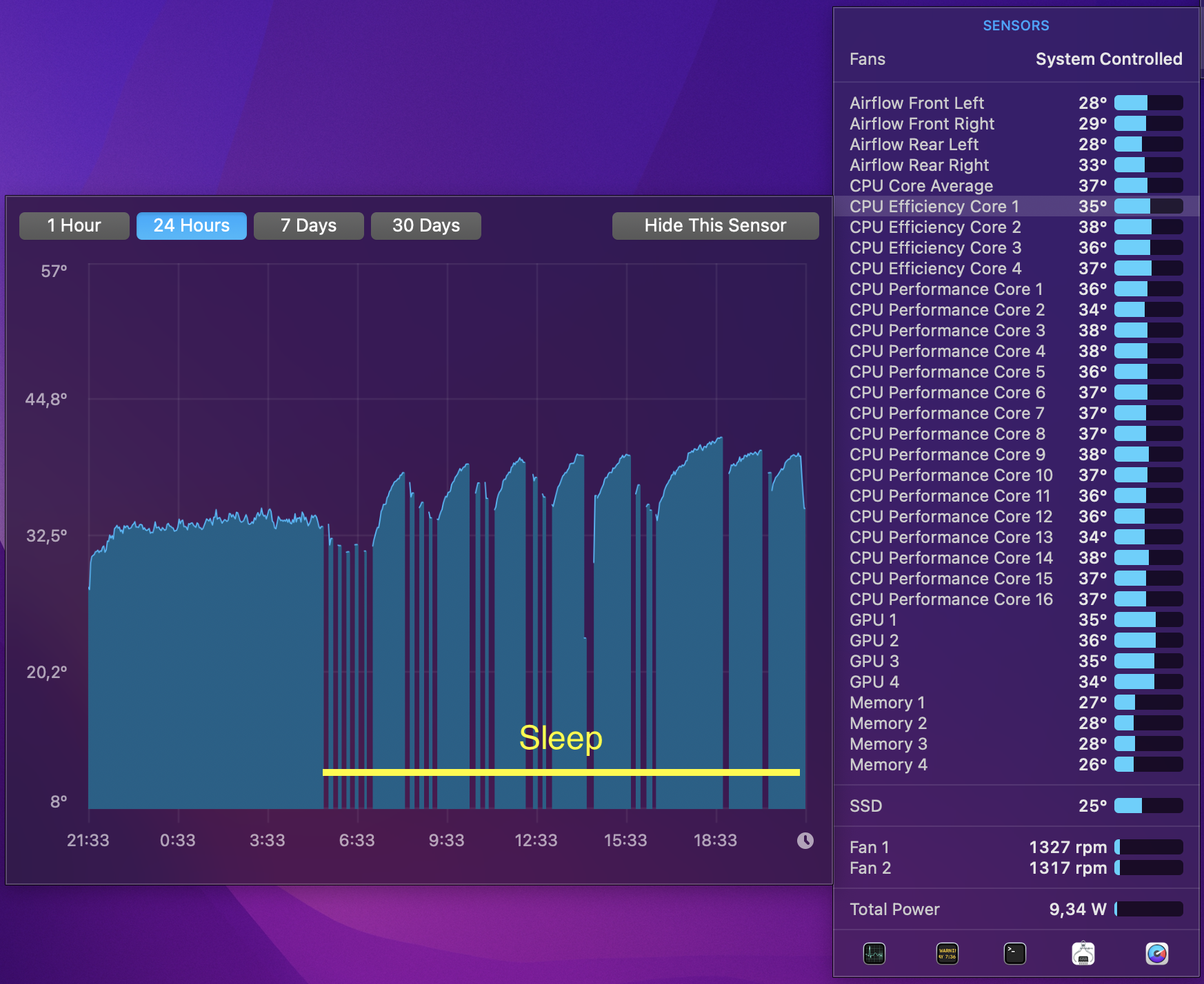

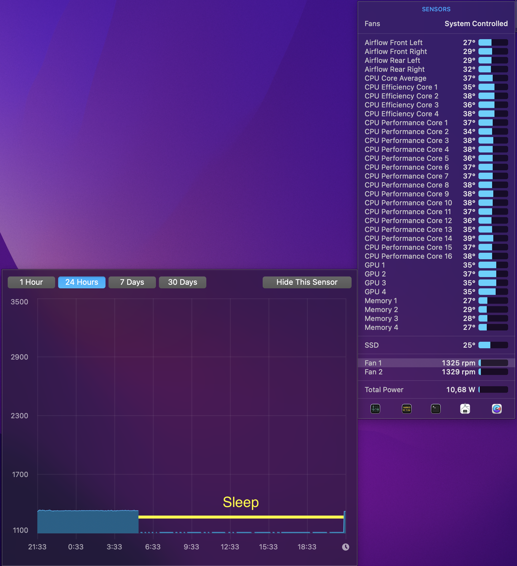

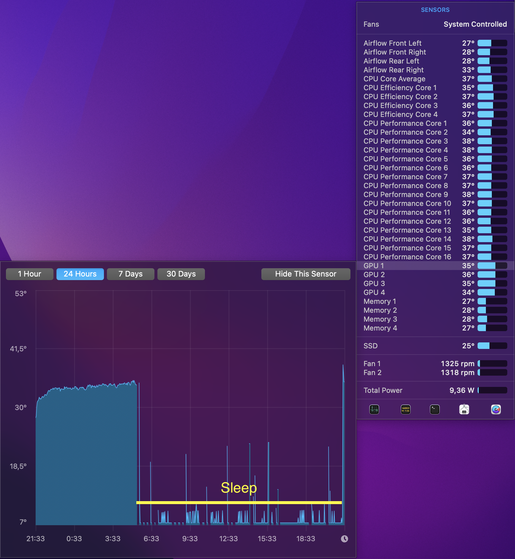

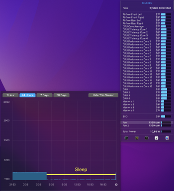

I only put Mac Studio to sleep. Now I noticed that it was working in the background while sleeping (despite disabling "enable wake over network") and not once did the fan start. The temperatures are much higher than normal web browsing. A single GPU was not used. This kind of blows up the conjecture that the fans must be running because of the power supply.

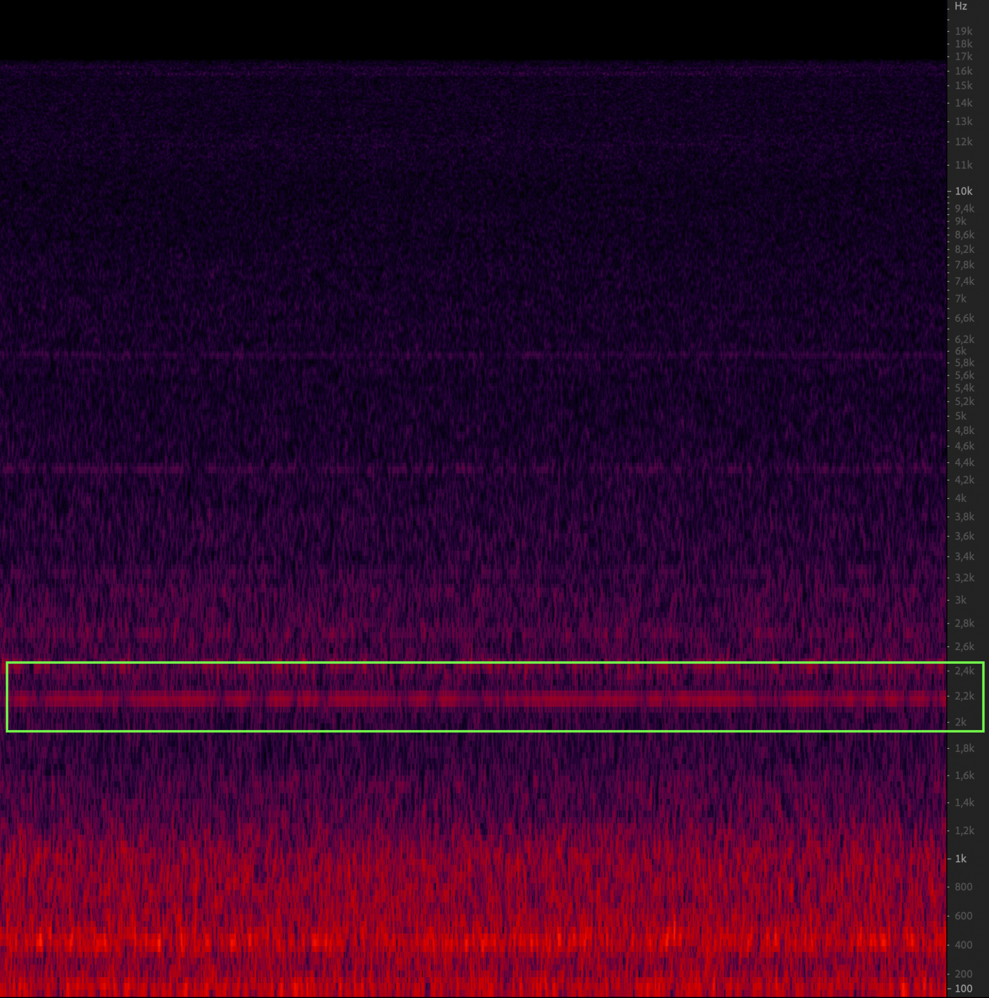

You can see from your recording that there is a squeal at 2.2 kHz and dropouts occur - this is very audible afterwards.
I have been using the Mini M1 for a year, using only SSDs, I have also got used to the silence. The weak pure noise does not bother me, but the whistling in silence does. When I move my head, the intensity changes as there are other sound reflections against the wall, etc. It's like an insect jammer. :mad:
