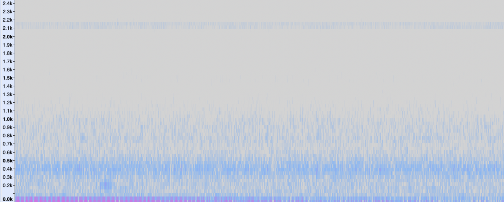

My Mac Studio arrived today and as is expected, one of the loudest Macs at idle.
Good:
  • The fan sound is more pleasant than the Mac Pro 2019 blower. It is much less annoying and doesn't feel like it's cramming buckets full of air every second. I think many people will be fine with it.
  • When forcing it to 1,100 RPM it is easy to tune out - It is still louder than an iMac Pro at 1,100 RPM.
Bad:
  • At the default 1,300 RPM it is more noticeable. It is not "silent"
  • It has a higher fan speed than is needed at idle. The fan speed is overkill at idle.
  • It's going to be hard to clean - Dust may be a problem in future.
Ugly:
  • It exhibits a whine at 2.14Kh. This tone varies a lot in terms of when it appears. It is annoying.
Overall, I would likely keep it if 1,100 was the default and it didn't exhibit the terrible whine. So maybe with a firmware update and the whine fixed, I'd buy it.
For now - I'm sending it back. I might wait to see if the iMac Pro makes a return next year.

Is the Mac powered by 110V or 220V?
If you cover half of the holes with your palm (to seal it so air doesn't flow), does the whistling and noise stop? Try the left side especially.
220v. It does reduce the noise but doesn’t always deterministically stop . Especially on the left side. But note that is the left side when the studio is facing forward. I’ve got it until Friday so happy to run more tests to help you guys until then.
I'm taking it from the rear view when you're looking at the holes. Definitely check it out, I'm curious!
