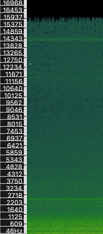

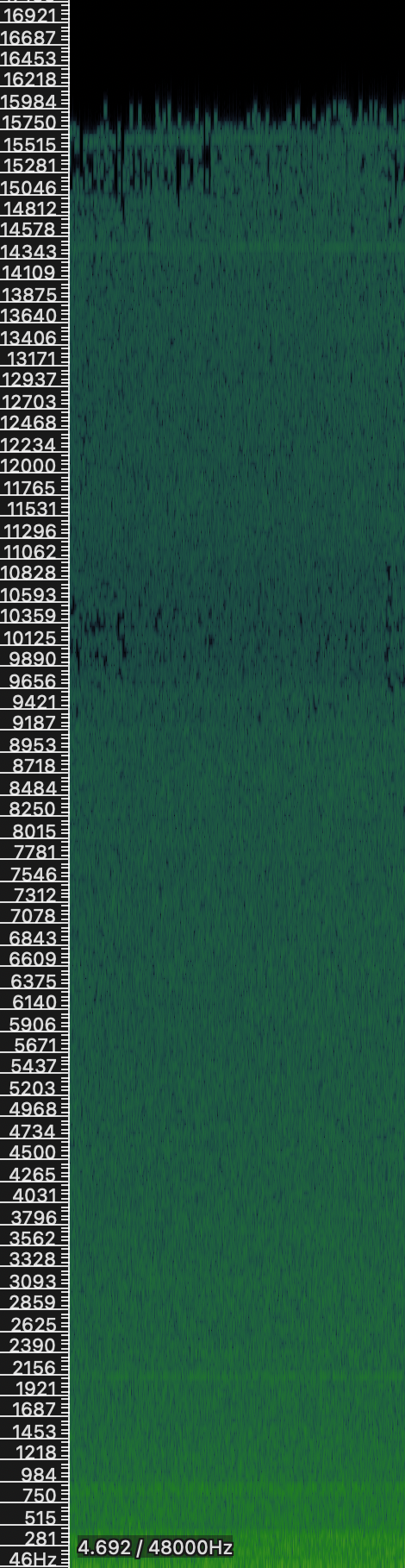

But simply for the purpose of showing the relative level of the "whine" above the background, I wish someone that had a Studio with "whine" would post a spectrum analysis taken with a mic at ear level, at a normal position seated in front of the Mac Studio, showing a "whine peak" above the background noise. Has anyone done that? If so, I don't recall. Putting a microphone 6" behind the Studio pointed at the air vents blowing across the mic is not very helpful to indicate if whine can be heard above the background of the room alone.
Left is right in-front of the fans, right is from my head level 3 feet away.
Interestingly of the 3 bands at 2, 2.3, and 2.6 kHz it seems like it might just be the one at 2 kHz mixed with the 14 kHz that are escaping.
Reactions: Jrshelby
