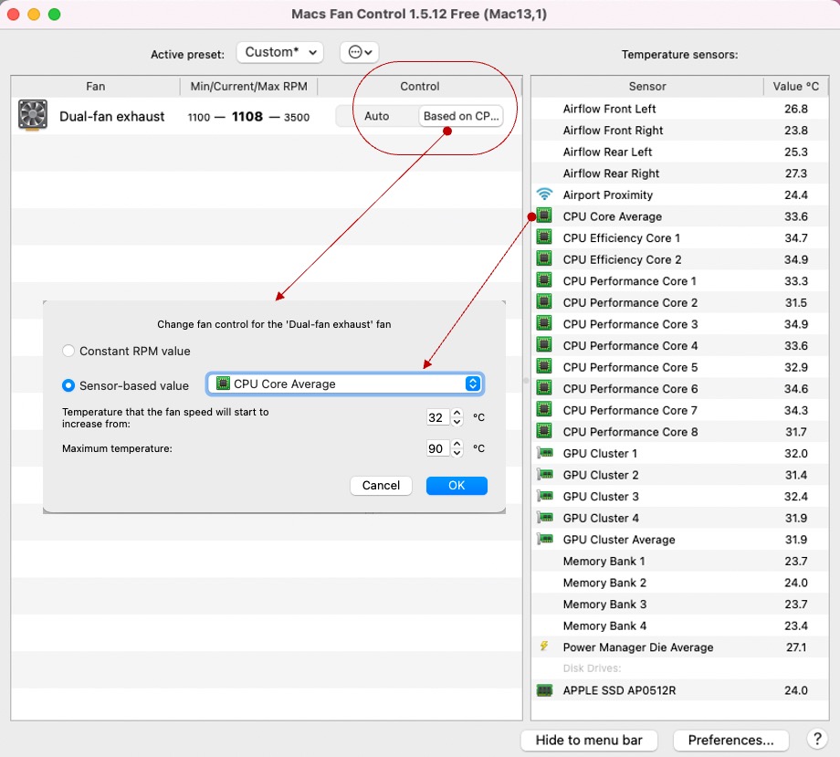

Anyway if you like to regulate yourself the fans speed on your Mac Studio "Free Macs Fan Control" is doing the job, find here attached for example what could be used to control fans speed depending of CPU Core Average temperature (any other sensor can be used, depending on what you are doing).
I use Macsfancontrol already, but I really need to get under the 1100 min to eliminate all the noise -- I think. Mine's a little different than the descriptions of other people. My whistle is at about 2640Hz, not the 2200, and I always hear the fans themselves, even at 1100. I'm thinking the heat profile can take a lower fan speed, at least I hope so.

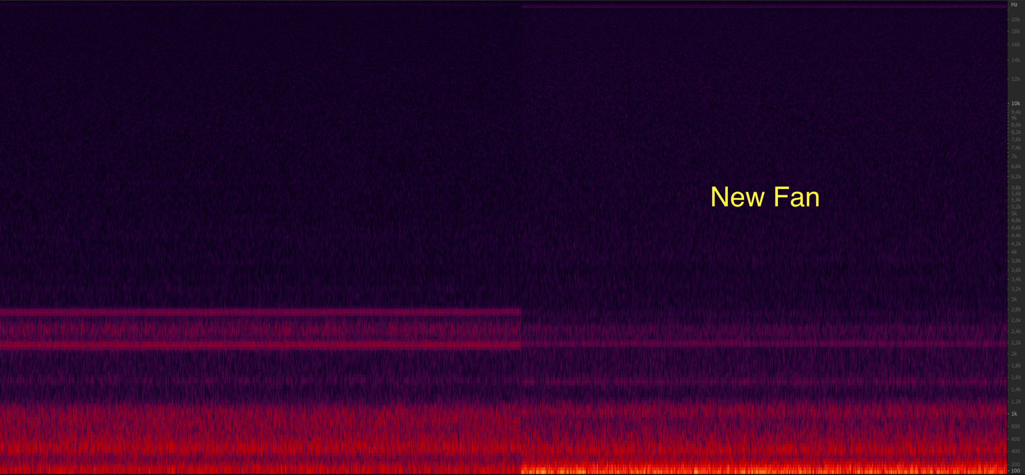

I was supposed to get a new unit, but the service did a fan replacement on the second try. The first version was almost perfectly quiet on one side. After the replacement, the dominant whistling sound is gone, but various electrical whistles are still audible when listening up close, it's not just air. I wonder what the sound will be like in a few days...
In tests with one half covered, there are more "farmonic" sounds.
