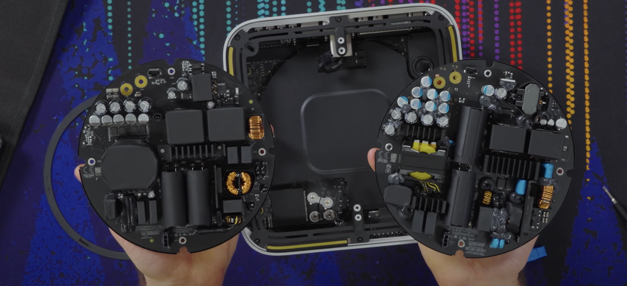

Has anyone posted about there being at least 2 completely different PSU designs? Could 1 design be responsible for the noise.
I was watching Linus Tech Tips trying to do a Mac Studio SSD swap and he had 2 mac studios and noticed 2 completely different PSU designs as shown below. the one on the left is liteon power technology and the one on the right is delta. I wonder if the people complaining about the noise all have the same psu manufacturer. Linus swapped them to see if they would work and they worked fine in both studio display units.
That's one theory OK, I think there's actually 3 different types...but who's going to open their one and void return or warranty...It doesn't look that difficult to open at all, but the cover on the screws is going to be a giveaway that you've been in there.
