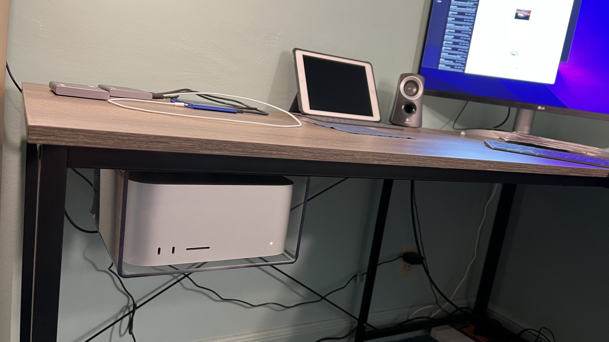

Received my new (not a refurb) base Max Studio on Dec 19th. Just reporting that besides the fan whooshing slightly if I get really close to it, I haven't noticed any whine (yet). I do have tinnitus in both ears so I guess I'm used to that kind of noise though - have learned to block it out most of the time. I have the Studio mounted under the desk with a desk mount from OWC (NewerTech I think). It's only 2 or so feet from my left ear. Pardon the wiring mess in photo - have cleaned stuff up a bit since :)
So far so good, but time will tell.
Noise and frequencies are certainly different for people (like taste is) and I have sympathy with all who have had problems with the Studio. For me it's the perfect Mac right now and I hope it doesn't start to whine. I really love it and it blows away the M1 mini I traded in.
There have been enough complaints about the Studio whine that I hesitated to get one. There apparently are a bunch of crappy units out there. Maybe Apple has silently resolved it? Will report back if it goes south and get noisy.
Hell, I bought a G4 MDD Windtunnel back in the day when they came out and spent more time and money on that trying to quiet it down than I care to admit. This one I can't work on :)
