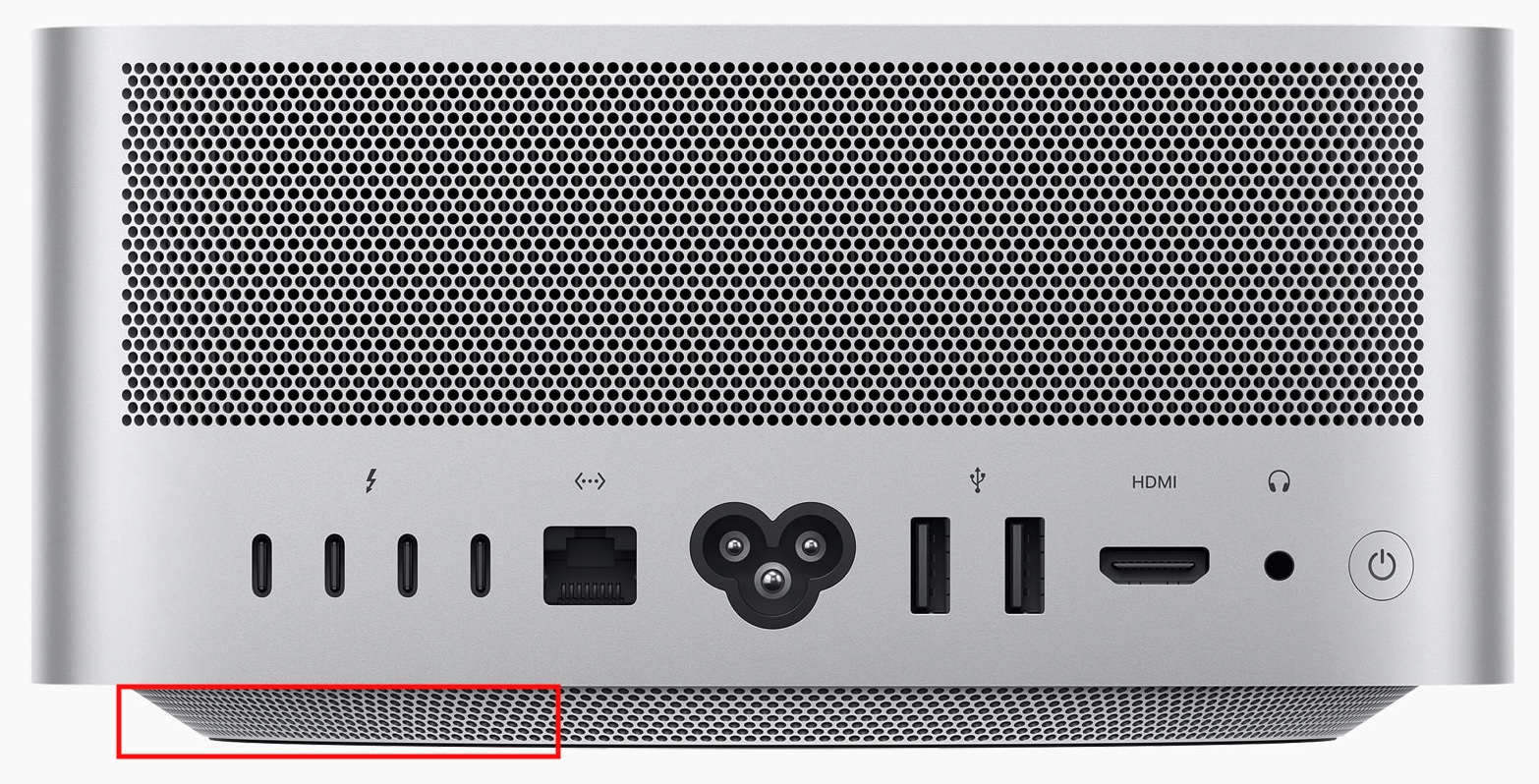

From the moment I turned my Studio on to the present when a tender whistling sound became a bit more pronounced, it's clearly been a rear vent issue. I used my hands to selectively cover different parts of the vent and that alternated the volume and character of the sound. Per advice that I read in these forums months ago, I mitigated the sound as follows:
From the perspective of facing my Mac Studio, I taped 1-inch of the curved section on the right, rear vent (left side if facing from behind). I used a lower grade of black gaffer tape which should not leave any adhesive behind when the tape is removed. Worked like a charm and now I can only hear it when listening from 12 inches away. While working from 3 feet away, I cannot hear any whistling. Just a barely audible whir of the fan.
Is this the area you're referring to ?
