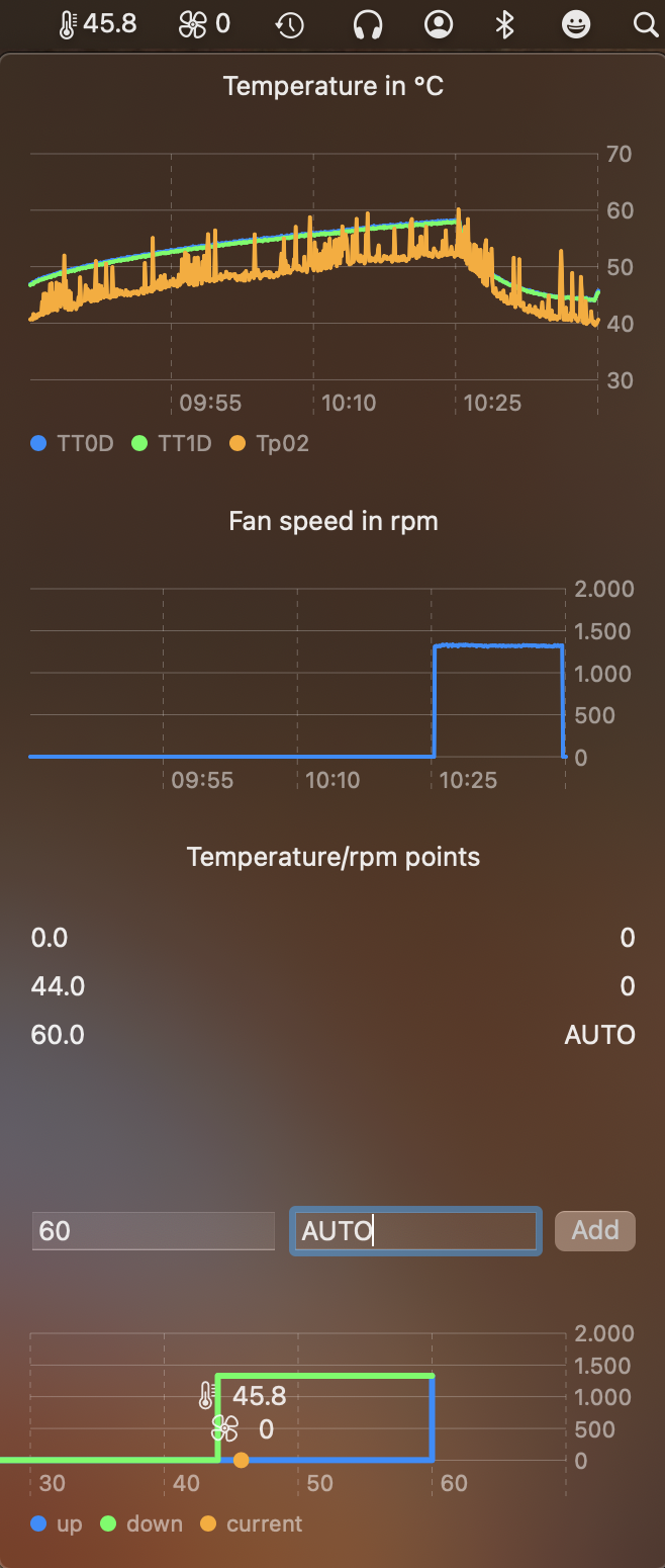

This may or may not be true. When I put my fingers over the leftmost holes when the fan is on, it reduces the rotation speed from ~1320 rpm to ~1310 rpm. This change may be enough for another resonance inside the system.
(Not really visible with this chart resolution. But you can see that the rpm value is not 100% constant.)

Nowadays I use my small script to automatically turn on the fans at 60°C and turn them off at 44°C. This is currently alternating between 10 minutes with fans on and 40 minutes with fans off. Other usage pattern will have completely different results.

I agree to the first part. That is the reason why everyone should do this on her/his own risk. I monitored all available temperature sensors and found the temperature of the Thunderbolt port rising the fastest. Therefor I check these sensors in addition to a CPU sensor per default.
Yes. I can set any rpm value, but values between 1 and ~550 rpm don't work reliably. (I have not tested the highest possible value ;-) but 3500 rpm is ok.)
