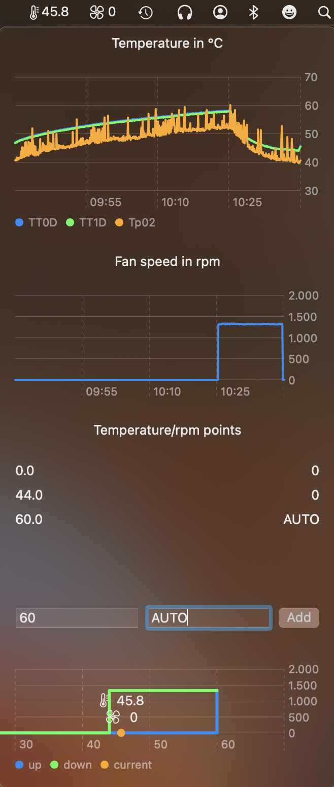

This may or may not be true. When I put my fingers over the leftmost holes when the fan is on, it reduces the rotation speed from ~1320 rpm to ~1310 rpm. This change may be enough for another resonance inside the system.
(Not really visible with this chart resolution. But you can see that the rpm value is not 100% constant.)
I am also investigating this route. If only we could open the damn thing with normal screws i would take it out of the housing for a test.
I also tried to have the fans run at different speed. Funny enough. It helps. But then the fans are adapting their speeds bit just a hair an i get even weirder noises….what a fail this machine is…noise whise i mean

I know what you mean. But yeah. Mine makes this kind of noise. After using fan control software i can make it less noisy.
I made sure that there is no other noises in the room. Here a video with fan control.

Unfortunenatly i will stay like that. When i wake it up after sleep it start action on his own by changing, ever so slightly, the fanspeed so i have on and off high pitch moments.
