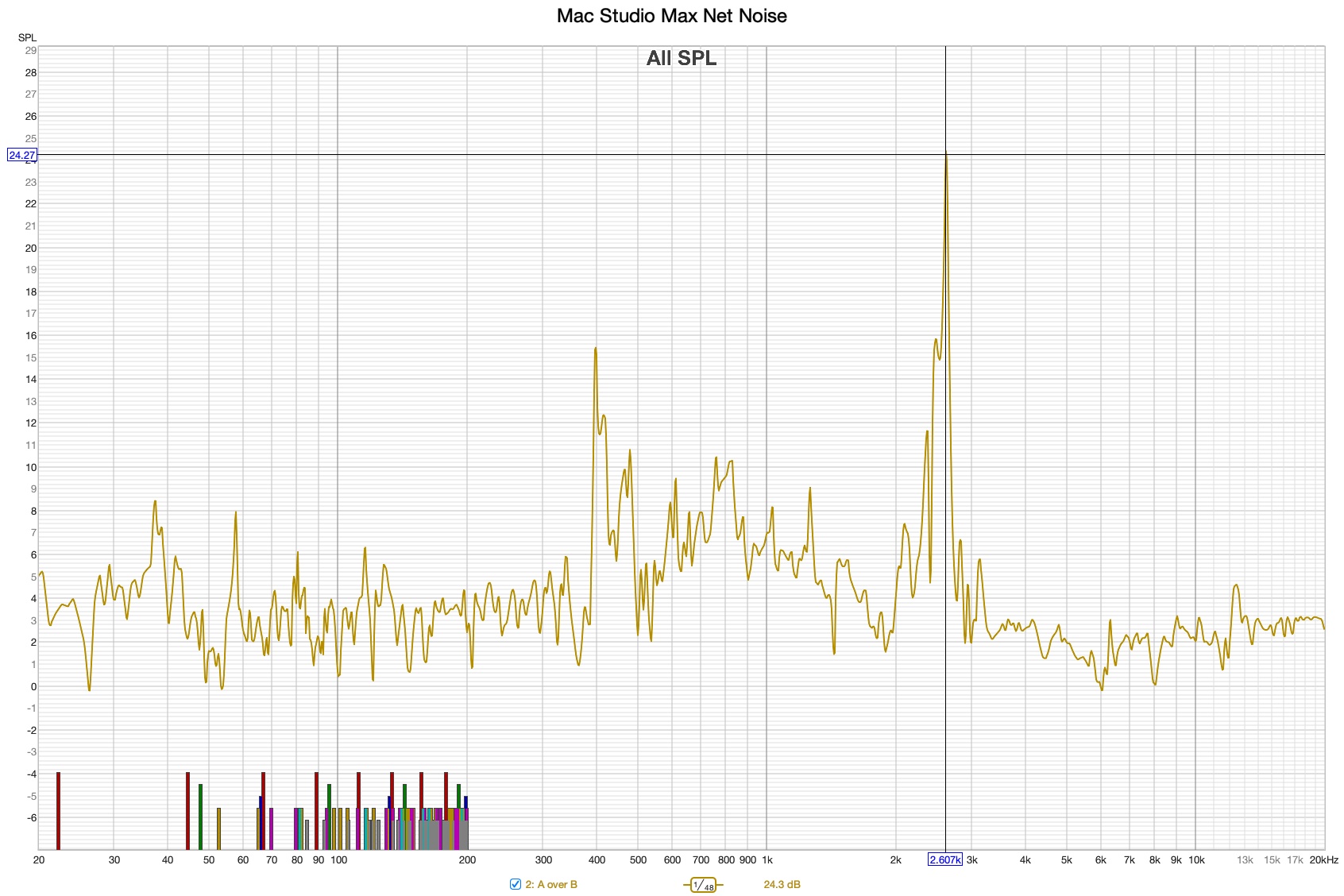

Unfortunately, after several months of use, my Studio Max, which was used in this review, has developed the high pitch noise that so many on this forum have experienced. I've taken some measurements and updated the review.
You can find the updated noise section here: https://fcracer.com/mac-studio-review-for-photography/#noise
Subsequent to the analysis I did in the link above, I’ve obtained a more sensitive microphone and have conducted further testing. Using the excellent REW (Room EQ Wizard) with a lower noise floor UMIK2 from MiniDSP, I can repeatedly show the frequency and amplitude of the noise from my Mac Studio Max.
The below graph is the net change in db over frequency with the Studio off vs. on. There is a 24db net change in sound pressure at 2.6kHz and a lower amplitude change of 15.5db at 400Hz. The 400Hz appears to be the normal ”whooshing” that we don’t mind, whereas the 2.6Khz is the irritating “whistle” or “whine” that we despise.
As mentioned before, I have two Studio Max in two different cities and both exhibit the noise, so I haven’t bothered to try for a return with Apple. I think I’ve passed the one year mark now anyways so I’ve learned to live with it.

Finally some actual measurements! And that 2.5 kHz frequency area is where we’re most sensitive. Great work.
The question remains if it’s only some of the units that will have this noise peak. As you describe it (I never had a Mac Studio my self) it could either be some electrical whining or a fan that’s poorly designed/defective.
Reactions: fcracer
I don’t know if you have been hiding under a rock, but we have had A LOT of actual measurements. Some from people with the whining issue and some from people without. Only some have the whine at 2.6kHz.
I did recordings myself, and I have a friend with a recording booth, and no where did I record the whine. A faint fan noise for sure, in the 400Hz area, but nothing else peaked In any recording, not even when the Mac Studio was under pressure - just more fan noise.

Ok… I was just surprised to still read posts like: “mine doesn’t have noise” like they’re suggesting that it’s not an issue or people are too sensitive 😊
Posts like that are not so relevant unless they have pulled their machine apart and shared pictures of part and serial numbers etc.
I think these comments are just as relevant as the ones reporting issues are. It tells us all that this is not a general issue, but rather specific to some Mac Studios.
I agree, I would love to know what sets them apart, but few people are interested in voiding warranty just to satisfy the curiosity of forum members. It has been mentioned that there are at least two PSUs in play, and perhaps that is the differentiator?
