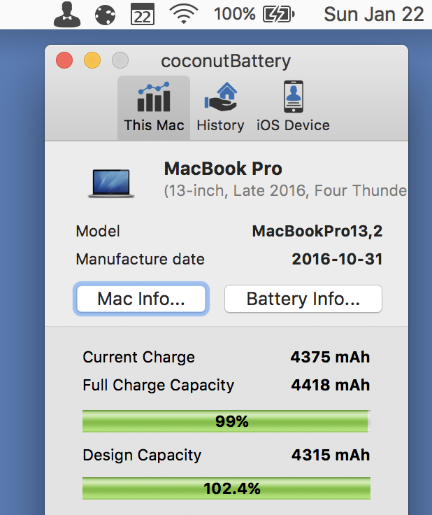

The builtin battery percentage from macOS doesn't show the same amount of juice left as for example coconutBattery, when macOS shows 100% remaining coconut shows a couple of percent lower.
That has always been like that and Coconut battery is spot on with the percentage and macOS is fudging the number and showing 100% when it is not. I suspect so people don't get worried when it shows fully charged but not 100%. If you look in System Report and the numbers and do the math, you will see Coconut battery is correct and the OS is wrong.
[doublepost=1485096928][/doublepost]
The difference you see is probably due to what the app consider to be 100%.
See my earlier comment. The app (Coconut Battery) is correct and the OS is fudging the percentage.
See my screenshot. 4375/4418 is 99% yet the OS shows 100%. That 4375/4418 is the same as shown in System Report.
