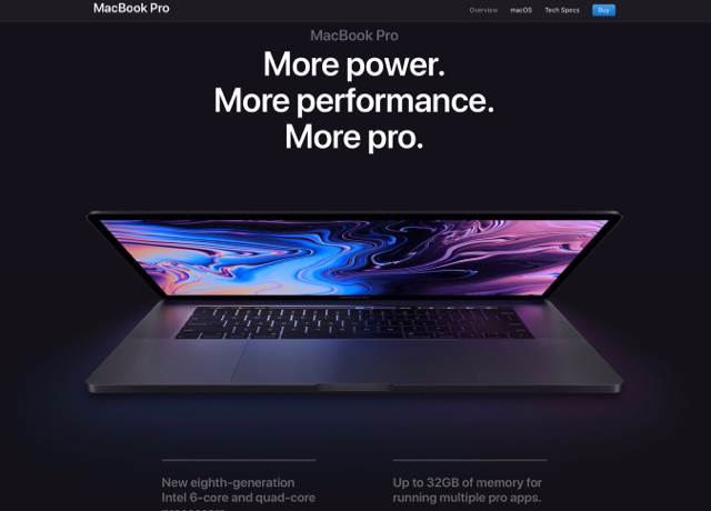

you guys are clearly using your macbook pros wrong. as you can from the first image shows on the page of the mbp on the apples webpage, you should only open it just alittle bit.
more power
more performance
more pro
and more dick? the cam pointing str8 to your groins...
oh the irony between the too tight cable and the image
more power
more performance
more pro
Lmao, thanks for the laugh. It was very good.
