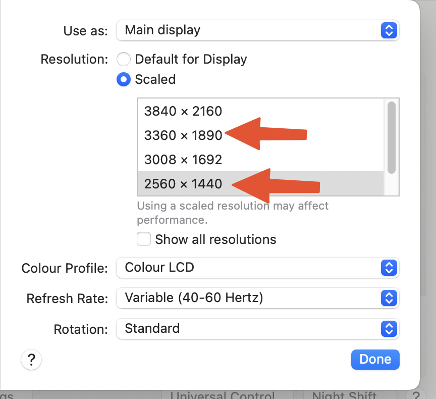

Hey, I've been dealing with this flicker issue for the last 3 months on an M1 Max Mac studio, completely puzzled at what the problem was. I noticed that it wasn't flickering on Apple apps like Safari, Finder or Final cut Pro, but it was on other apps like Blender. I tried everything, different cables, monitors, color profiles etc...
Just now, I changed the resolution scaling to match the Native resolution of the monitor and the flickering disappeared. I haven't seen anyone post this as a solution/potential problem, but hopefully this helps someone.
The only side effect is now all the text on everything is tiny, but it's less annoying than the flicker.

I think that it's been widely noted that you can have performance problems using scaled resolutions as the system has to do some work to do the conversions. I run an M1 mini with 2 4k monitors and they are at native resolution during the day and scaled resolutions outside of the business day. I have even run four monitors off the mini, 2 with DisplayLink. I did not have flickering problems with this setup after upgrading cables.
But I was running the mini with about 70% CPU idle. I think that it's possible, at much higher CPU loads, to see video issues. I have had these kinds of problems on older Macs, particularly with integrated video and high memory bandwidth workloads.
I have not had these kinds of problems on Macs with discrete GPUs. I have a 2014 iMac 27 and that handles 5k scaling with no issues at all, regardless of how busy the CPU is.
My solution is to partition my workload on multiple systems so that I don't use a lot of resources on any single system.

It was doing something similar for me, certain things loaded on the screen would kick off and switching what was on the display would stop it then start again. I concluded that something was flipping the BENQ out in the display signal, with darker windows seemingly creating the problem. I could even stop it by sometimes just moving a window to another part of the screen!
For what it is worth I changed nothing but switched monitors as my BENQ had another issue so I returned for a refund. Been running my EIZO trouble free with a small issue that sometimes when waking from sleep it forgets the monitor settings and resolution/refresh rate can't be set properly. I have to turn the monitor off, leave for 30s or so and turn back on then its fine
Just out of interest I recorded my screen using Quicktime, and upon playback it was rock solid – no evidence of flickering whatsoever.. So this might suggest that the GPUs are working properly and that the issue is caused by something further downstream. Because HDMI works better (although not perfectly), I'm wondering if it has something to do with the Thunderbolt controller itself.

So I made an interesting discovery today. It seems to be caused by certain websites. If I open a certain website in Safari, the entire scene starts flickering:
https://www.theguardian.com/.../revealed-the-30bn-cost-of...
If I then open another tab in the same Safari window and load a different website the screen flickering stops:
https://www.bbc.co.uk/news/election/2022/us/results
Clicking on the original Tab causes the screen to start flickering again. They can literally be two different Tabs in the same Safari window, and switching between them will start/stop the flickering. The flickering extends to the entire screen including the desktop - not just the content within the Safari window.
It occurs to me that YouTube, Disney Plus and Amazon Prime Video all rely on Safari. Doesn't explain AppleTV though...
If I create a screen recording using QuickTime Player, the screen recording is rock solid upon playback with no flickering whatsoever.
What do you all make of that?
Yep, I’ve noticed that when certain DARK things are on the screen, it’ll happen. It might be things that are near black, but not quite completely black. I used to run YouTube with the dark theme, but I started seeing certain videos would start the screen flickering. Switched to light mode and no problem.
So my theory is that certain values of gray, and what percentage of the screen they occupy, is what triggers it. Maybe the signal coming down the cable is slightly out of spec when this combination of factors occurs and it makes monitors freak out.
When flickering, there is a subtle pinstripe pattern on the screen. It appears as thought there are alternating rows of image and black stripes. as though the odd numbered columns are image and the even numbered columns are black. Then in the next 'frame' all of the rows are image. This 50% black content switching back and forth is what our eyes perceive as flickering.
