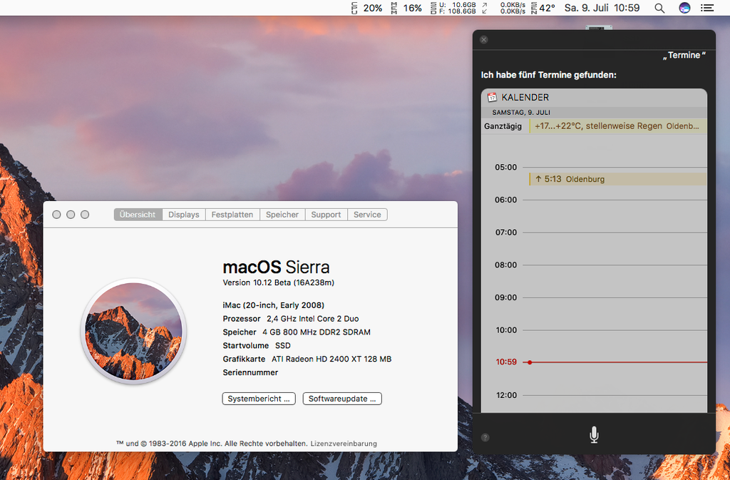

new patcher works perfekt with MacOS Sierra public beta ! many thanks to all for the hard work :)
