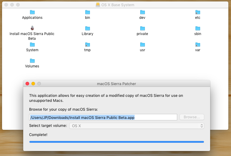

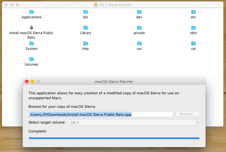

Something is wrong if it's only taking like 3 minutes to patch. It should take much longer. Is it prompting you to enter your password? If it is, it should restore the Base System image and create a volume named OS X Base System. If that volume doesn't mount, the patching will fail.
I've tried reinstalling using the same usb, a different usb and they have the same result - the installer gets to about 11 mins remaining then reboots instantly to a black screen which loads the forbidden screen.
Time to restore from a back up....

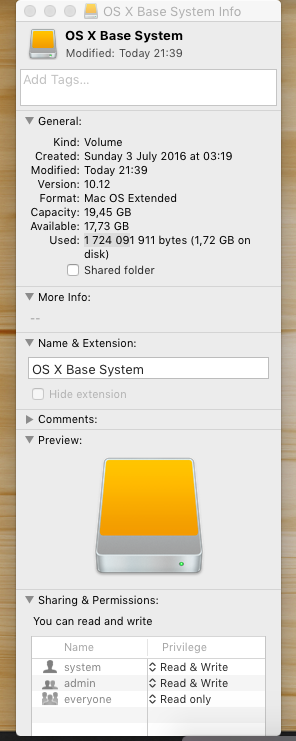

yes, thats what its concerning me...again patched in 3 min....it asks me the password, creates the volume OSX Base System and it mounts ...I just tried again with the updated patch and the new download of Sierra of the link that you provide me and it's exactly the same situation, Prohibited sign on booting the OSX Base System...despite of unmount everything before I boot...dunno what to do anymore :(

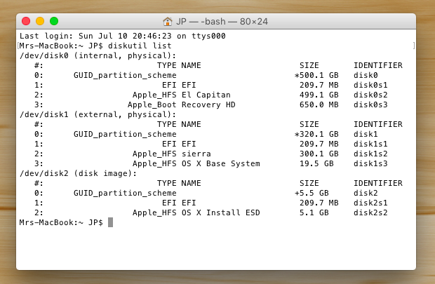

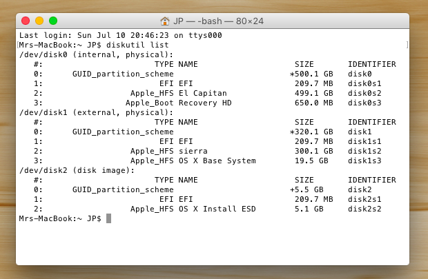

Ok, can you run the patch again, and when it completes, open Terminal and type "diskutil list". Send me a screenshot of the output.
Again asks password, patches in less than 3m and mounts...here u have it, m8

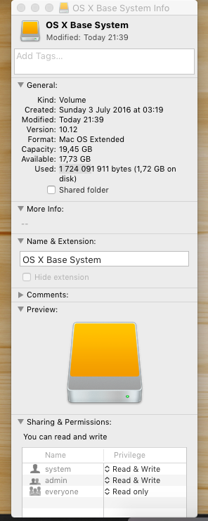

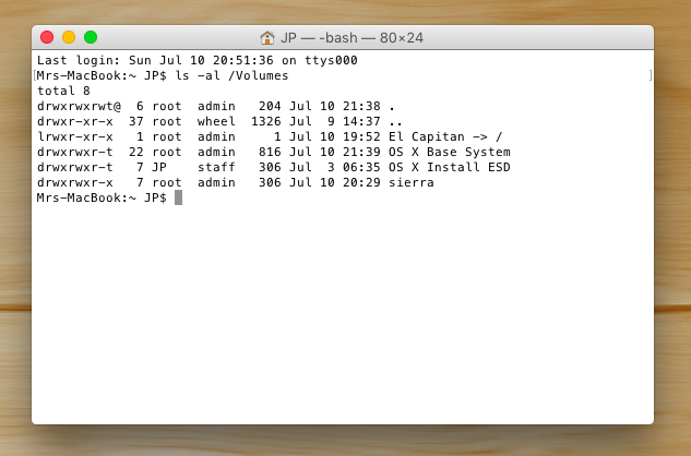

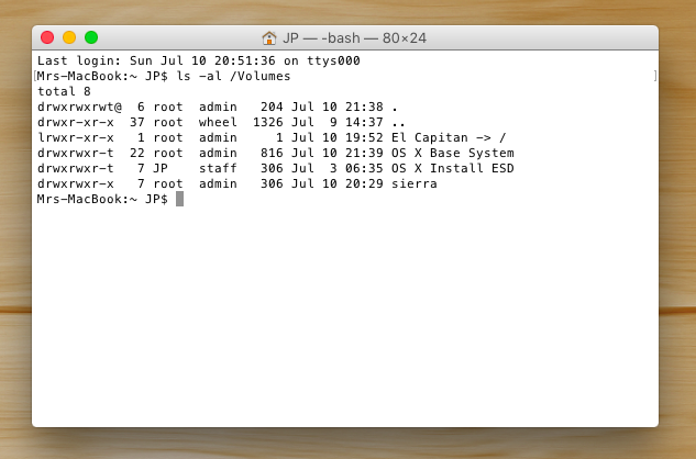

Huh, the drive is there... That's really weird. Can you try doing it one more time, but this time send me the output of "ls -al /Volumes"?
[doublepost=1468175765][/doublepost]
You should be able to just update, and re-run the post-install patch.
same thing, patches in less than 3m
