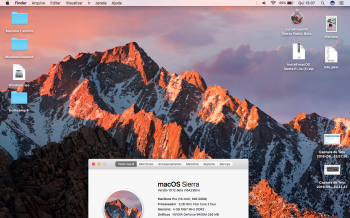

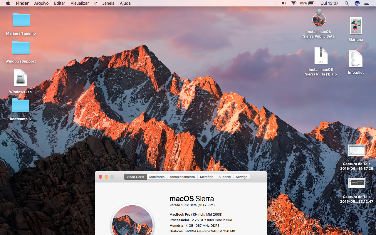

I installed MacOS BP and everything went perfectly. All functions working 100%. I have not formatted the partition, upgraded over the MacOS DP.
