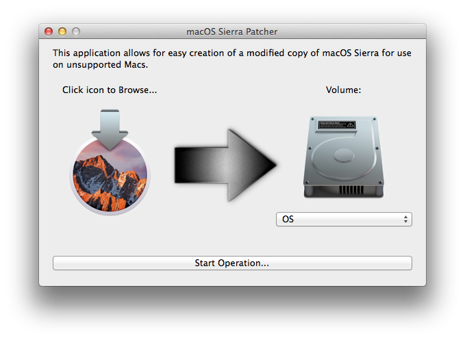

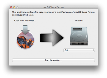

I've just done a bit of an overhaul to the user interface of the macOS Sierra Patcher, I think it looks a whole lot better. Also, I'm in the process of creating an easy-to-use software update patch, to allow users to update to newer Sierra releases on unsupported machines without issue.
Thanks, dosdude!
I can't wait for the new version!
Wow - that looks FANtastic!
Thanks so much for ALL you have done to help us out!
