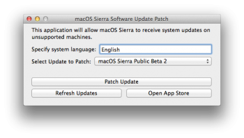

Alright, I've just finished the first version of the automated software update patch. It's very primitive at this time, but expect improvements very soon. I tested it on a couple machines and it seemed to work just fine on both of them (the update showed up, haven't tested installing it). Download here: http://dosdude1.com/sierra/macOS Sierra Software Update Patch.zip Please also note that only Public Beta builds will be supported by this.

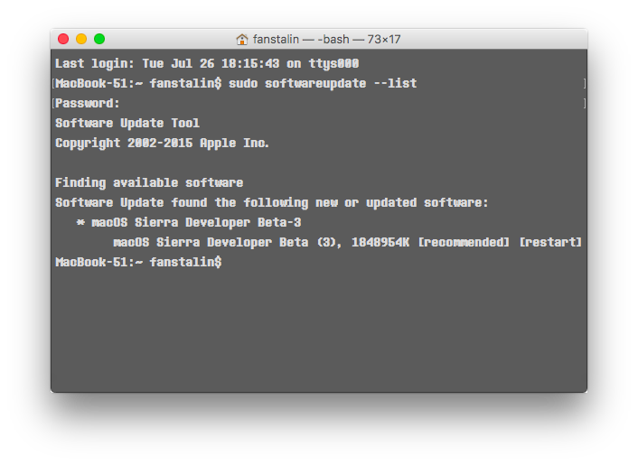

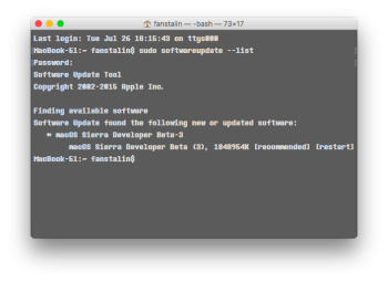

I did this and I was able to jump from DP1 to DP3 on my MacBook 5,1! Whoohoo! I'll be making a video tutorial soon for dudes who want more of a visual guide, and a way to just make fun of myself.Screen Shot 2016-07-26 at 6.38.14 PM.png

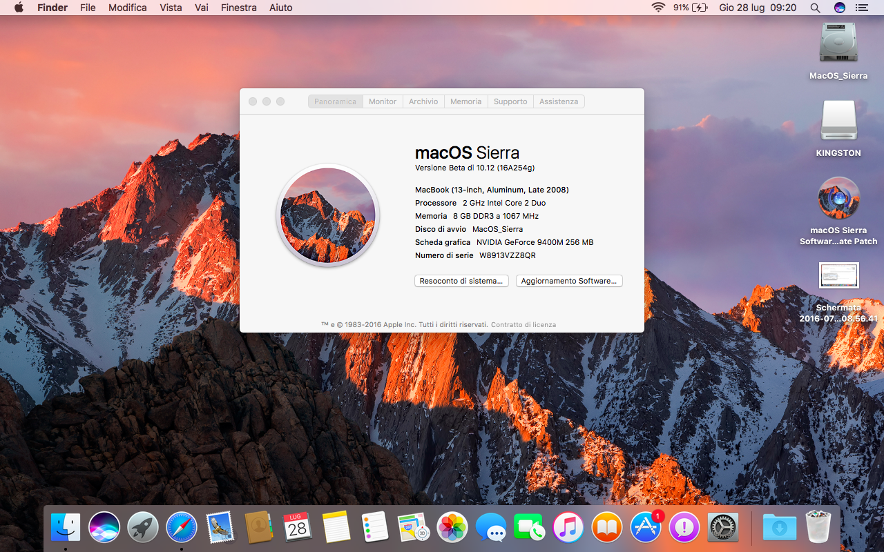

Works with my MacBook 5.1 late 2008 macOS Sierra PB1
Thanks

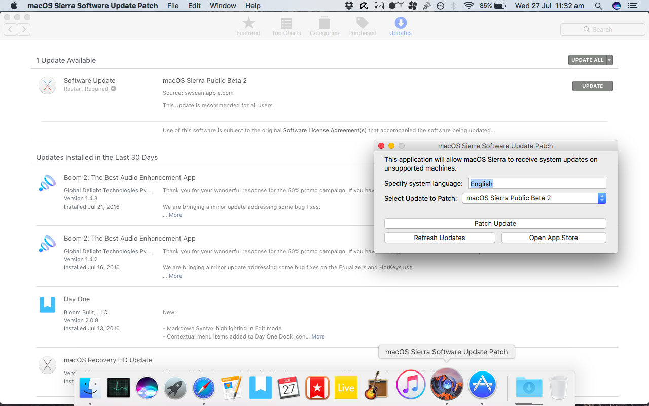

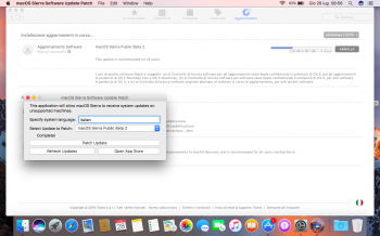

Amazing! This has been the only thing thats worked here,
Ran it, patched it, refreshed it, downloading it!
Thankyou!!!

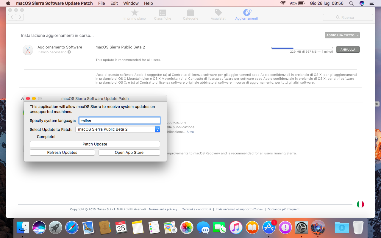

After my upgrade to PB2, it no longer (correctly) shows up as a viable option. I get the latest recommended updates for my system. Then again I hard coded my board id and system name instead of bypassing the check. Dunno if that matters.

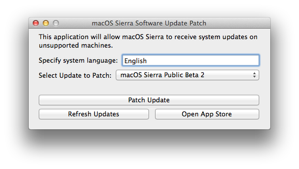

The latest version of my patch does patch the recovery partition (if selected in the post-install patch). All it does at this point is make it bootable, in the future I'll add the post-install patch as an option in the Recovery Menu.
Great ! Really appreciate your hard work. Btw, did u get the dp3 info you requested?
I haven't yet. I just need the .dist file and the full directory path to it.
After changing my catalog url to seed...I believe it's here :
/private/var/folders/zz/zyxvpxvq6csfxvn_n00000s0000068/C/softwareupdated/com.apple.SoftwareUpdate.SUCatalogDataManager/k/031-68147
File attached (changed extension of course)
Same build number as PB2.

It also now shows a new version of iTunes in app store updates - does anyone know if it is actually safe to install that?
thanks for that info; I was running on DP1 and had not been able to update using the various techniques described; but with the directory location .../k/ I did find that one on the computer, edited the dist file per post #1526 and DP3 then showed up as an available update! It downloaded and installed and seems to be working. It even now supports wifi on my macbook pro 5,1 model.
So thanks again.
The iTunes update works for me. Keep in mind that this is all still beta. Hardening with every update as we get closer to September. Make sure you keep good backups.
What did you change on the recovery partition? prelinkedkernel to support usb and PlatformSupport.plist to contains the removed machines boardid/modelid?
