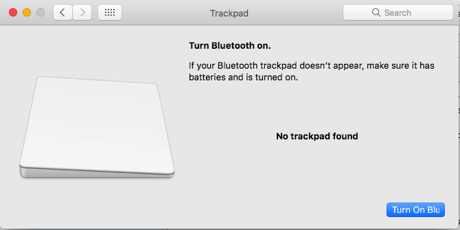

Installed in MB 5,2 mid 2009. Everything works fine, except for the trackpad, the button works and I can move the pointer just fine, but the clicking on the trackpad itself does not work anymore. The preference panel only shows a option for a bluetooth trackpad. Any way to fix this?

Here's the deal. I have OS Sierra pb7 n I need the Win1064 bootcamp files and I also need a recovery for macOS to fix whatever is causing my I/O device failures. Windows does fine, but once mac boots up it won't use the track pad, keyboard, USB or BT, Everything else is fine. It randomally quit working though after going from Win to Mac. So if anyone knows what the issue is that'd be great. But I wiped the Recovery partition on accident and now only have the Win n macOS partitions
Re-run the Post Install patch. If that doesn't work, try it again, and select "Force Cache Rebuild" before rebooting.
I'm having similar issues. Except I've been on PB7 for a while. I have the two tools but no sierra install. I need to make a bootable version of your post install it seems. Also I have no recovery partition. I need to remake that. Please help. I am not a fan of being stuck on Windows
Use a different install of OS X to re-create a patched USB drive, boot of that, and just re-install. That'll be the easiest solution.
