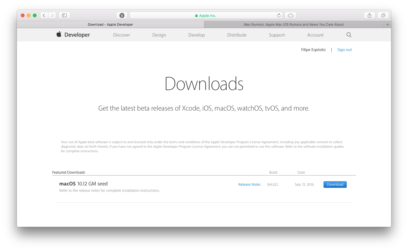

There is a new Sierra GM Build released today (16A322 vs 16A319).
