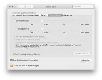

WTF? I am getting this glitch while opening energy saver. High Sierra 10.13
I might've found the fix/workaround...
Go to Energy Saver and uncheck "Automatic graphics switching"
Bingo! Genius!
Automatic Graphic Switching (for those having a dGPU) strikes again, and again!
Kudos to you, Dan. Thanks! I could not stand that pink hue on every dropped menu.

I have seen a strange behavior since upgrading to HS. Anytime I use a menu across any application, after clicking my choice the menu fades in a red hue.
Has anyone else seen this?
I see it too, only when reduce transparency is enabled in system prefs. It's also in Logic Pro X in every drop down menu, but is not affected by disabling reduce transparency. Hopefully it gets fixed soon.
Turn off "Automatic Graphics Switching" under "System Preferences" > "Energy Saver".
That makes the pink hue on dropped menus disappear. [I have reduced transparency set.]
[Kudos to daneharnett]

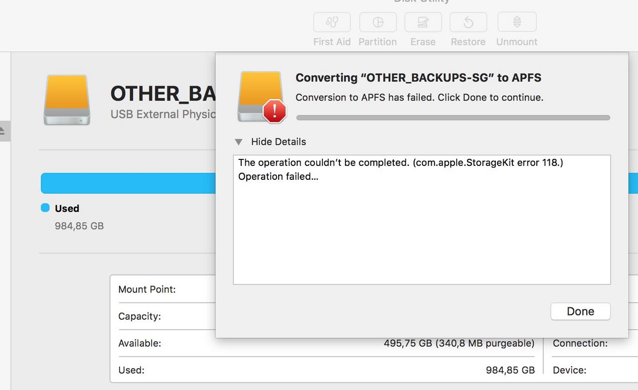

I have an external hard drive with 2 partitions, in hfs+ format.
The one of the two partitions, do not appear in Disk utility. Why?
The other one appears as usual.
I go to disk utility to convert this partition to the new file system, and this is the error I get:
Why the one partition disappeared?
Why the conversion of the other one fail?

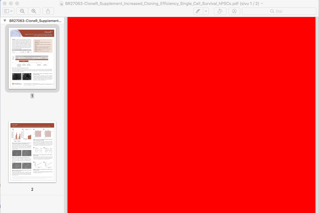

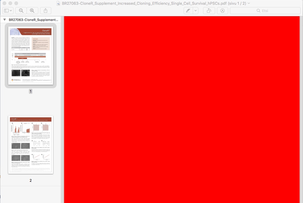

Is there anyone who has problem with preview? If you open PDF-file in preview and scroll down, first page changed red?
I have unsupported Mac Pro with ATI GPU. But is there same problem also supported Macs also?
