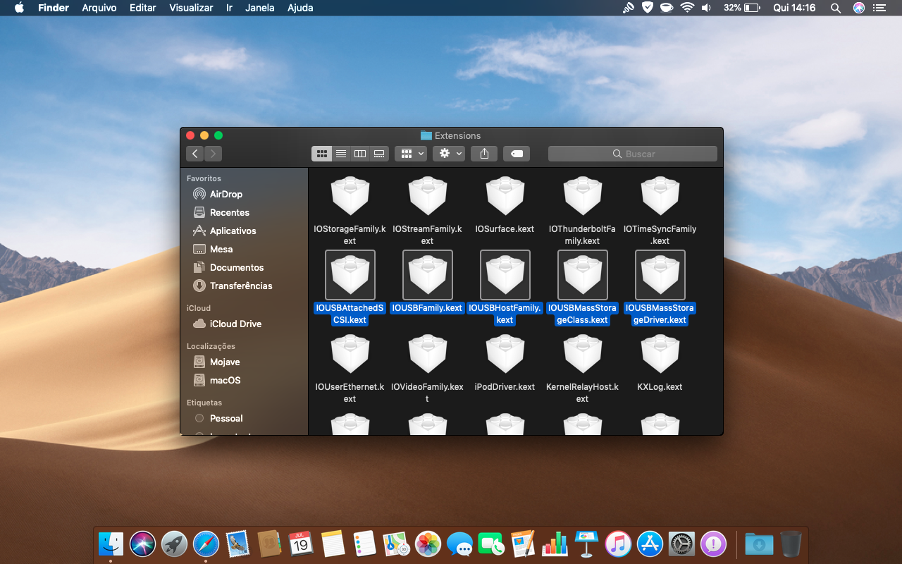

I did get my iSight camera working on my iMac 8,1 and 9,1 using the kextutility and the five iousb kexts post 3327 its best to do the family kexts first and do them one at a time until the utility says have a good day(night) then proceed to the next one I took the kexts from my dosdude1's High Sierra patcher usb after I installed all 5 with the kext utility I rebooted then did the post install patches forced cache rebuild with the macOS Mojave patcher and the iSight works in Photo Booth as well
Hurray! Fantastic! which kexts from HS patcher?

those 5 kexts highlighted in blue if you use kextutility it will do a few things first like repair permissions etc just let it finish then do the first family kext. Thank you webg3
