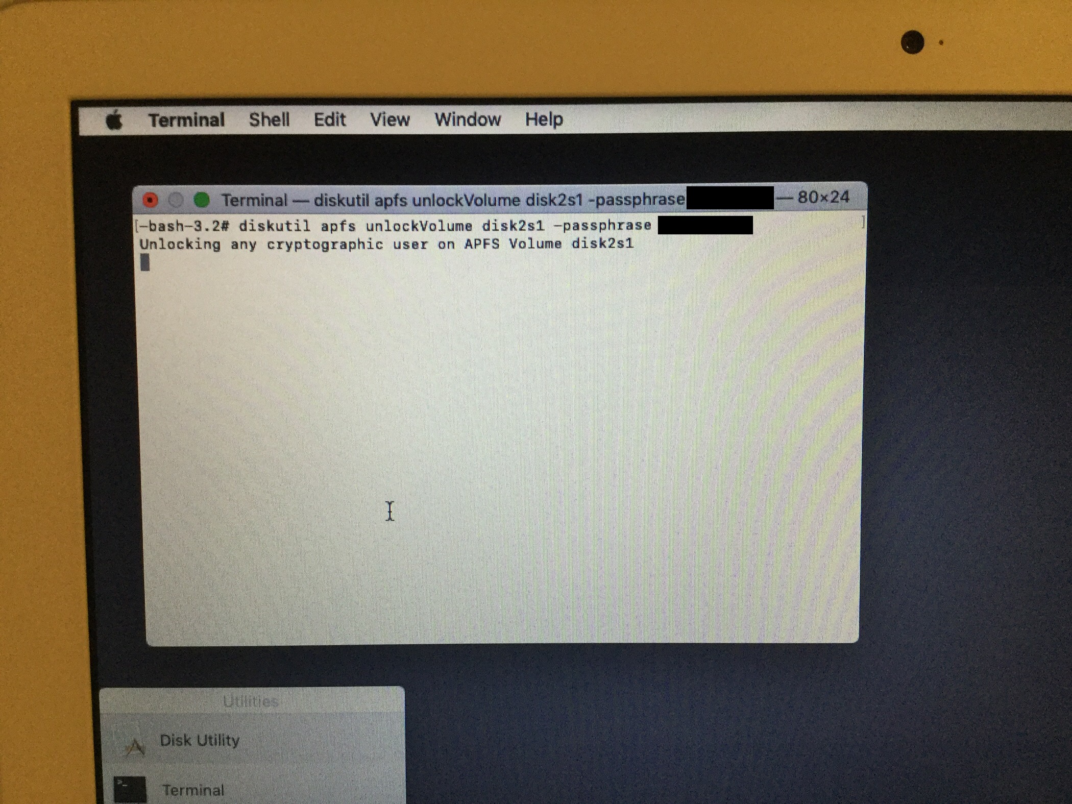

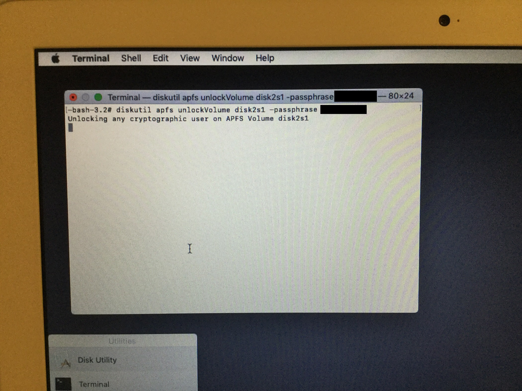

[doublepost=1533025644][/doublepost] 1FAAD6CA-9522-4A78-94A2-FFE8A5F1CE32.jpeg
It seems to be taking a long time unlocking my encrypted APFS to install Mojave on. Is this normal?
Reactions: TimothyR734

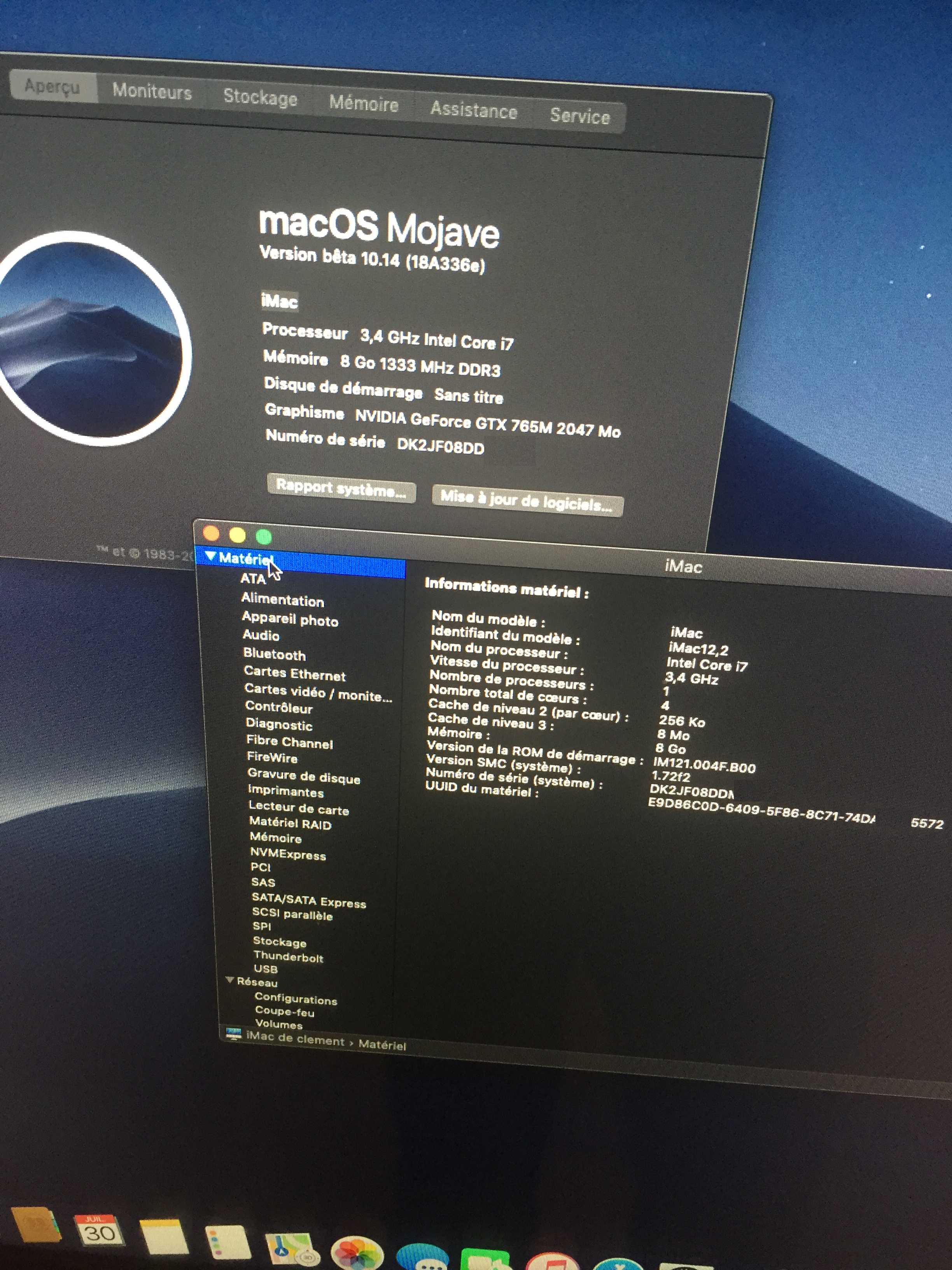

In my mid-2011 27" iMac, I've just change the GC (faulty 6970M 2GB repaired at least 2 times) to a Nvidia GeForce GTX 765M. I've also changed the Airport Card to avoid issues with Mojave and enable missing functionalities such as Continuity, Airdrop... It cost me 110€ for the Nvidia card and 40€ for the Airport+adapter.
Some mods on the dissipator has to be done to make the new GC fit and it's quite plug and play for the Airport card.
I've installed yesterday the b4 on a USB disk just for testing and used the Mojave patcher with my iMac version. I've just unticked the Graphic and Wifi patch.
It works like a charm :)

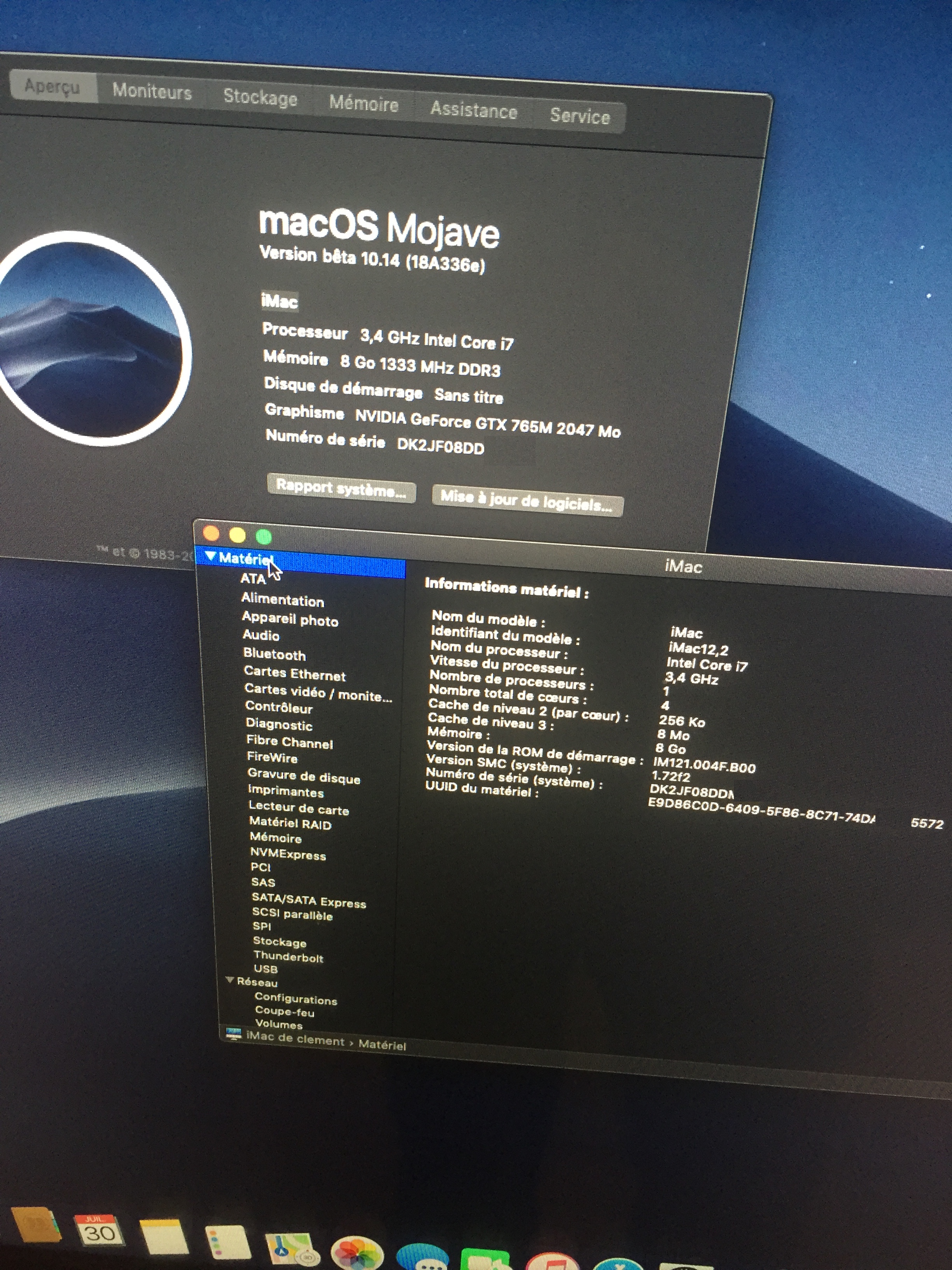

One question though: did you use a third party graphic card? Like Dell, Asus, etc... ? Or an original Apple one?
Do you retain all the functionalities like multiple monitors out, brightness controls, etc... ?

Even if here officially do not treat your machine topic, I guess the only way is formatting the APFS container in HFS+, then reinstall from scratch.
