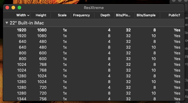

did that as well, a note; if you (my experience) go into Night Shift it WILL turn your screen orange, I tried & had to use ResXtreme to get back to "normal".

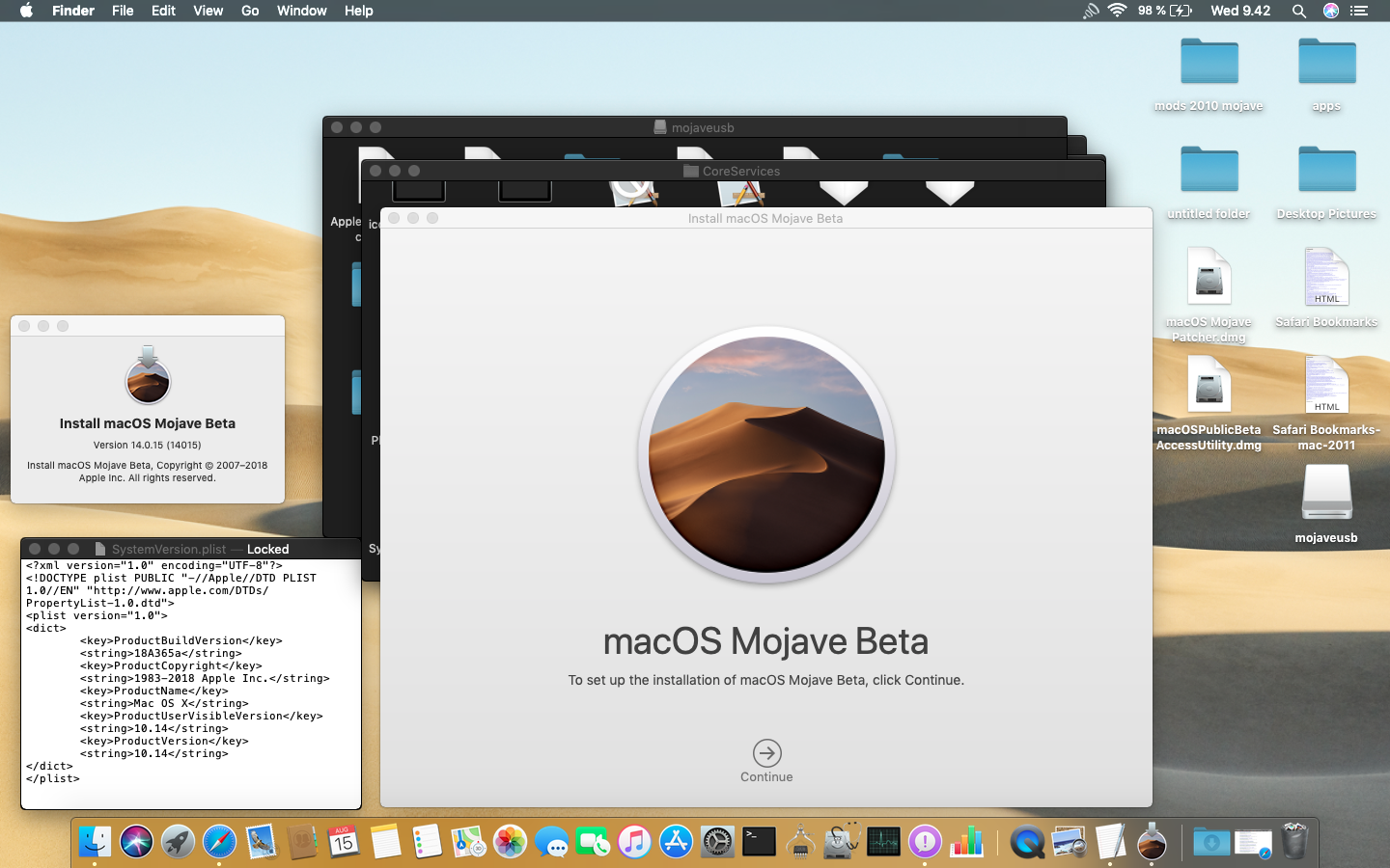

I've verified all installers versions for DP 1-6/PB 1-5. Now, does anyone have the official installer version for DP 7/PB 6/
I forgot I still have the usb installer with dp7. Maybe its wrong, but take a look at the screenshot.

Thanks for the suggestion of using Res Xtreme, @saudor. I've just downloaded it, and as you can see from the screenshot below, it lists two profiles for each resolution - one at 4 bit depth, one at 8. I double clicked the 4 bit depth setting, and my display went back to normal! It remains to be seen if this will stick after a reboot, but I reboot so infrequently that I'm happy to just keep the app hanging around in case I need to reset the setting. Thanks so much!
@timthomason - give Res Xtreme a try, it sounds like we've got the same problem. Literally, just download it from this URL, run the app, and double click on the line for whichever resolution you are using and which lists the Depth as 4.
http://resxtreme.com
thxs ill give to a try
Reactions: TimothyR734
that fixed the problem.. thxs

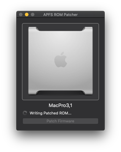

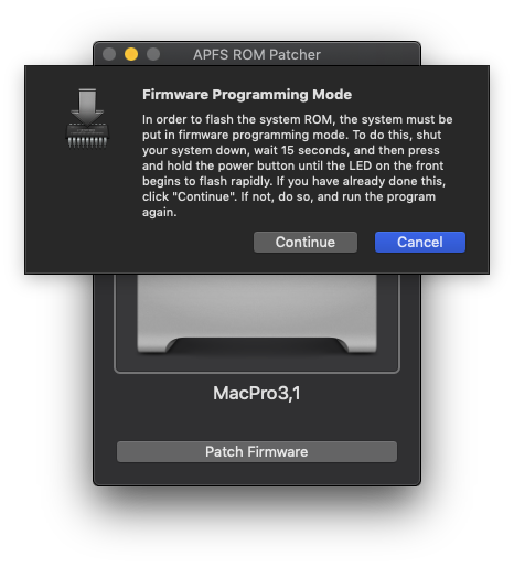

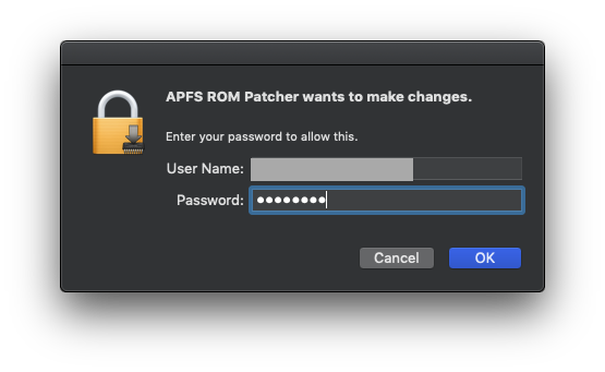

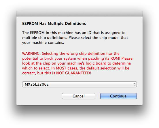

Alright, I've finally finished it... APFS ROM Patcher is finally done! Some precautions:
- APFS ROM Patcher is to be used AT YOUR OWN RISK! There is always the possibility that your machine could become bricked as a result.
- DO NOT apply APFS ROM Patcher if your machine already can boot from APFS volumes
- If you get the following dialog, it is HIGHLY RECOMMENDED that you open your machine, remove your logic board if necessary, and verify the exact EEPROM type your machine has. Selecting the wrong EEPROM model will MOST LIKELY result in a bricked system!
Download here. Please be sure to post results!

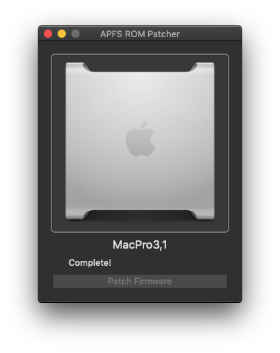

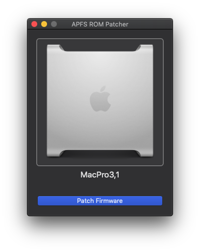

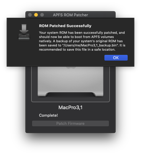

So here goes a blow by blow account of how this worked (for me)
READ THIS PANEL! After doing so I heard a long Beep! Then your machine will boot up normally...
Success!

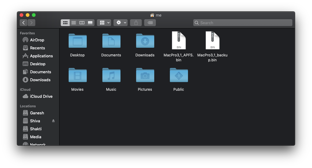

Your backed up roms are here...
Profit!
View attachment 776079 View attachment 776080
Success!
View attachment 776082 View attachment 776083
Profit!
I haven't installed APFS yet. Will do so tonight...

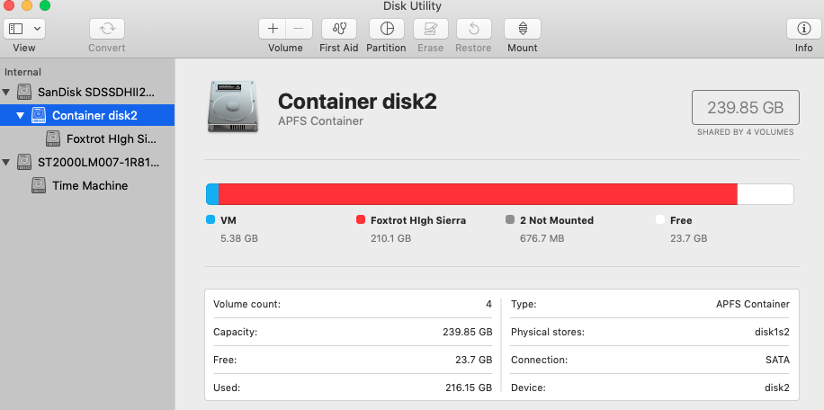

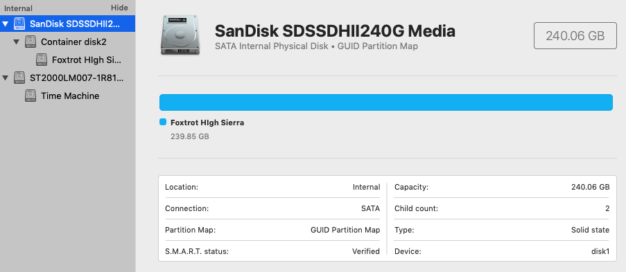

5,3 MacBook Pro 15 inch here. When I check disk utility it says I have my main SSD as a APFS format. Does this mean I don't need the Rom Patcher? I ask because I've never seen the drive performance gains that APFS was suppose to bring. When I move files from the download folder it takes just as long as ever.
I have a hard drive installed in the CD drive bay that is not APFS.
You must have applied the patch previously, or you're using the APFS boot script from High Sierra Patcher (you'll know if you see scrolling text at boot before the Apple logo screen).
