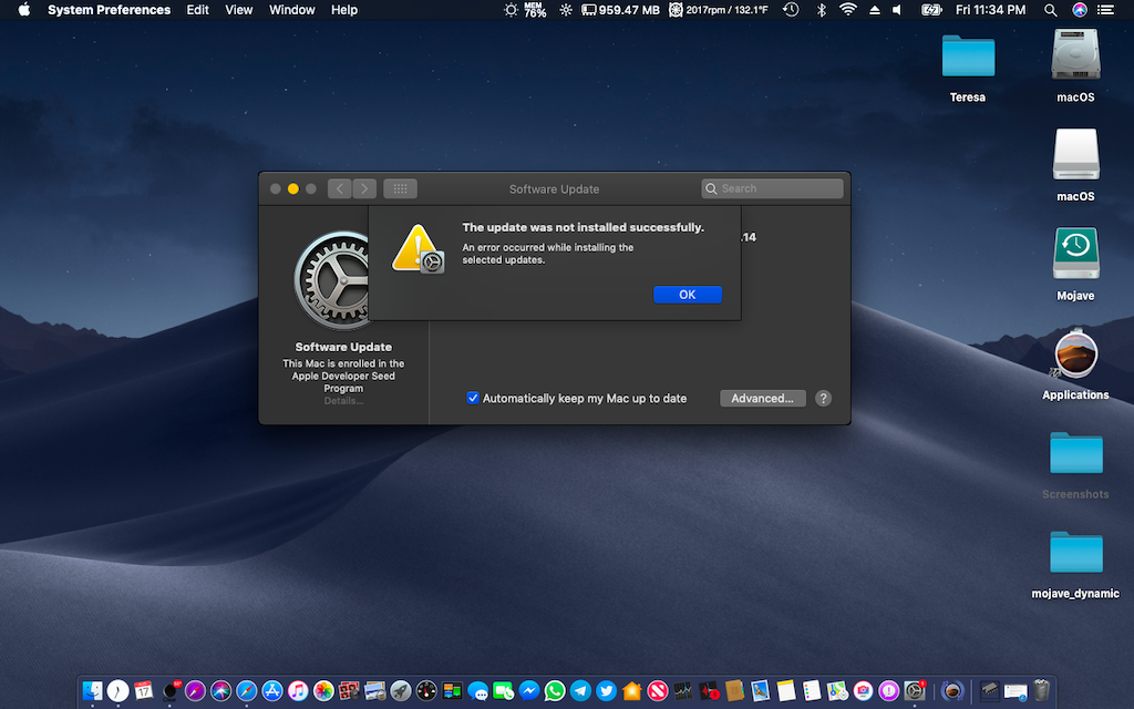

So, I got the error code 0 while trying to install DP7 over the broken software updated OS. I thought this was due to the OS, but once I erased and reformatted it back to HFS+, I realized that it was the patcher stick, not the OS. Probably should have checked that before erasing. Booted into El Capitan, rewrote DP7 to the patcher stick, install went fine. I recommend to stay on HFS+ until GM due to the bugginess of APFS. I don't understand why the native updater broke the OS two times, I'm guessing it has to do with the APFS on unsupported machines, but it seemed to be successful for others so I have no clue. Not going to risk converting and updating again until GM. It could work for others, so if you are a risk-taker you can attempt.
Reactions: TimothyR734

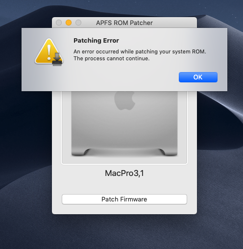

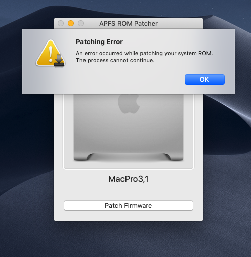

What with the encouragement gained from the last couple of posts I decided to take the plunge and try the flash.
But typical for me not so lucky, this is all I get after several attempts of closely following the instructions,
Power on, hold start button-flashing light, loud sound followed by the startup chime etc.
fortunately it does not appear to have bricked my 3,1
Ouch! Many of us 3.1 owners haven't had a problem flashing the rom as ROM PATCHER recognizes the chip immediately.
Is your machine tricked out in any way?
What is the exact model?
Was your rom already flashed? If it was, there may be an issue with the patcher. Only the "man" can help you there...
What does "not" bricked mean: did you reboot and try multiple times?
You're trying to patch your FWHub flash memory from Mojave? Try from a totally vanilla ElCap install.
Check if your FWHub flash memory is ST M50FW016. It's the 40pin TSOP between BT module and AirPort Extreme.
I think what he means there was an error while patching kind like mine when it could find eeprom on my MacBook 5,2 I think its a safety feature as you can't proceed any further with the patching
[doublepost=1534574272][/doublepost]I have been trying to install this for 3 days on my MacBook 5,2 Mojave DP7 HFS this might be further evidence APFS will be required. It installed just fine on my iMac 9,1 APFS Mojave DP7
I've never bricked, so I'm not familiar with the error you get or "how" it bricks.
But I think @jbarley had already patched his ROM on HS: I'm not sure how @dosdude1 's patcher deals with that. It attempts to recognize your ROM - if it doesn't -> pulls up some suggestions...we need a better blow by blow from @jbarley to help.
EDIT: maybe he didn't even need to patch his rom?

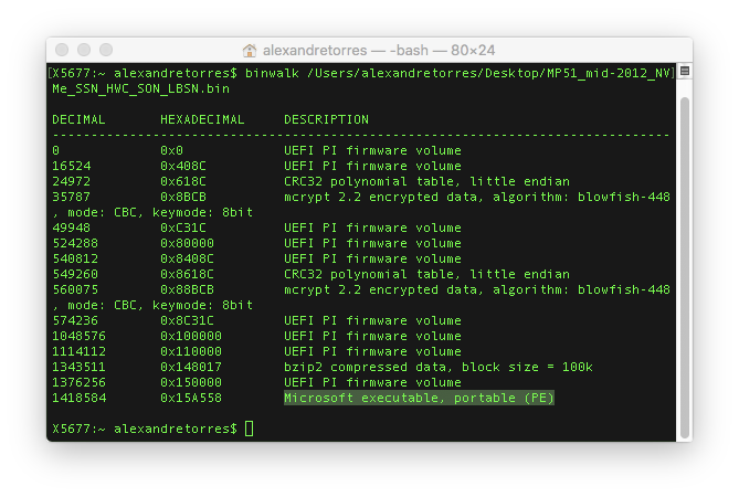

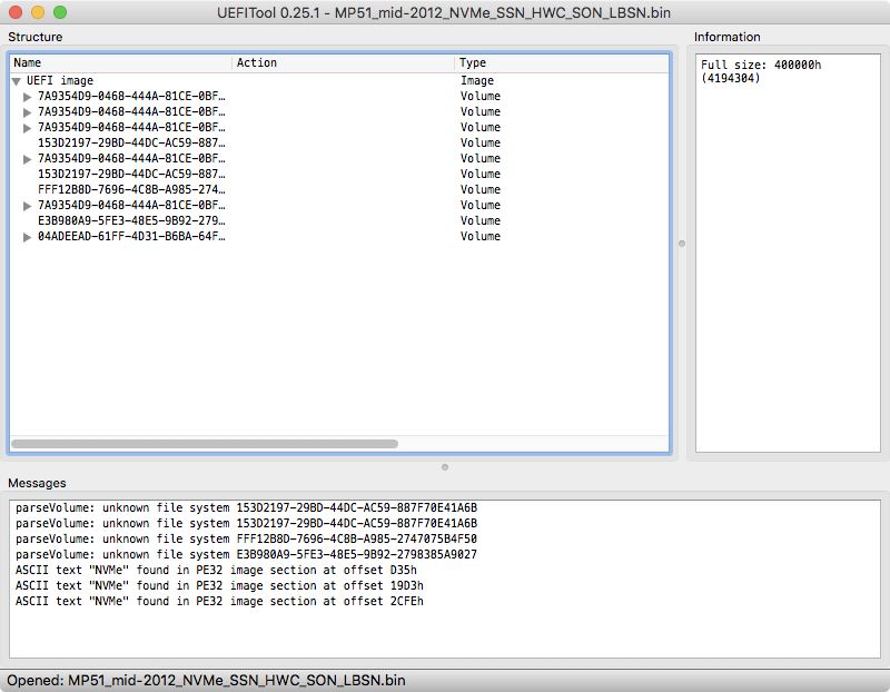

He can check with binwalk (for "Microsoft executable, portable (PE)" at the end of the report) or UEFITool (search for NVMe with UNICODE disabled). Edit: I did a error on the UEFITool part, I showed how to check for NVMe. I have to check what is searchable string or the GUID for APFS.
Something like that:
Reactions: jackluke
If you brick your Mac by choosing the wrong eeprom model number your Mac is unusable unless you pull out the eeprom chip and use a programmer to reprogram your model number back in
Correct that to: reprogram your BootROM back in
[doublepost=1534575022][/doublepost]
Why? If he/she has a stock pro 3.1 APFS patched for HS already. I don't get what you mean?
I showed how to confirm if he has the DXE injected.
But I did a error on the UEFITool, I showed how to check for NVMe.
Yes, I get that. But he says he ain't bricked...and has tried repeated flashes. Doesn't a failure brick or are there nuances...I guess only @jbarley can clear this up.

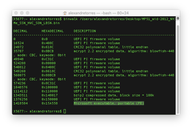

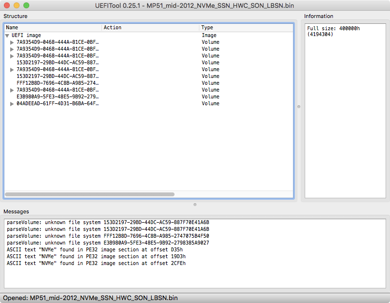

Ah. Ok.
[doublepost=1534575253][/doublepost]
[doublepost=1534574726][/doublepost]Something like that:
Great! Thanks for the tips!
