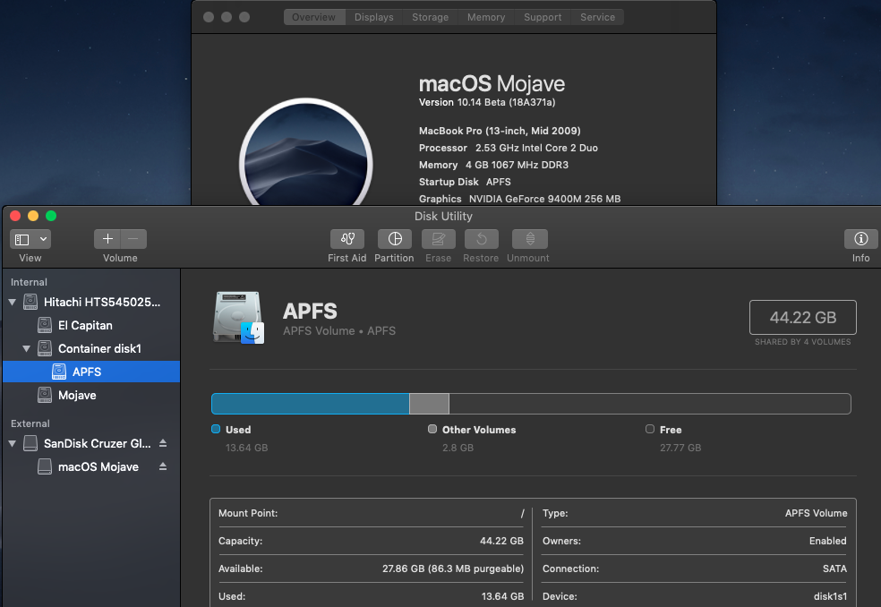

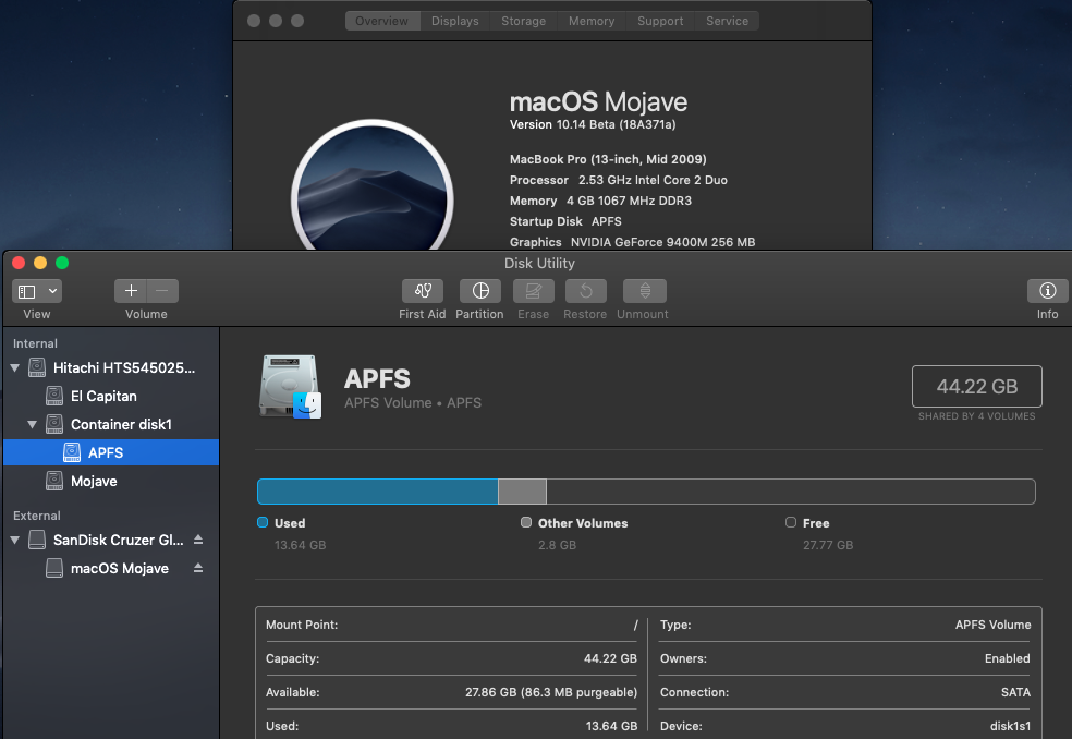

Good news! After installing DP8 on an empty APFS drive, running post install, the computer booted onto the APFS drive! Not going to risk my main drive, but I will keep this partition around until the next update rolls out to test the native updater. I have no idea what changed, but I got Mojave installed and booted on an APFS drive!View attachment 777081
Also, the EFI Boot option is back, going to go through the mounting process and see if I can get rid of it.
It seems that it is the converted volumes (HPFS+ -> APFS) that are the problem, as this mirrors my experience with external SSD drives. It also apparent that APFS formatted volumes will be a requirement for receiving updates via Software Update.
So did a reinstall of DP7, as Software Update did last update, restarts with Apple Screen, (Setting up your Mac) no UI glitches, this is was where UI glitches really became pronounced. Also after OS install rebooted without Patch, normally I'll get the ø.
Running 18A365a with NO trails. Go figure.

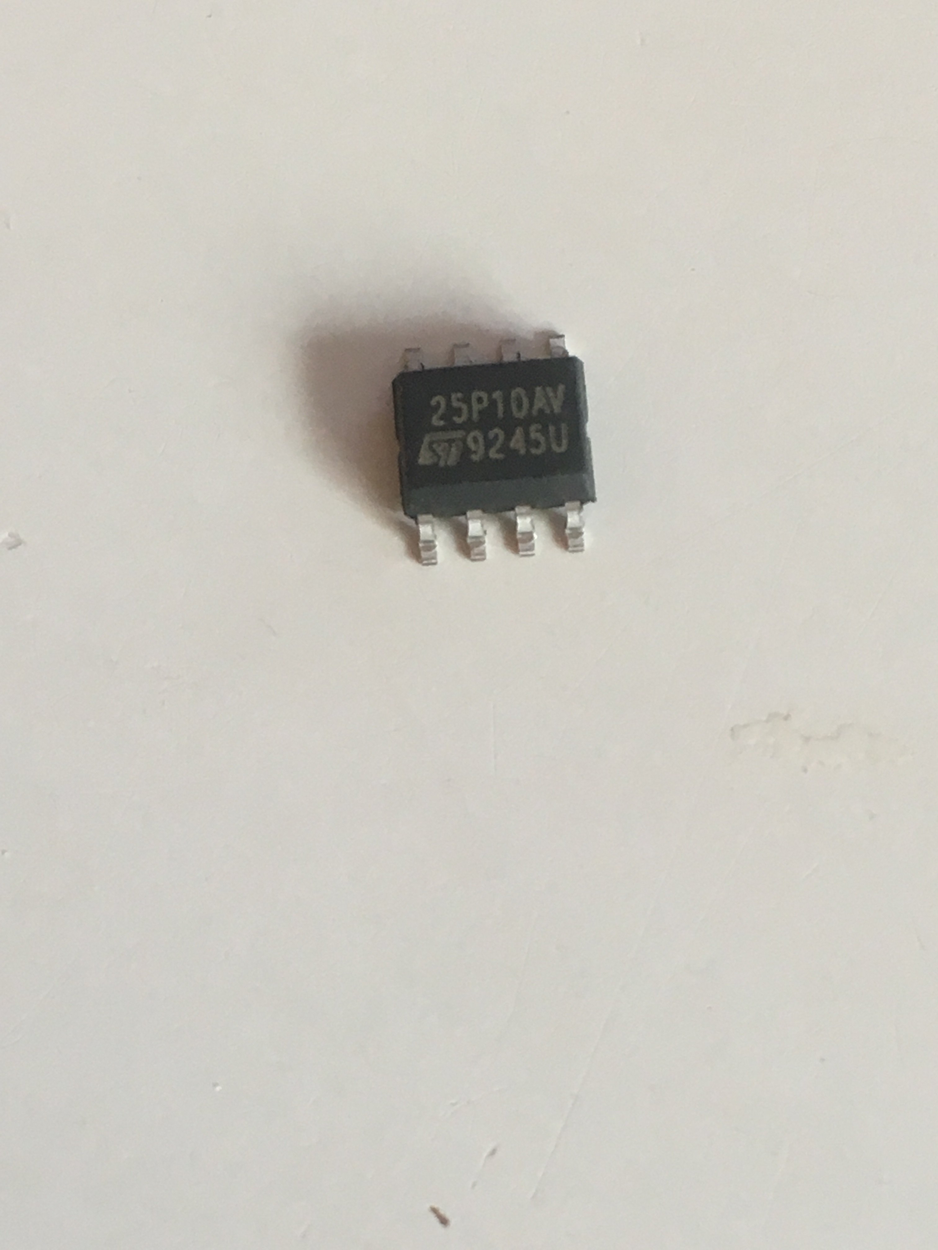

Buy a new ROM for a few cents, flash it in the EEPROM programmer BUT instead of soldering to the board again which risks overheating, solder on a short length of low resistance wire to each leg and the corresponding pad on the board—making sure the leg-to-pad orientation is correct. (You did refit the ROM in the correct orientation I hope!)
Then, if the flash hasn't worked, you can easily remove it without heat gun and reflash.

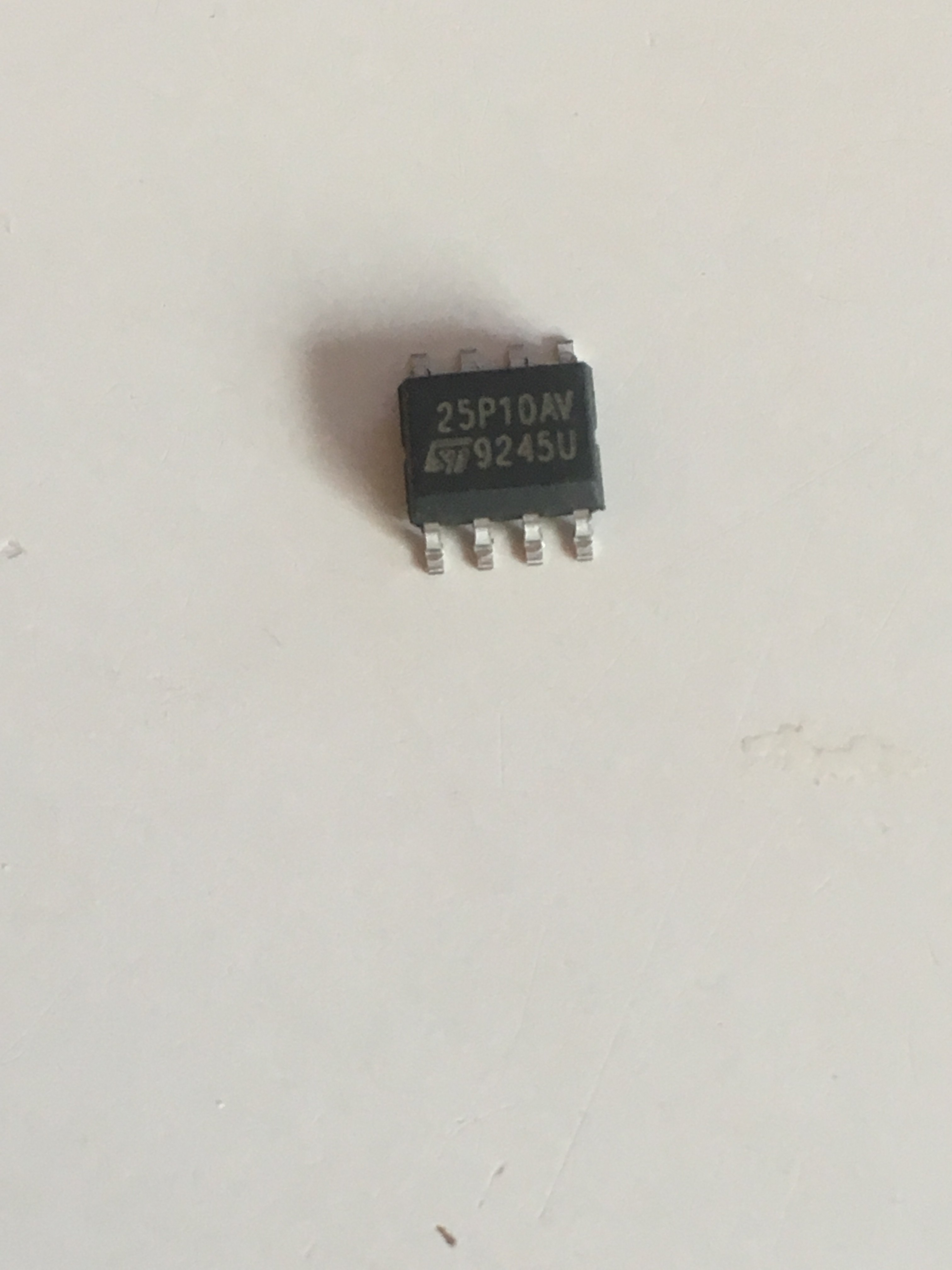

MBA2,1 uses 4MB QFN EEPROMs. The one pictured won't work. Heating the ROM to solder it won't hurt anything, I do it all the time. Most likely, the issue was just writing the dump back onto the ROM, or the ROM was soldered onto the board improperly. The CH341 EEPROM programmer is honestly a complete POS, I'd recommend something nicer like a MiniPro TL866CS.
I'd agree when a pro like you does it, but I've seen ROMs cooked by overheating with a heat gun at desoldering when amateurs try it first time.
It must be possible to buy the unflashed ROM for a few cents a piece from somewhere like Mouser.

Yes soldered in the correct orientation where the dot pin1 was, anyway not so bad idea to use wires for each 8 pins.
Anyway the MX chip is perfectly detected and flashable by the EEPROM tool software, I am not sure if a different vendor chip than MX could work for example WinBond.

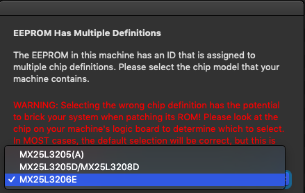

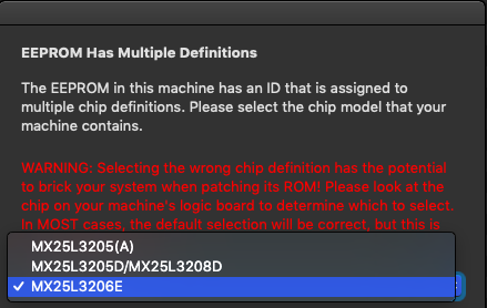

Firstly did anyone have success with the ROM Patcher version 2.0 on a MB 5,2? I saw the post from TimothyR734 that he did not.
On mine it does detect the EEPROM type - but gives a choice of 3.
... so I know I need to look on the LogicBoard to select the correct one.
Can anyone tell me where to look on the LogicBoard to determine the correct one to select. Front or back and whereabouts?
Thanks
Thanks

EFI CHIP A1304 MBA2,1 mid 2009
The EEPROM detecting/programming EFI CHIP and soldering back to the logic board have been done properly, I guess in desoldering too hot air gun has burned something around, it is like EFI CHIP is still bricked or undetected, stuck on white led without any beeps, anyway the fans turn on, the fact is that logic board is really thin and weak.
If you did not already, try resetting pram and smc.
The efi chip only has to be compatible with the board, it doesn't have to be the same exact chip.
And because its a core2duo I think you can swap any rom from a compatible board because they did not yet use the management engine.
That assumes that you did not mess up the smc which looks like its besides the efi chip.
