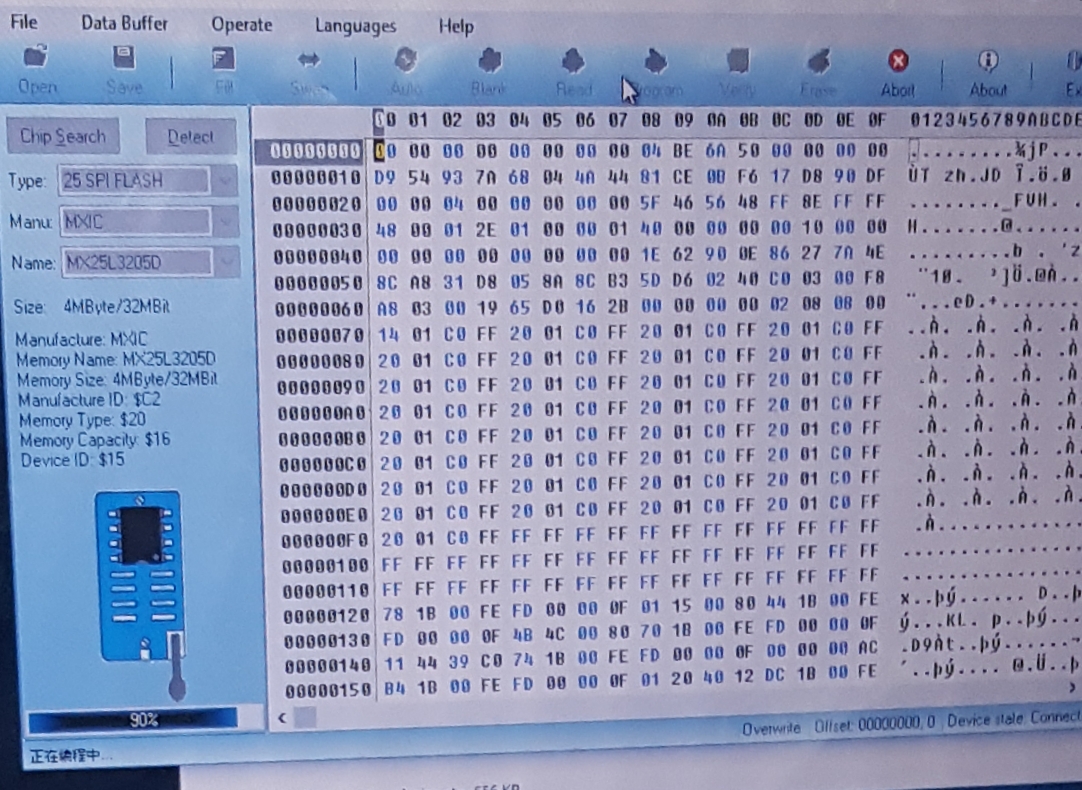

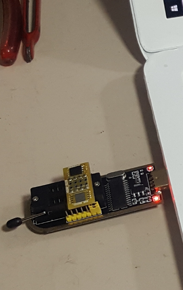

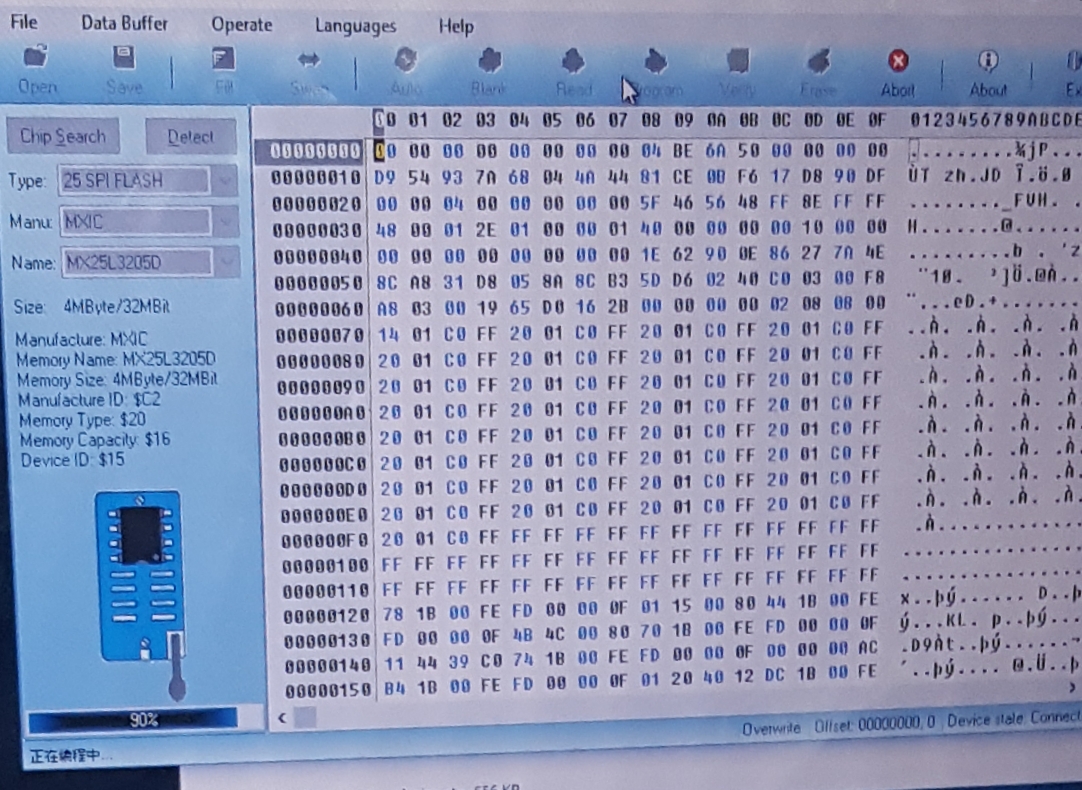

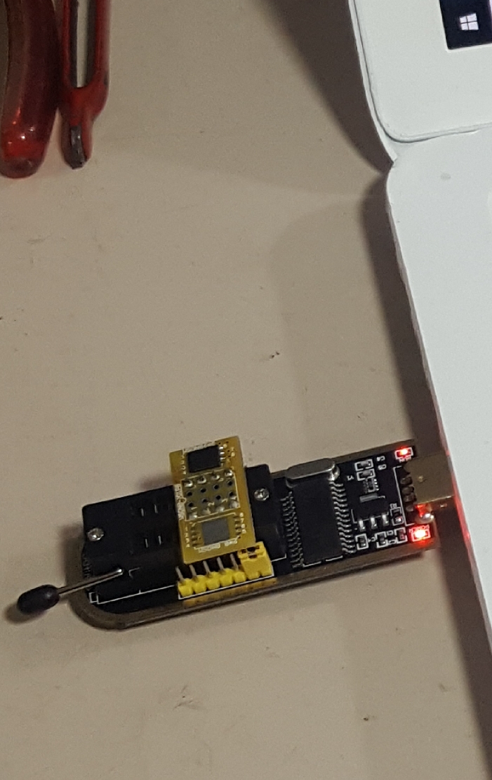

Agree, the EFI CHIP itself is endure to very high temperatures and it is also very hard to break, but consider that my EFI CHIP was on a logic board produced in 2008, and the entire board is not so much bigger than a GPU desktop card. Anyway the EFI CHIP has been soldered on the adapter to be re-programmed with stock firmware, everything went fine except soldering back to MBA, I repeat maybe too hot air has damaged on logic board 1 of 8 pins or something else.

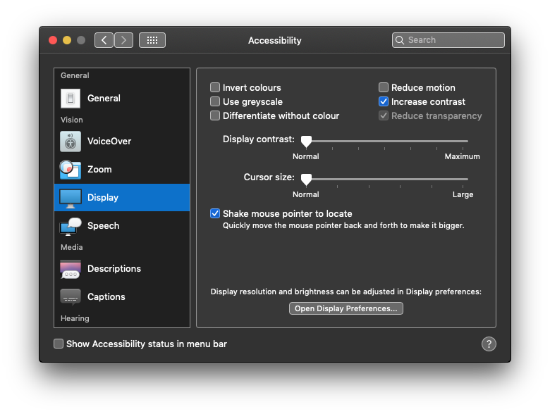

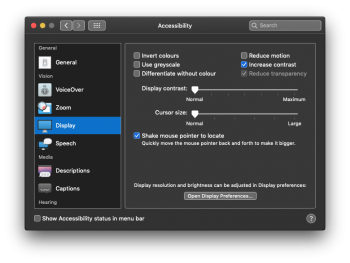

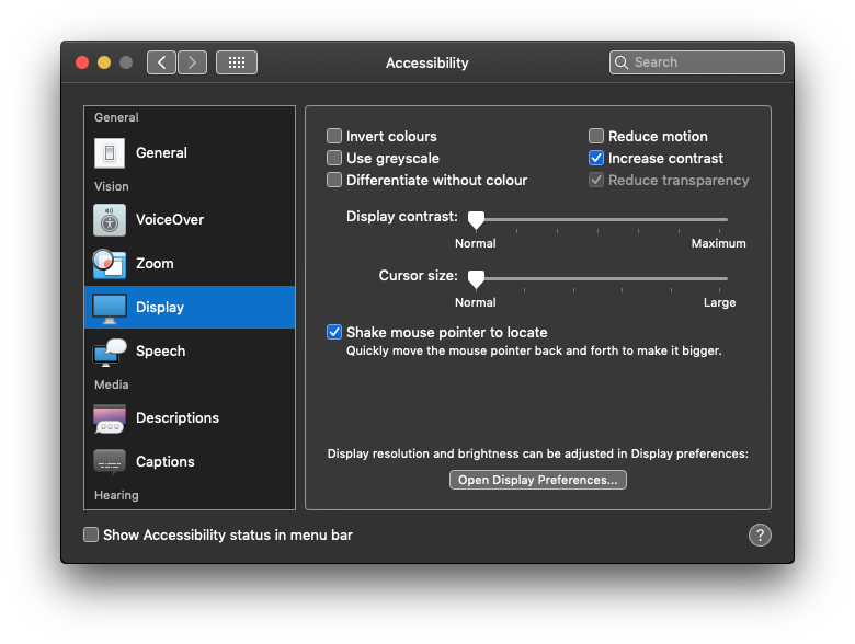

Honestly in macOS Mojave Developer Preivew 7 and 8, Reduce Transparency actually looks pretty good in Dark or Light Mode. I posted some images but, if it weren’t for my love of Dark Mode, I’d seriously consider using Light Mode even with Reduce Transparency. At the moment I’m using Dark Mode with Reduce Transparency because of the issues with Light Mode only apps and before DP7, I wouldn’t even have considered using Light Mode because of how grey everything looked. Here are the images: https://forums.macrumors.com/thread...ed-macs-thread.2121473/page-232#post-26372633
Reactions: TimothyR734
You're right - not too shabby. Almost makes light mode worth trying...I haven't installed 7 yet (believe it or not) but the code I see is changing...maybe by dp11 this will be a non-issue ;)
Already tried, SMC reset apparently works, while PRAM reset shows no power-on led but fans turn on in high ramp speed, the only way to turn off is unplugging the battery.
Maybe try smc bypass ? hold power button 10 seconds, put in charger, release power button. Fans running high could be smc issue, so I think its worth trying.
Also if the efi chip wasn't recognised properly when you flashed it, then maybe the backup that was taken is corrupt ?

Anyways windows seem to be drawn correctly in Safe Mode. Also I had the feeling that the fonts look much clearer.
Normal Boot (transparency) Safe Boot (no transparency)
EDIT: Forget about it, reduce transparency has exactly the same effect to the windows
