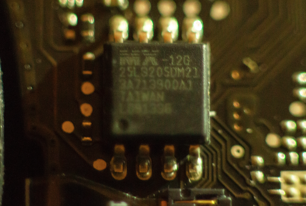

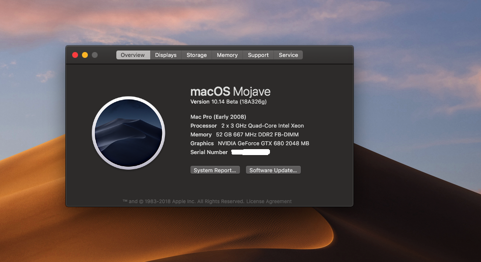

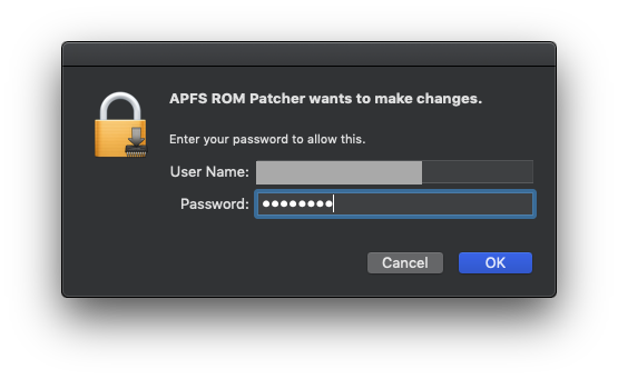

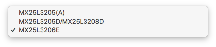

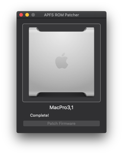

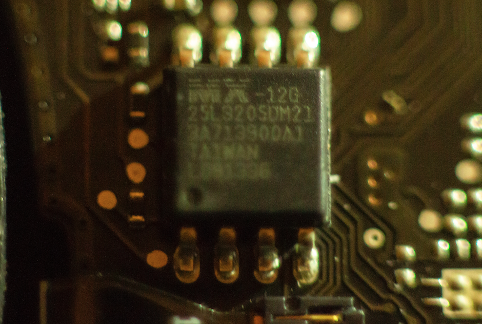

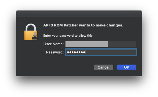

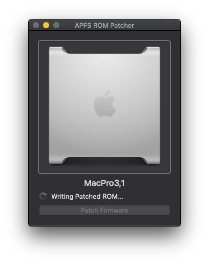

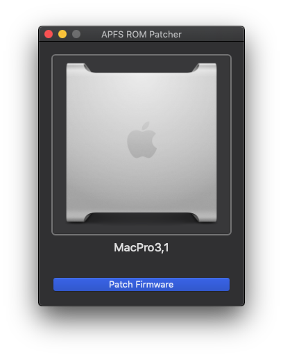

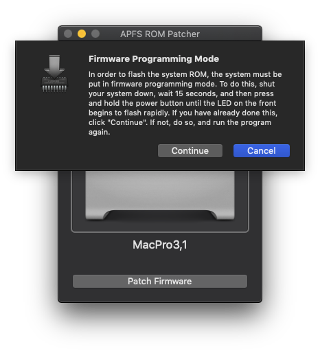

So here goes a blow by blow account of how this worked (for me)
READ THIS PANEL! After doing so I heard a long Beep! Then your machine will boot up normally...
View attachment 776079 View attachment 776080

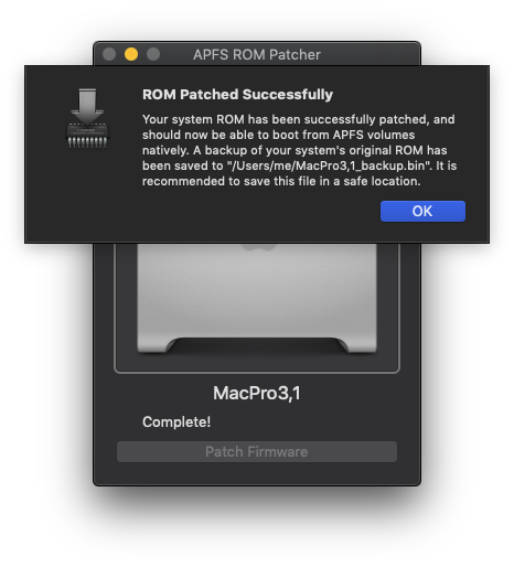

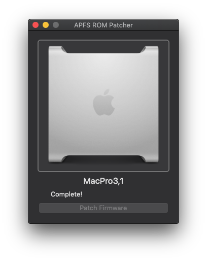

Success!

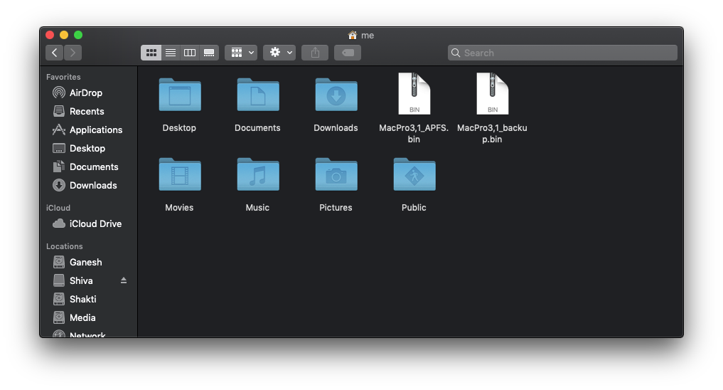

View attachment 776082 View attachment 776083
Your backed up roms are here...
Profit!
I haven't installed APFS yet. Will do so tonight...
Very clean manual !
Many thanks.

Alright, I've finally finished it... APFS ROM Patcher is finally done! Some precautions:
- APFS ROM Patcher is to be used AT YOUR OWN RISK! There is always the possibility that your machine could become bricked as a result.
- DO NOT apply APFS ROM Patcher if your machine already can boot from APFS volumes
- If you get the following dialog, it is HIGHLY RECOMMENDED that you open your machine, remove your logic board if necessary, and verify the exact EEPROM type your machine has. Selecting the wrong EEPROM model will MOST LIKELY result in a bricked system!
Download here. Please be sure to post results!
I have a few questions with regard to using this on a MacPro 3,1 which has...
Boot ROM Version: MP31.006C.B05
1) Later messages here indicate that the ROM patching is completed from within the running APFS ROM Patcher program. So is it correct to say that the process will be finished after you quit the program and that nothing is done during the next reboot? I ask because my understanding of dosdude1's earlier ROM patching programs was that the ROM patching was done during the next restart (like Apple's own ROM patchers) which is entirely different from how the 2.0.0 release seems to work now.
2) Has anyone running an APFS ROM patched MacPro 3,1 checked if the ROM patches cause any issues with booting Windows or Linux on a separate drive? I vaguely recall from the early testing that one user was complaining about the boot selector no longer working after APFS ROM patching. Is that all ironed out?
3) Is the boot time for a SSD APFS volume roughly the same as an HFS volume on the APFS ROM patched systems? I recall some users complaining that the APFS boot time was significantly slower than the HFS boot time on unsupported systems but it was unclear if all of those users were using the APFS patches or the APFS ROM patches.
Thanks in advance for any clarifications.
ps I assume that the MacPro 3,1 only has one variant of EEPROM to deal with.
