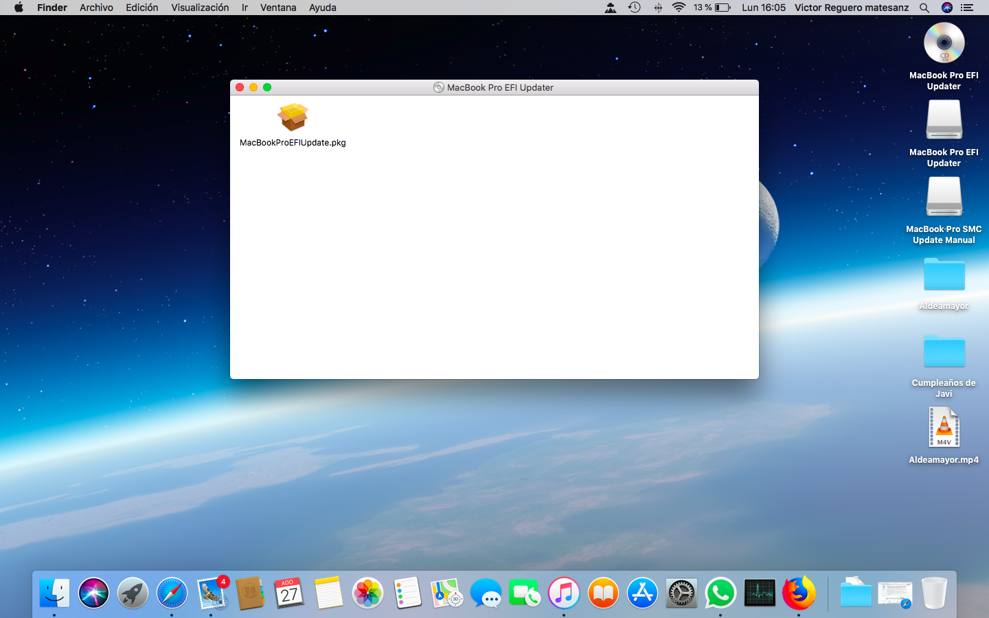

Tardé dos días en repararlo. Cada vez que encendía el MacBook Pro solamente emitía pitidos y no se encendía. Tardé 2 días en encontrar la solución. El cd lo tuve que crear desde un equipo windows utilizando TransMac. Entonces metí el cd en el MacBook Pro, conectado a la corriente. Lo encendí y comenzó a actualizar el firmware y a funcionar con normalidad. Al ver que había podido repararlo volví a intentar con APFS Rom Patcher y esta vez funcionó todo perfectamente y ya puedo arrancar el Macbook Pro desde discos APFS de forma nativa
If you used transmac it means that the CD you created is an hybrid HFS+/ISO/UDF , please could you elaborate which files do you have copied into the empty transmac's disk image before burning to an empty CD ?
It was a .pkg file or .fd file ?
But much more simply, since you already have your burned CD, insert into your MBP5,1 then open the CD from finder and take a screenshot of which files are inside the CD.
Firmware restoration CD is an Apple UDIF Media container with an HFS Mac OS extended (NOT plus/journaled) partition inside.
Only a BootROM .fd file could be recognized at low level for re-flashing an Intel Mac emergency firmware.
Anyway it remains still a mystery how you recovered a MacBookPro5,1 with a firmware restoration CD.

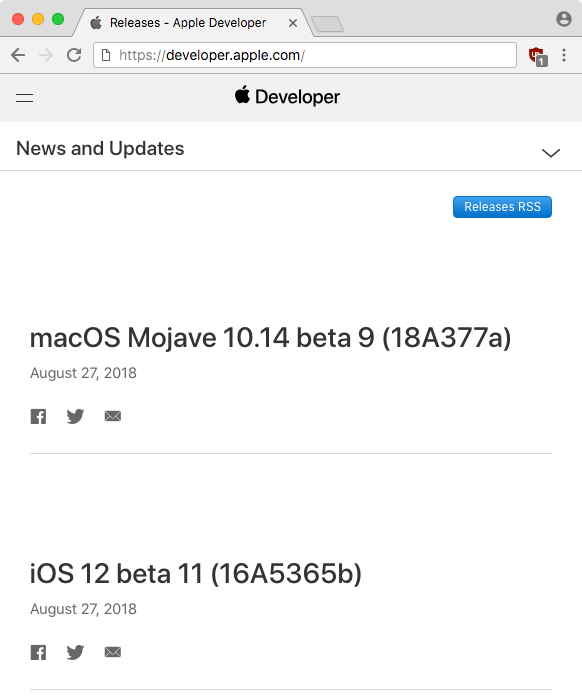

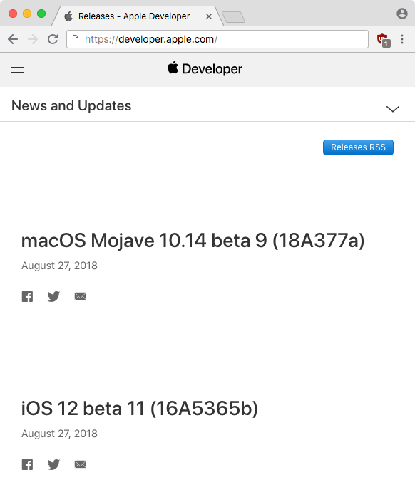

Beta's usually come out after 10am on the west coast :)
See, they were definitely just waiting for me to shout out! They must be watching us...

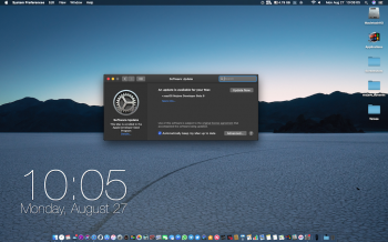

Its official DP9 3.27GB
Again, first! Quick on the draw...
How does it feel, any glaring changes?
[doublepost=1535390720][/doublepost]

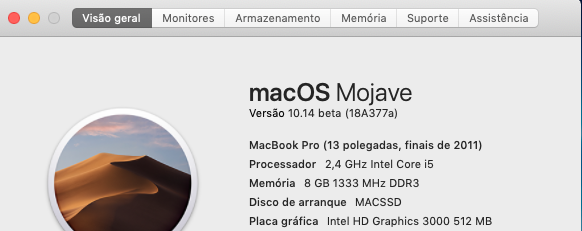

My DP9 download size offered is 3,54 GB, it's weird since I'm jumping from DP6, I expected a bigger download size, anyway for me the time has come to update.
I did a 6 to 8 and the size was about that too...
Mine is still installing went from 21 mins left to 10 min and not even quite a 3rd of the way !0 mins jumped back up to 51 mins
Definitely slower on restart. I will capture the distribution on my other machine once this one completes (hopefully) Something must be up...
