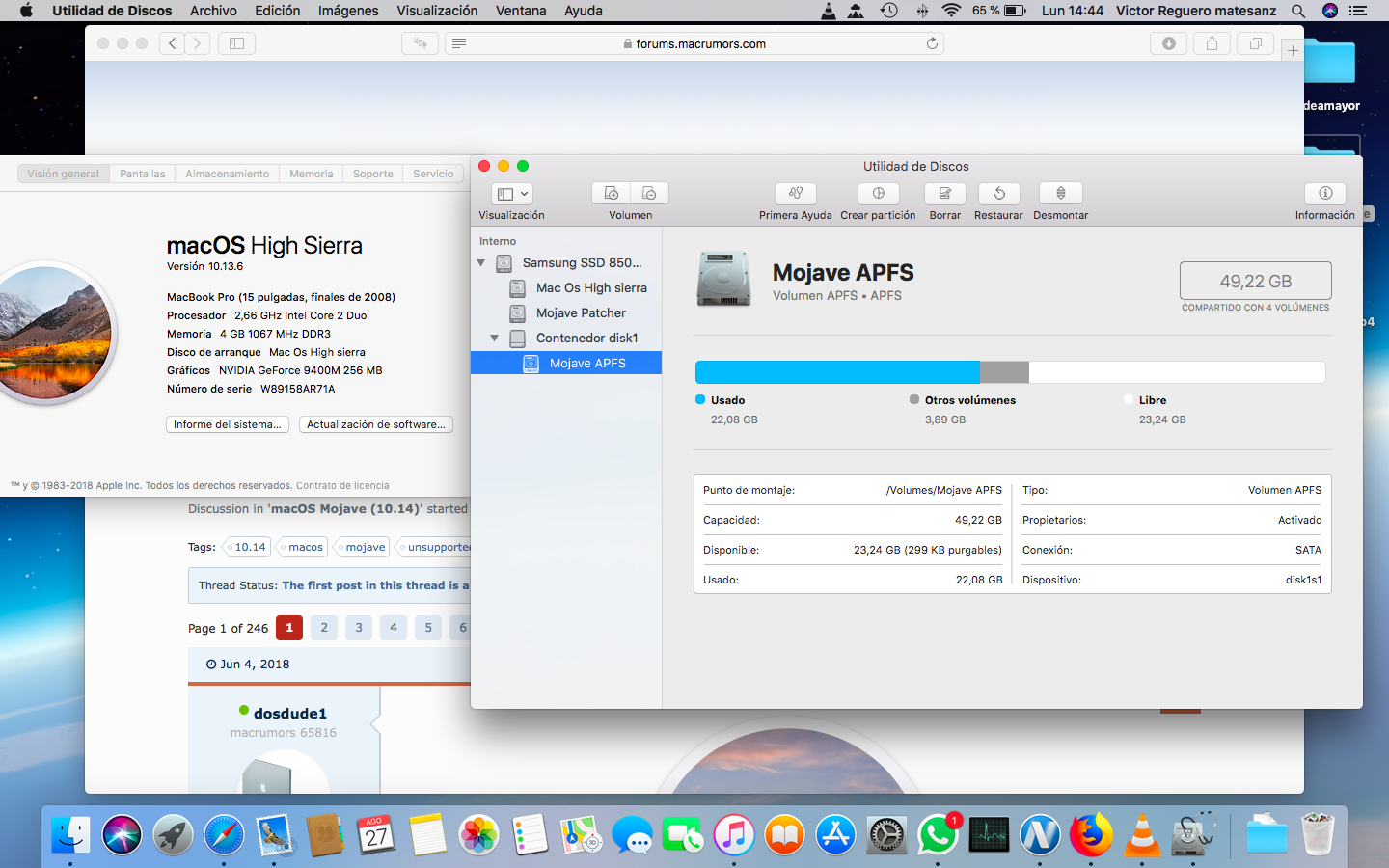

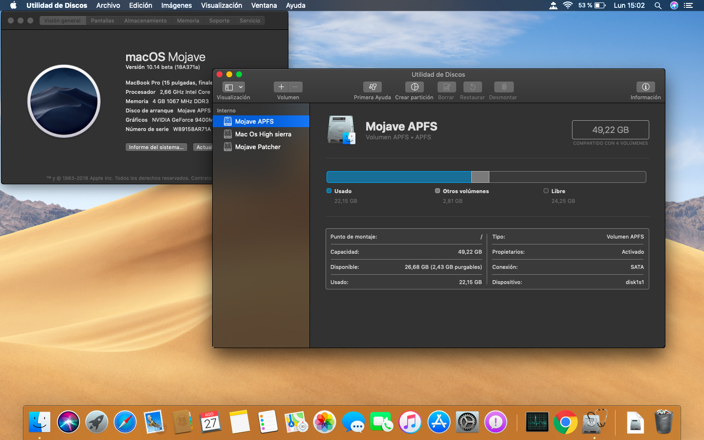

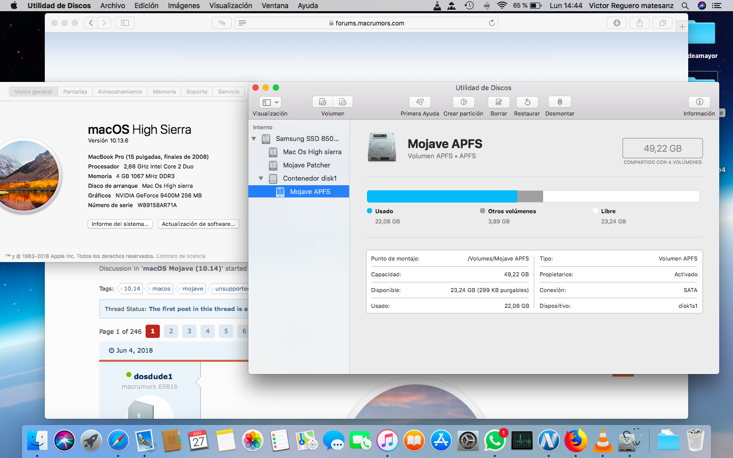

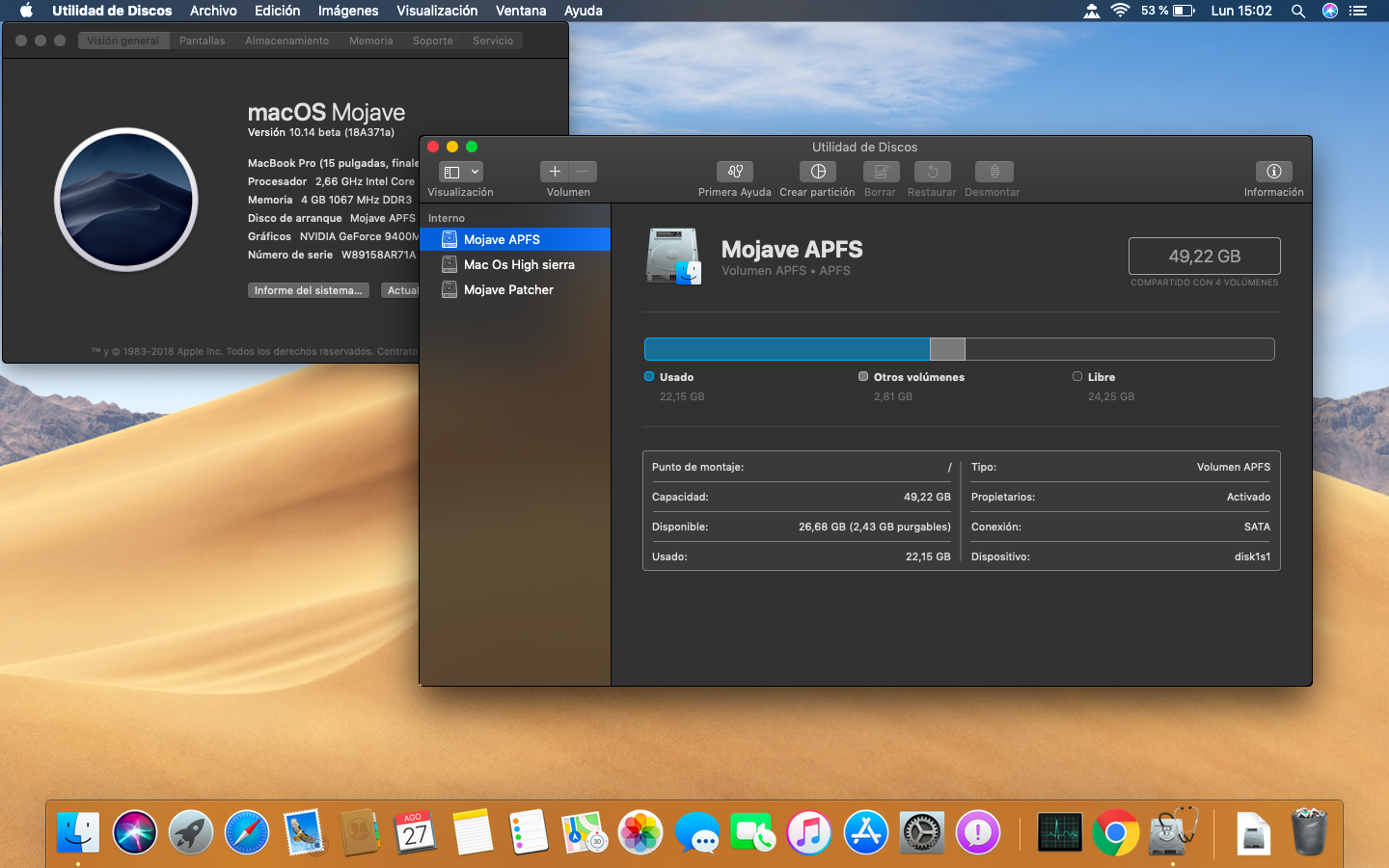

Just an update from my previous post. I patched my computer choosing the second option, and now it is dead as a dodo :S Already send it to repair... just out of curiosity, what was the correct option @dosdude1 ?
I did bricked too MBA2,1 a month ago, and it's not a pleasant feeling, anyway since you should have a MacBookPro5,x the user "victor30r" reported that has fixed his EFI EEPROM for MBP5,1 using the firmware restoration CD, here the conversation: Intel Mac firmware restoration CDs
If the CD doesn't work, there is another way to recover your firmware, since from your pictures you have inside logic board an EFI EEPROM CHIP "with paws" you could use/buy an EEPROM tool with a SOIC Clip without desoldering/soldering it, easily reprogramming from another PC/Mac.
But first of all you need your original EFI EEPROM firmware backup.
Use an external USB adapter plug your HDD into another Mac:
The APFS ROM patcher made a backup of your original EEPROM into /Users/yourusername/MacBookPro5,x_backup.bin
while you'll find the APFS Patcher logs (why it failed writing identifying wrong CHIP type) into the /tmp/ root folder.
Reactions: TimothyR734
