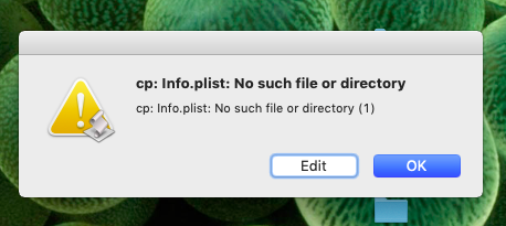

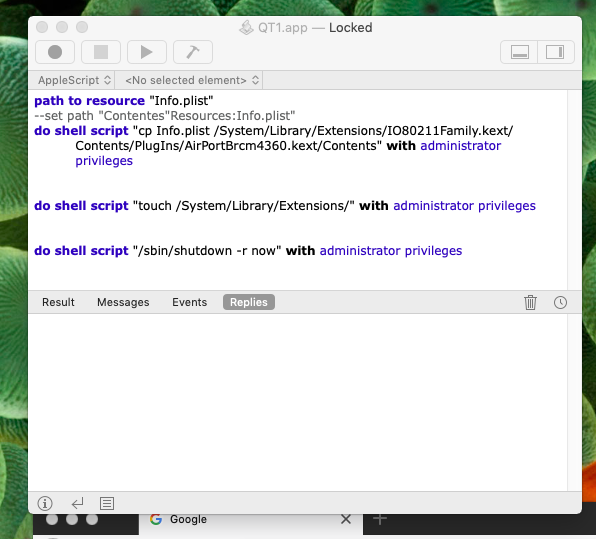

Thank you. I have attached two screen shots of the details I receive and wrote below.
I ran the QT1.app which came with this mcard2 and enabled the WiFi and Bluetooth under Sierra and High Sierra. When I run it now I receive an error "cp: info.plist: No such file or directory (1)"
If I go into "edit" the application output is this:
path to resource "Info.plist"
--set path "Contentes"Resources:Info.plist"
do shell script "cp Info.plist /System/Library/Extensions/IO80211Family.kext/Contents/PlugIns/AirPortBrcm4360.kext/Contents" with administrator privileges
do shell script "touch /System/Library/Extensions/" with administrator privileges
do shell script "/sbin/shutdown -r now" with administrator privileges

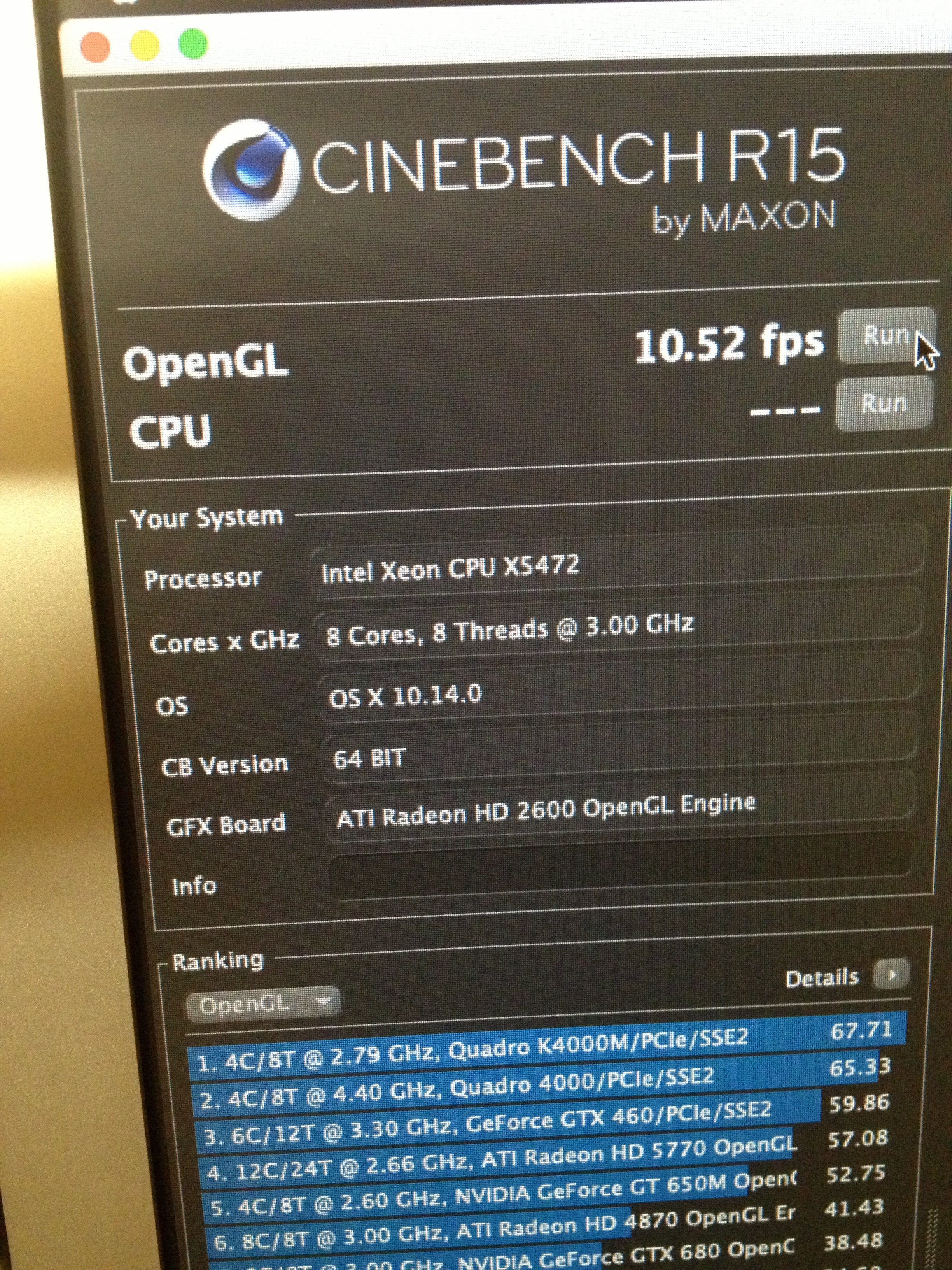

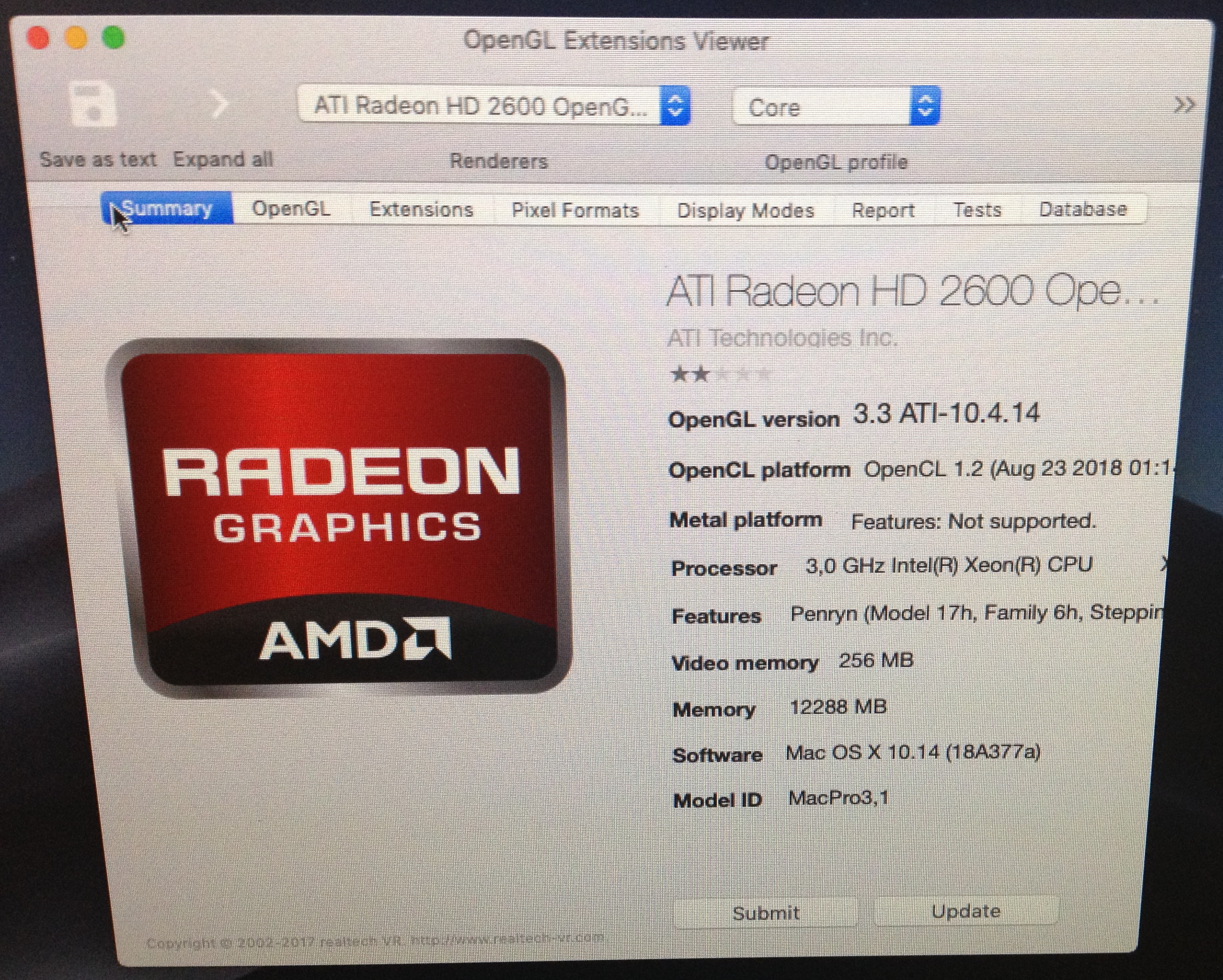

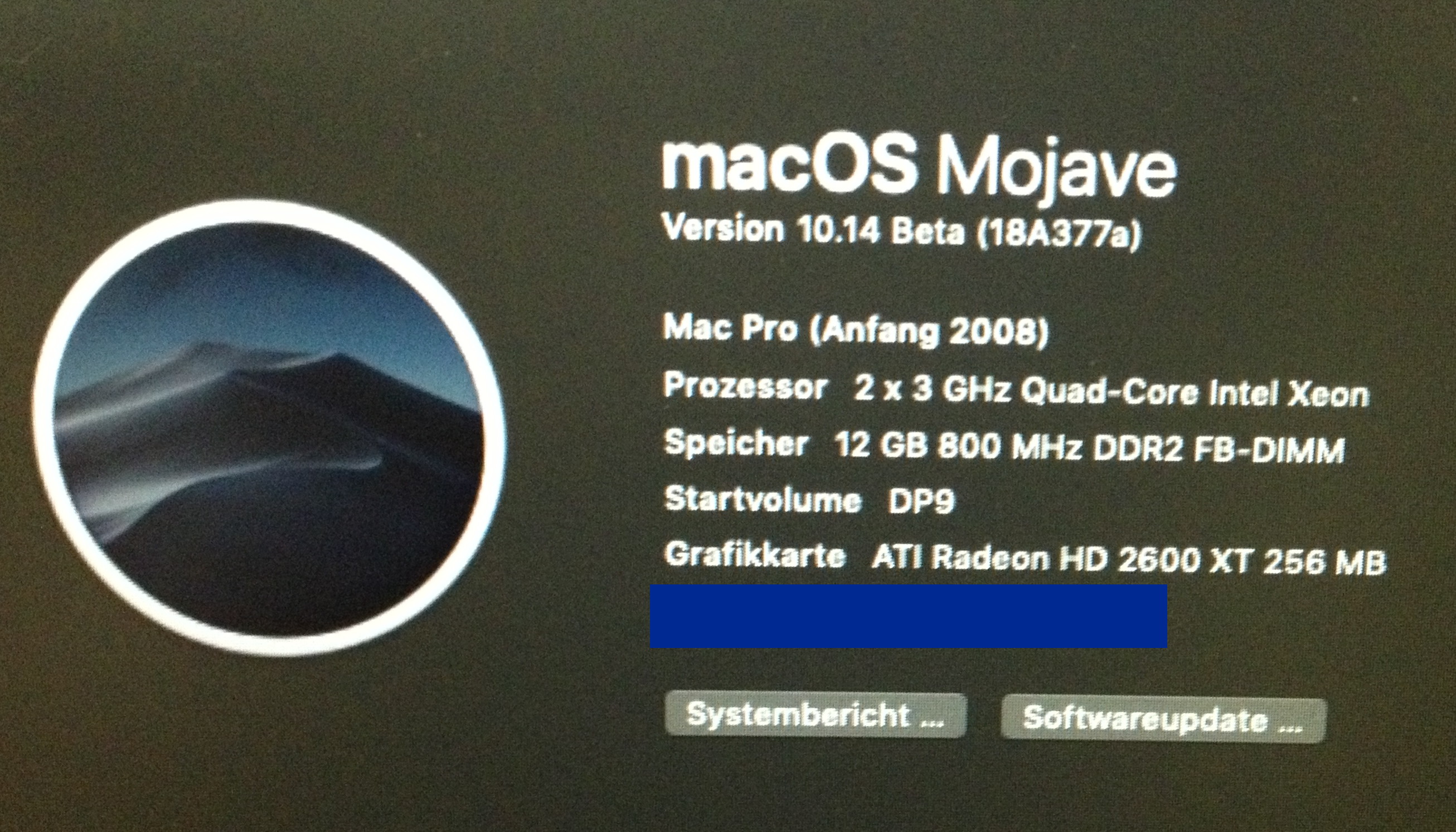

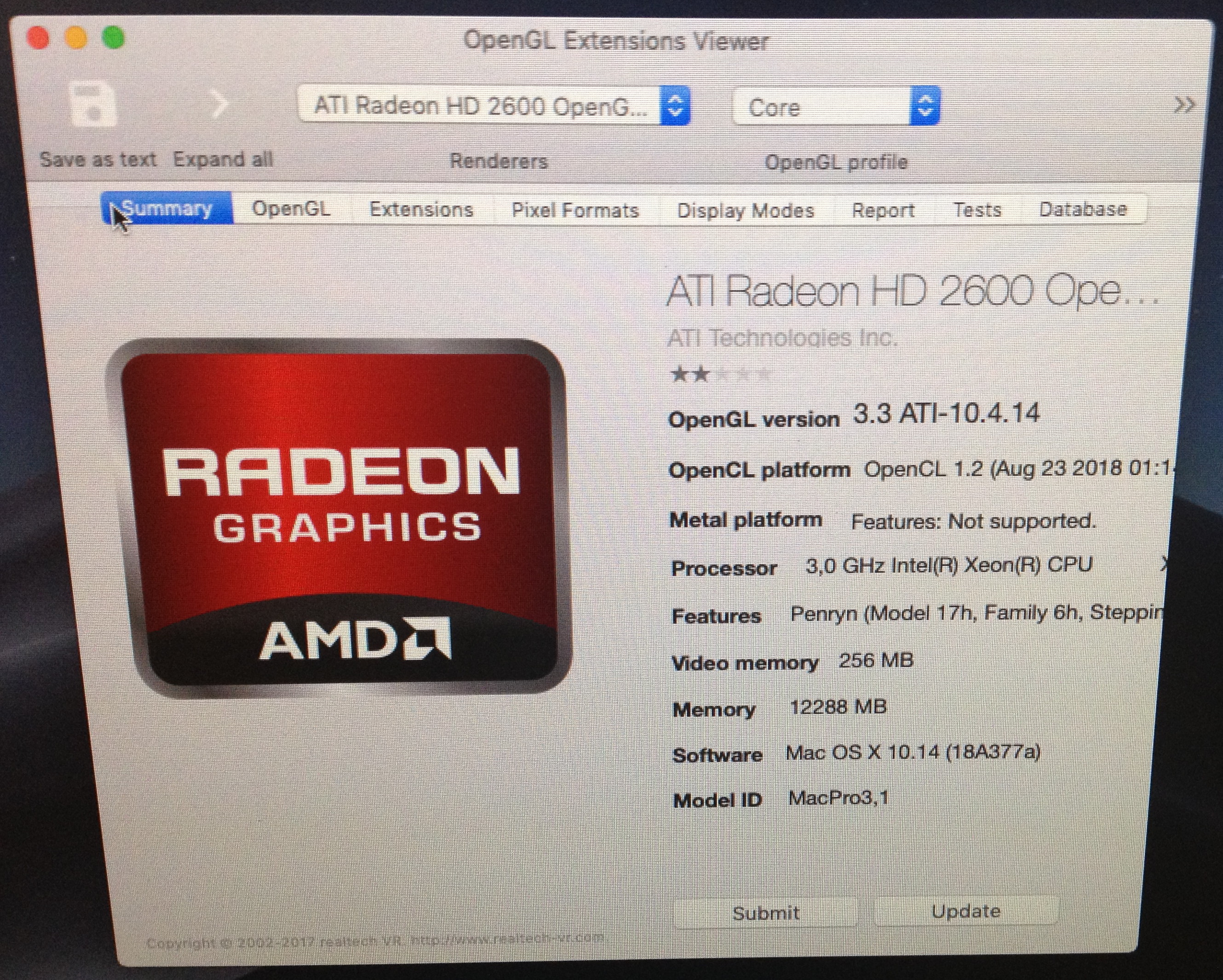

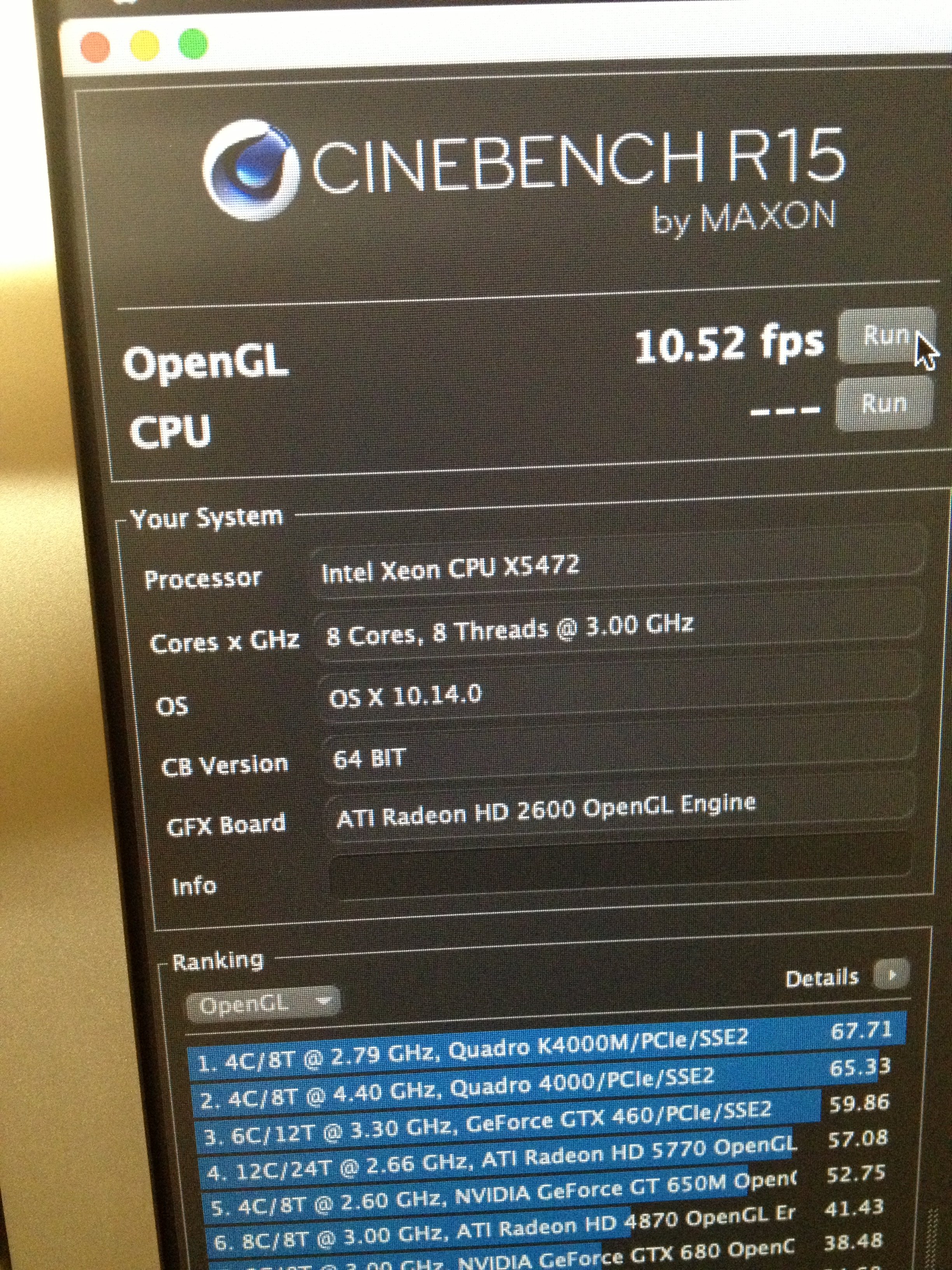

Lowest End GPU (HD2600) on Mac Pro 3.1 running Open GL with legacy video patches
It would be nice if we had more options for Metal compatible cards on the MacPro 3,1. The GTX 680 cards seem like they would generate a ton of heat inside the chassis compared to the HD2600 XT which, at its age, can't be good for the future longevity of these machines.

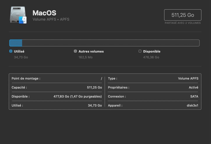

But, if I trash these files, will the APFS rom patcher still work ?

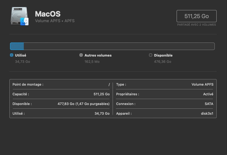

My SSD with Mojave is as (disk3s1) :
Of course. The BootROM patcher (if indeed you've run it) changes the BootROM i.e. re-flashes it, to enable booting APFS volumes. Hence the risk of running the patcher.
