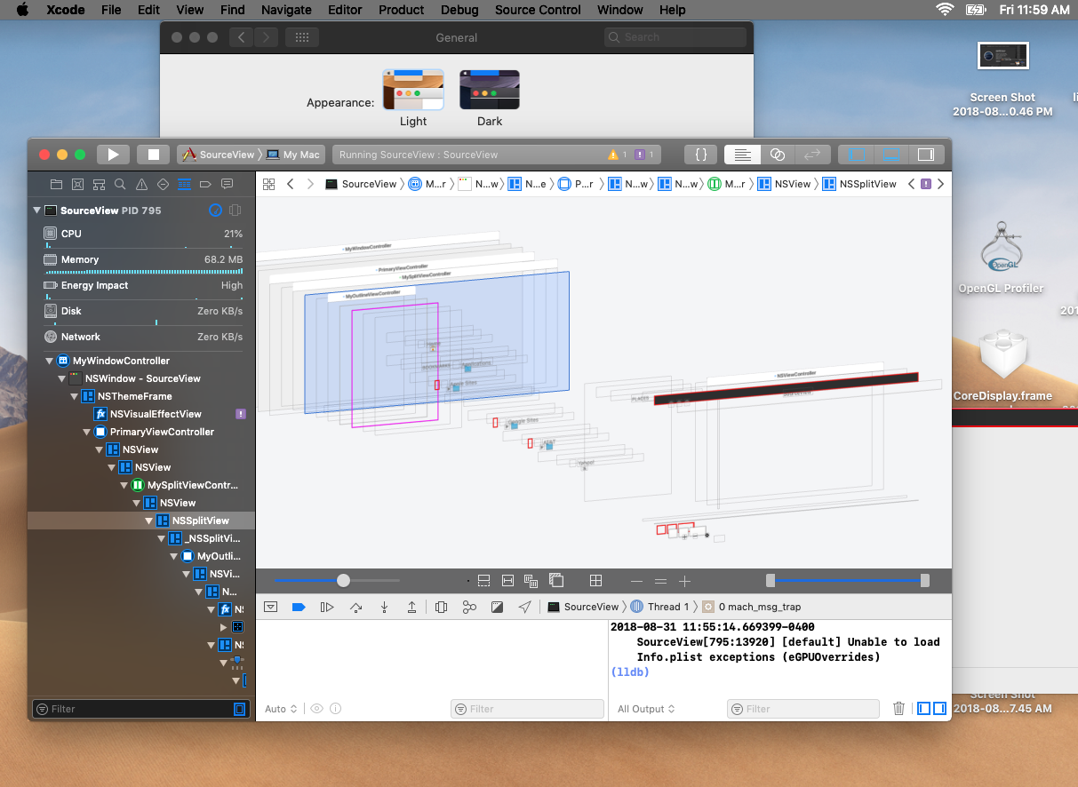

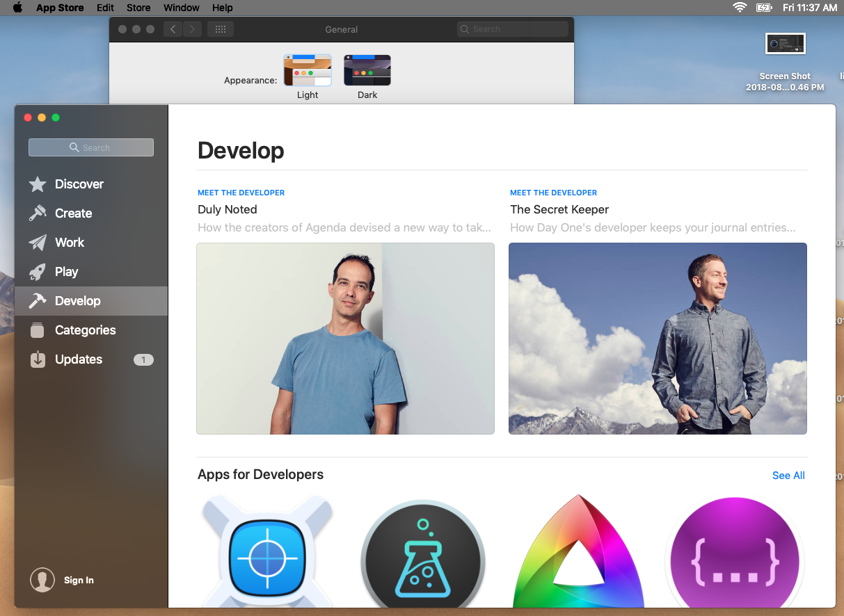

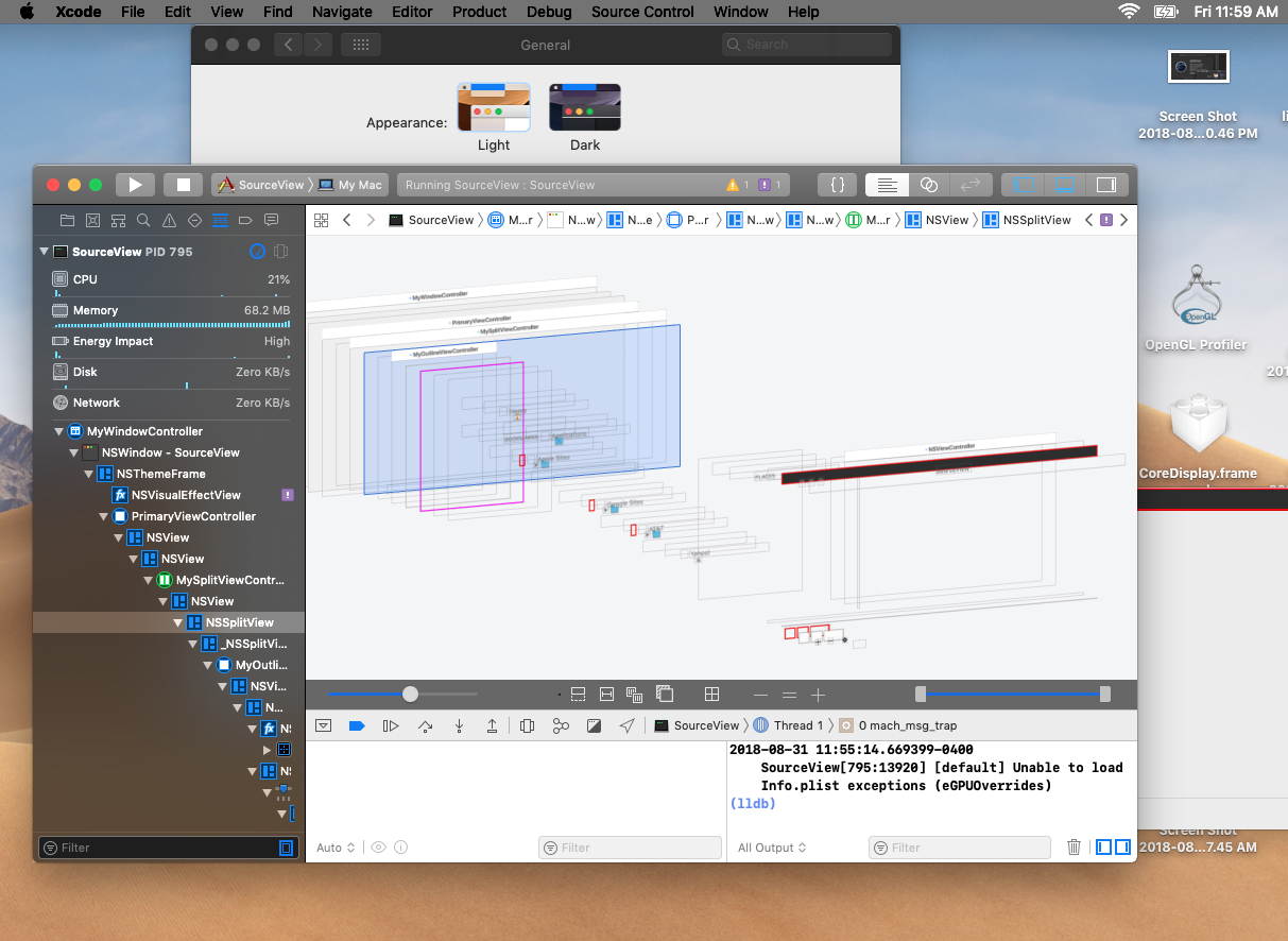

Light Mode "glitch" update:
Of Interest To :
  • those who have an unsupported machine running a non-metal card
  • those who hate Dark Mode
  • those who don't want to patch/tweak app by app (this is a system wide AppKit approach)
  • (currently) those who have NVIDIA gpus (this was tested on my mbp 5.3 with stock NVIDIA GeForce 9600M). I'm not sure what happens on AMD gpus.
Good news. Currently I'm able to patch AppKit to intercept the Light-Dark Mode switch and substitute a "hybrid" mode with our beloved translucency/transparency for some key UI elements while keeping content in a Light Mode. I call it Hybrid Mode. Most side bars are "vibrant" like in Dark mode, allowing for background blur. As seen below:
I think this may be an acceptable workaround for the VibrantLight mode which is currently broken on some of our machines (hence the famous "glitches")
I am currently working on getting the top menu bar to "vibe" also. It's not obvious as Apple is using some old (very old!) Carbon HTLB apis (wow - thought it was dead) . There are also some other menu bar solutions, but not as elegant as system wide approaches.
What do you think - just wanted to get your thoughts? Any one?

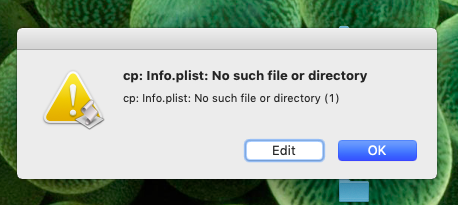

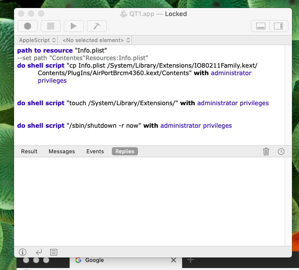

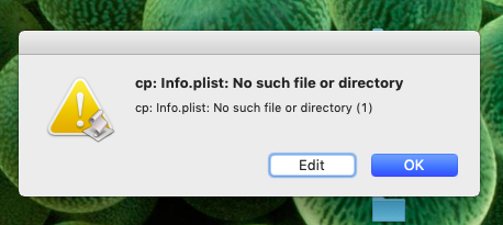

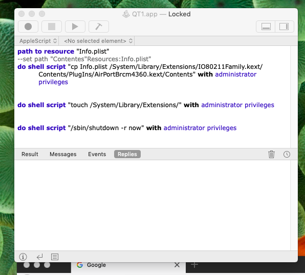

Thank you. I have attached two screen shots of the details I receive and wrote below.
I ran the QT1.app which came with this mcard2 and enabled the WiFi and Bluetooth under Sierra and High Sierra. When I run it now I receive an error "cp: info.plist: No such file or directory (1)"
If I go into "edit" the application output is this:
View attachment 778852 View attachment 778853
path to resource "Info.plist"
--set path "Contentes"Resources:Info.plist"
do shell script "cp Info.plist /System/Library/Extensions/IO80211Family.kext/Contents/PlugIns/AirPortBrcm4360.kext/Contents" with administrator privileges
do shell script "touch /System/Library/Extensions/" with administrator privileges
do shell script "/sbin/shutdown -r now" with administrator privileges
This is super weird, it looks to me like the install app is modifying a system kext: /System/Library/Extensions/IO80211Family.kext/Contents/PlugIns/AirPortBrcm4360.kext/ is built into Mojave and it wants to replace its Info.plist file? Presumably this will allow it to recognize the third-party card by adding a vendor id/device id to the file. That seems like an awfully hack-ish way for a legitimate hardware manufacturer to use, but alright...
If the script is failing, you can do it yourself.
In Terminal:
cd /System/Library/Extensions/IO80211Family.kext/Contents/PlugIns/AirPortBrcm4360.kext/Contents
sudo mv Info.plist Info.plist.backup
sudo cp /path/to/QT1.app/Contents/Resources/Info.plist ./
sudo chown -R root:wheel /System/Library/Extensions
sudo chmod -R 755 /System/Library/Extensions
sudo kextcache -i /
You will obviously have to put in the correct path to your app. If any step produces an error, stop. I haven't tried this and we might need to tweak things.
Of Interest To :
View attachment 778913 View attachment 778920
Out of interest, can you make that but inverted? So apps dark, sidebars and stuff light?
I have inserted the path in Terminal script below but I am still having problems. Does this look correct?
ASentientBot tips are correct, you have simply to replace the Info.plist inside that path but it seems missing or deleted, anyway a simpler way, open Finder and use keyboard shortcut: CMD+SHIFT+G

Thank you so much for your help.
Attached is my Terminal Text output...not sure where I am going wrong.
Your Terminal scripts appear ok, your issue is that Info.plist is totally missing in both path, try to download again the full QT1.app and explore inside packages to find the Info.plist, to copy try using Finder windows instead of Terminal
My mistake, last command was:
sudo reboot
Restart your mac it should work now.
Thanks for sticking with me on this, jackluke.
In the QT1.app the package Contents folder it contains an info.plist I attached...but there is also a info.plist in the Resources folder within the Contents folder.
Ok, then repeat all the steps but this time use the Info.plist inside the Resources folder copying it from the QT1.app into the other long Airportbrcm4360.kext/Contents path
Then from Mojave Terminal copy/paste the one line command to rebuild kextcache

[doublepost=1535755760][/doublepost]I must be doing something wrong...computer did reboot but still no bluetooth.
Attached the Terminal output...Thanks again for giving this a try.
The steps appear ok, retry last time re-replacing the QT1.app Info.plist from Contents into the long Airportbrcm4360 Contents
If still doesn't work, not sure but you could try to replace the entire IO80211Family.kext from HS into Mojave S/L/E
