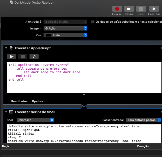

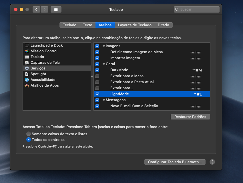

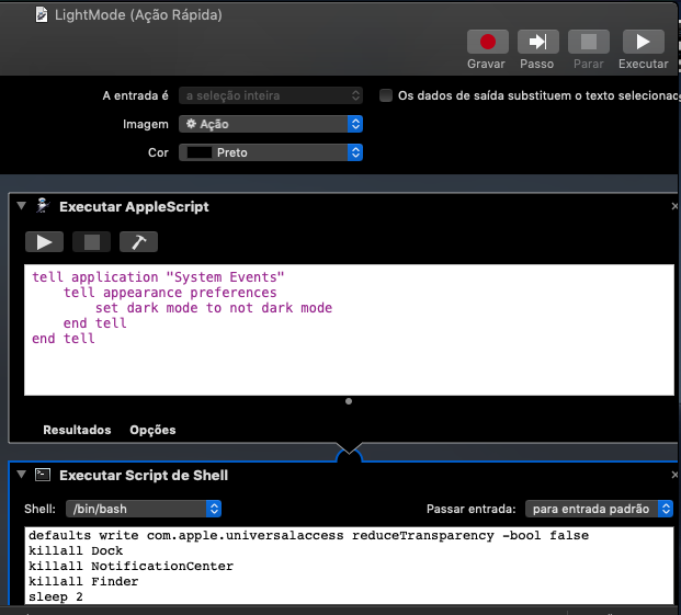

Could you do a hybrid script based on the clock time?
For example, with each reboot the script runs (because I already put it in the Initial Items), the script would check my schedule and then if it was between 6:00 am and 7:00 p.m., I would enter the clear mode, after that time dark mode.
I would have to put my two scripts together to accomplish this task or even create two scheduled tasks.
How do I do this on macOS?
Automator?
you. An use Automator, Applescript, cron Apple calendar or a native app xcode, startup script, shell script, a combination, pick your poison. An app with settings is best, just takes a little longer to make. Night owl ain’t bad. AppleScript also has a script menu available in prefs. Automator has a good bit of options, but I am leaning towards an menuet app

Solved
Pending: Automate the script to run at scheduled time.
I think is better compiling all in Apple script, you can check the dark mode status
tell application "System Events"
tell appearance preferences
set dark mode to not dark mode
set scuro to get dark mode
if scuro then
do shell script "
defaults write com.apple.universalaccess reduceTransparency -bool true;
killall Spotlight;
killall Finder;
defaults write com.apple.universalaccess reduceTransparency -bool false;
killall Dock;
killall Finder;
killall NotificationCenter;
killall Spotlight;
defaults write -g CGFontRenderingFontSmoothingDisabled -bool NO;"
else
do shell script "
killall Finder;
killall Dock;
killall Finder;
killall Spotlight;
killall Finder;
killall Dock;
killall Finder;
killall Spotlight;"
end if
end tell
end tell
