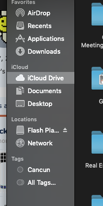

Hey everyone, I own the MacBook Pro, late 2011, 13 inch! Just wondering how would I go about installing Mojave on my Mac?
All I'm concerned about is the "weird darkish grey Menu Bar and Finder sidebar" issue, has that been fixed yet?
Please let me know! It is my understanding that the installation should go just fine! I just need some up to date advice about installing it, thanks!
Hope this helps, I just installed it on my machine which is the same as yours. Snip of Finder, looks okay to me:

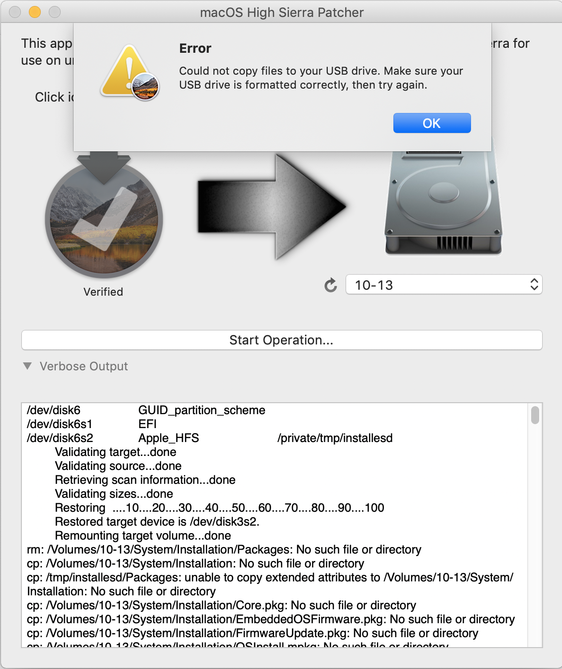

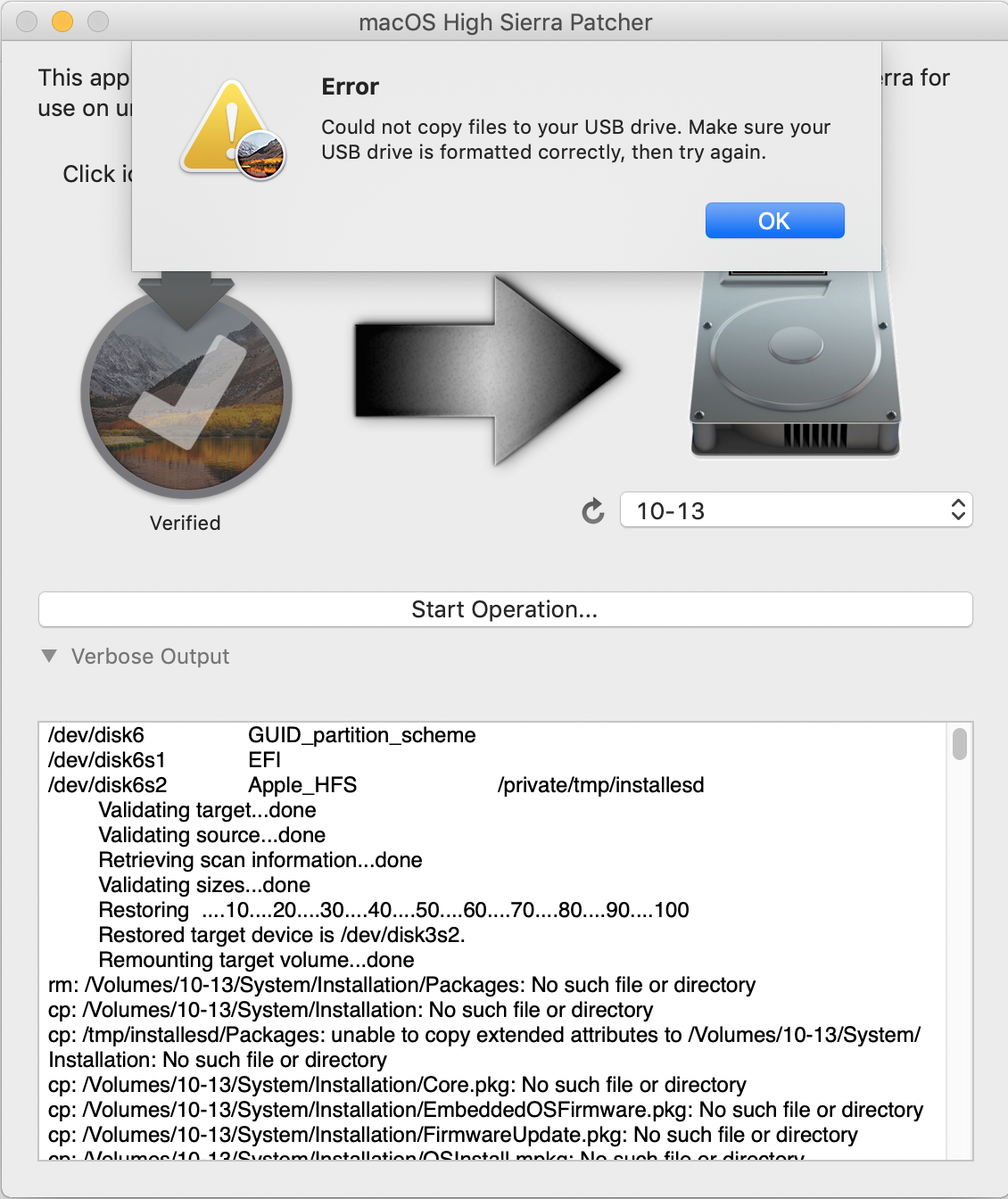

@dosdude1 Something broke with the high sierra patcher running on Mojave/supported hardware (tested on 2 machines with SIP enabled and disabled) as I have exhausted all options to create a working USB flash stick and internal partition high sierra installer.
I am re-downloading high sierra installer directly on a HFS+ formatted partition instead of APFS on Mojave .. I am suspecting Apple may have done some changes to either the High Sierra installer or added some additional protections to Mojave.
Update: Latest attempt failed - attaching screenshot.
Update2: No problem creating a Mojave installer with your Mojave Patcher. Issue is only with High Sierra Patcher as I was able to create a normal USB installer using Apple's creatinstallmedia instructions.
When first erasing the patch installer USB stick try naming it OS X Base System (with the spaces as indicated) and see if that works.
That's what it took in my particular case, after that had no issues with USB installer.
As a footnote early betas wasn't that much of an issue, at some point naming USB, OS X Base System was what worked for me, as what was posted earlier.
