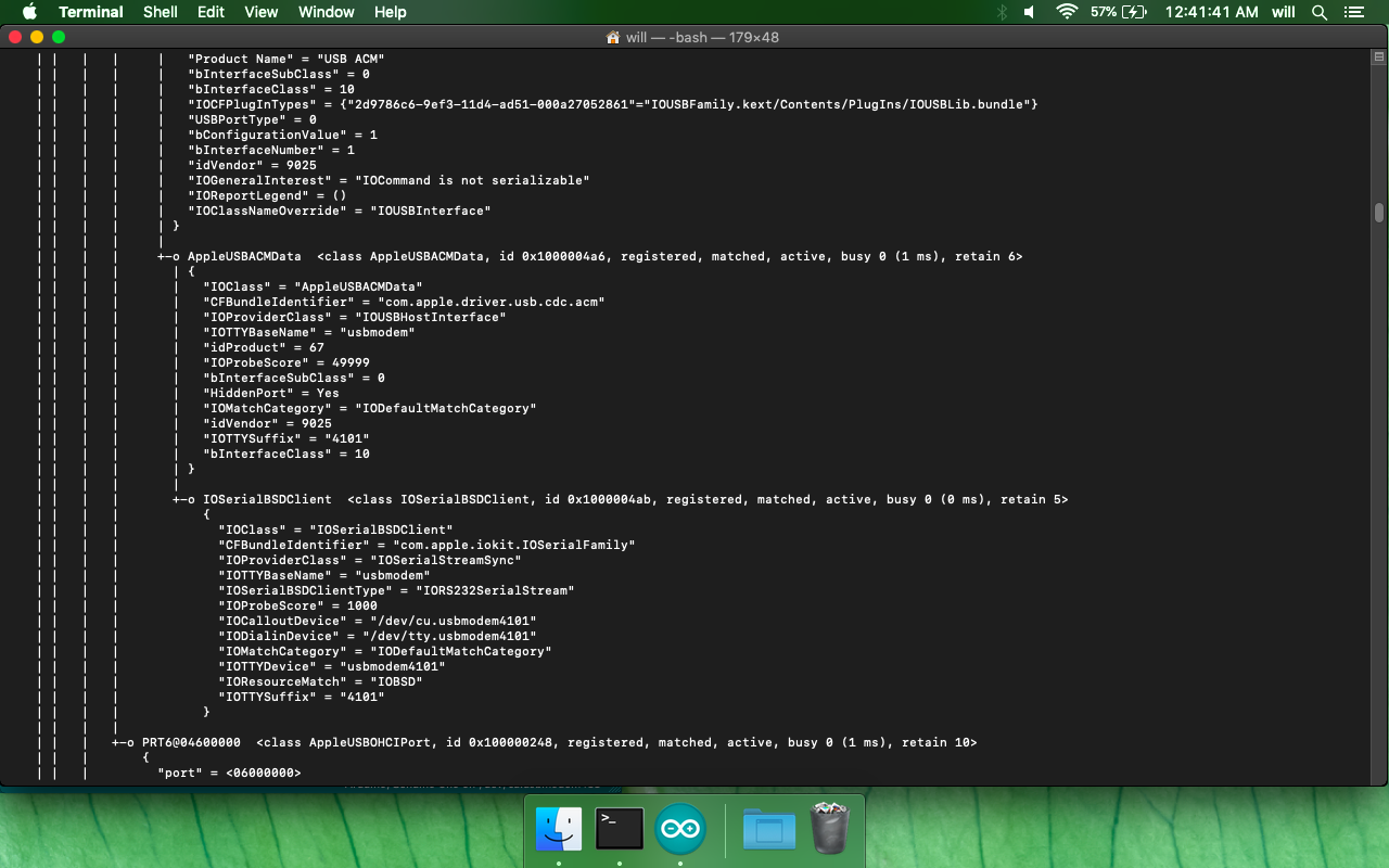

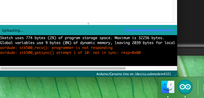

[doublepost=1540270760][/doublepost]Hey everybody! This applies to very few people, but I'm going to document it since someone might come across this in the future.

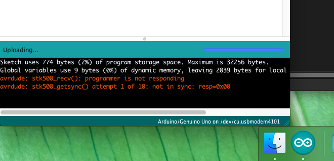

I recently tried uploading code to an Arduino for the first time since installing Mojave, and, well, it didn't work. More precisely, I got this error.
Code:
stk500_recv(): programmer is not responding
stk500_getsync() attempt 1 of 10: not in sync: resp=0x00

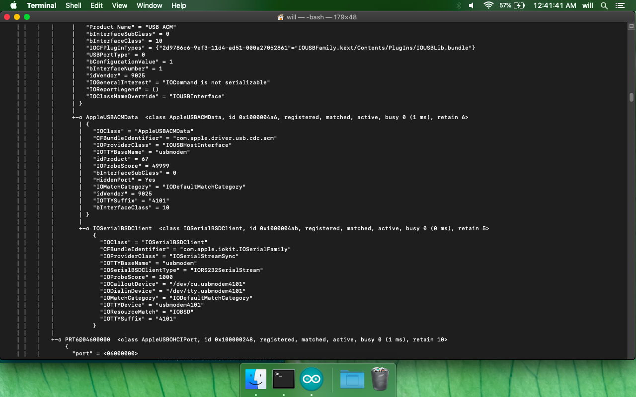

I tried a good old ioreg.

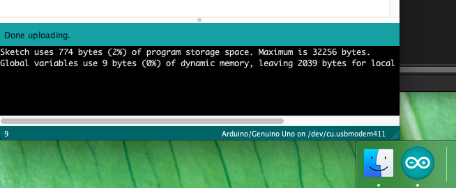

Then, going off what I saw there, I replaced AppleUSBACM.kext from High Sierra and rebuilt the prelinkedkernel.
Solved!

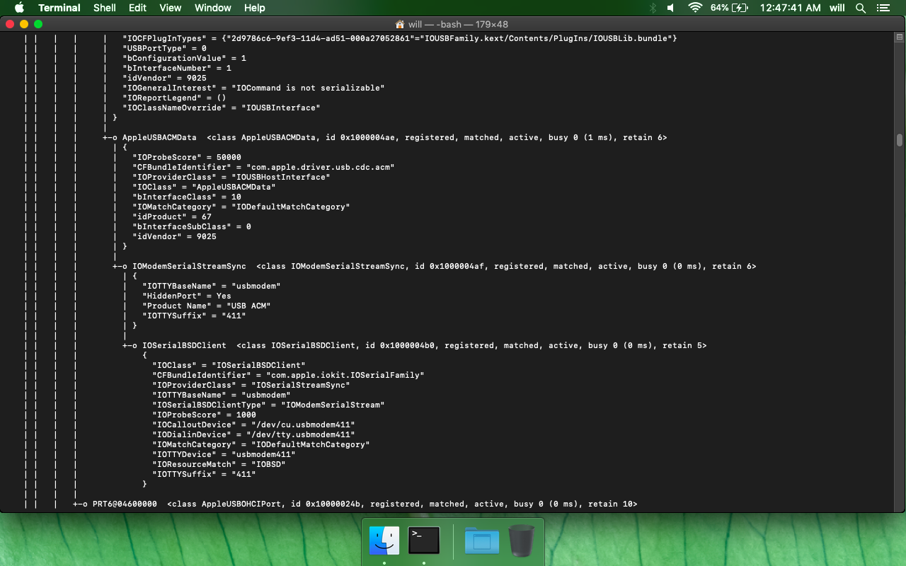

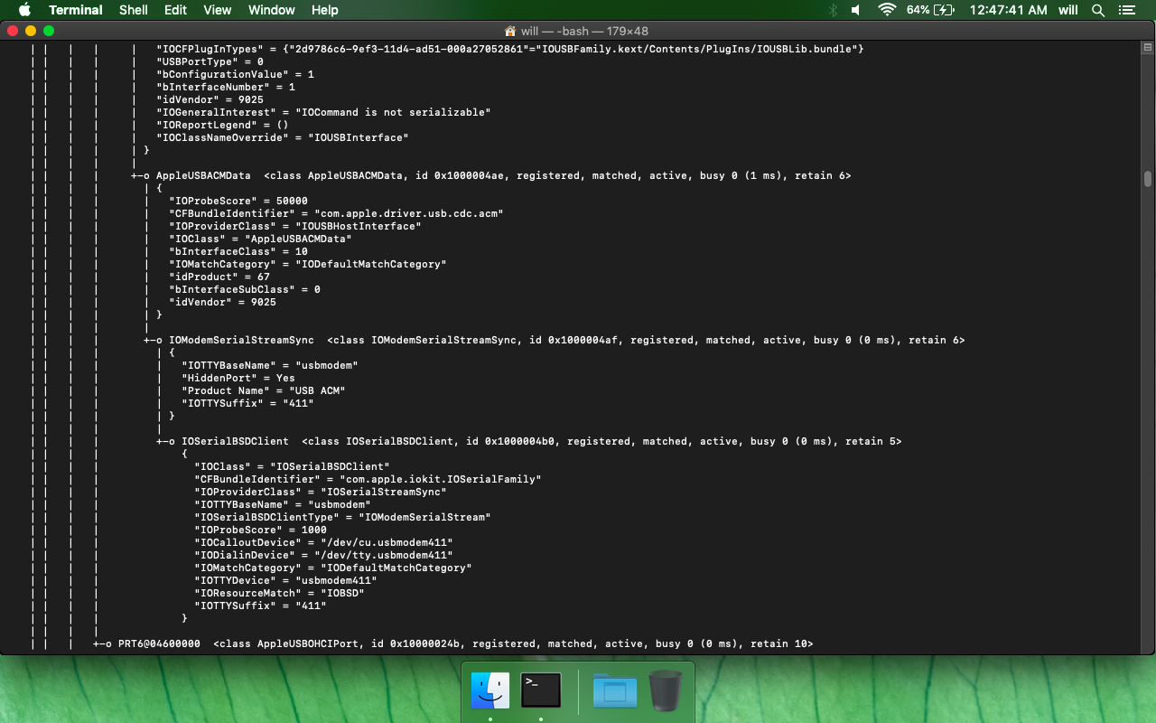

And you can see a couple things are different -- it's called usbmodem411 rather than usbmodem4101 and the ioreg output is also different. Interestingly, there's a new element in the tree: IOModemSerialStreamSync. Related to the "not in sync" errors? In any case, it's working beautifully now.

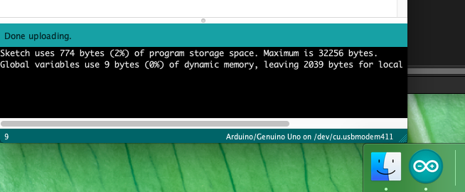

Anyways, so sorry for the long post that is most likely spam to 99% of people. I hope this helps somebody, though. I am just glad to be able to program my trusty Arduino Uno again :)
@dosdude1 Worth adding to the patcher, deselected by default of course?
Edit: For clarity, all of this is on a MacBook7,1 that already requires replacement of IOUSBFamily and IOUSBHostFamily. Most likely, a newer system not needing these patches, will also not need this one.
