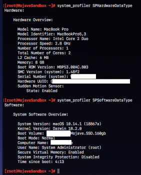

Good Morning (or whatever timezone where you are at).
Here's the info, captured via Terminal. Also included the Software Profile.
For those that have the same device (MacbookPro5,3) that failed upgrade to 10.14.1 beta 4, can you share your existing BootROM and SMC versions too?
Regards.

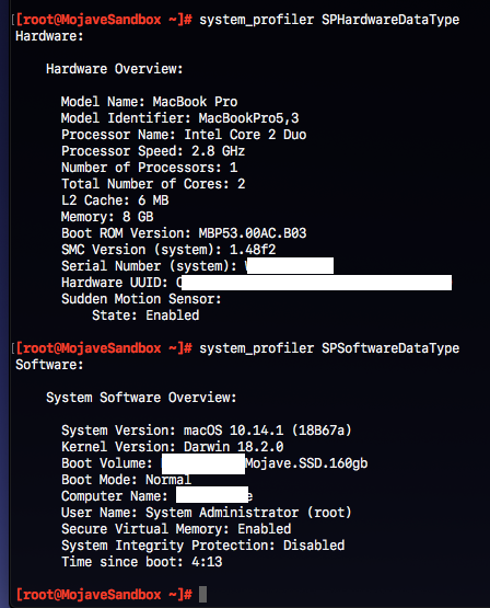

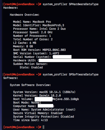

Regards.
Ok, I can confirm you that the 1.48f2 SMC version was released in 2010 so you have still original old firmware, now, can those who own the same MBP5,x and have failed to upgrade 10.14.1 beta, check their BootROM and SMC versions ?
I believe this check is explanatory.

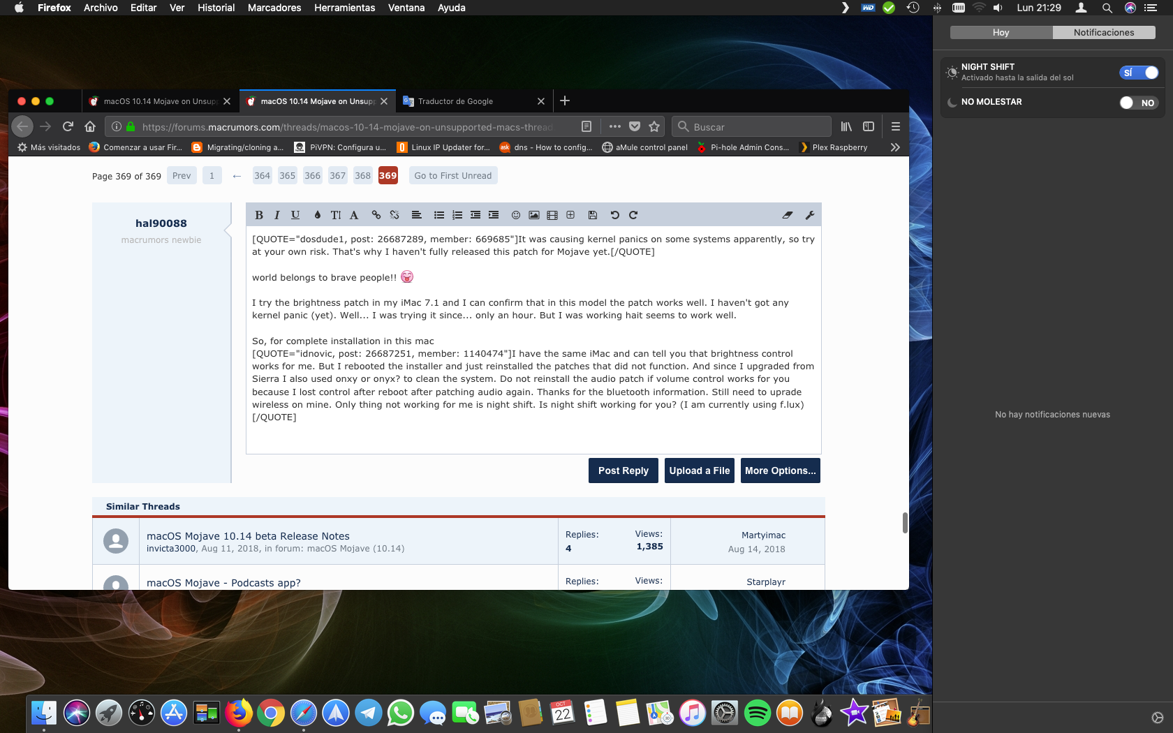

I try the brightness patch in my iMac 7.1 and I can confirm that in this model the patch works well. I haven't got any kernel panic (yet). Well... I was trying it since... only an hour. But I was working hard during this hour and it seems to work very well.

I have the same iMac and can tell you that brightness control works for me. But I rebooted the installer and just reinstalled the patches that did not function. And since I upgraded from Sierra I also used onxy or onyx? to clean the system. Do not reinstall the audio patch if volume control works for you because I lost control after reboot after patching audio again. Thanks for the bluetooth information. Still need to uprade wireless on mine. Only thing not working for me is night shift. Is night shift working for you? (I am currently using f.lux)
YES!!! With the brightness patch now in mojave works all that was working in High Sierra. Night shift is working too. Now I can use bluethooth, wifi, the buttons to control bright and volume, sound... ALL!!! But i don't needed to patch audio. I use all the patches that appear in the installation of "mojave patcher" for this computer. Then, I patched manually bluethooth and I use the brigthness patcher. Only with this all is working.
