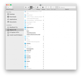

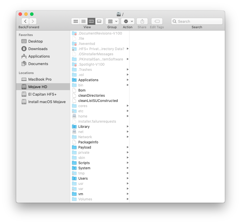

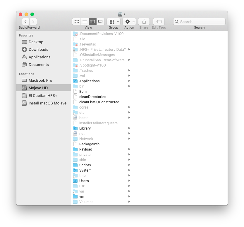

Which do I delete?
Ok !
info disk2s1 | grep "Volume UUID"
Volume UUID: 2FE0AFDA-A239-4394-B768-2E9E22027363
Effectively, it's the most recent one.
So can I erase the others folders like 0403979 suggested ?
Thank you
Yes you can, and you should save also 3,5 GB of disk space doing that.

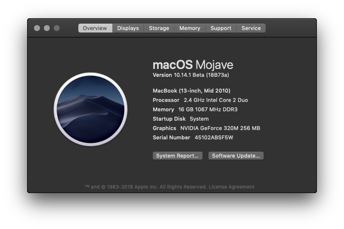

It worked for me.
@joelw135 from your previous picture (this APFS scheme diskutil), I saw you have a regular APFS scheme, that's it should be to anyone, could you try this typing from Mojave Terminal:
sudo nvram boot-args="-no_compat_check -v"
then reboot and after the power-on chime hold and keep CMD+R , and post a picture of what you see at screen, it's a verbose diagnostic part for the APFS Recovery so I can inspect why don't work to others.
After you took the picture reboot to your Mojave and don't worry you will have all verbose lines, it's normal to return standard apple logo progress bar type this from Terminal:
sudo nvram boot-args="-no_compat_check"
