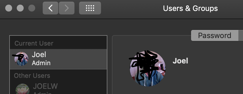

Now my user name would be the one in the folder users so in my case joelwaxman or is it the name on my admin account in users and groups?. Please let me know if this is correect, and do I just plug it in as two words into the line where it says YourUsername? So would it be like this?
pkgutil --expand-full /Volumes/Mojave\ HD/Users/joelwaxman/Desktop/macOSUpd10.14.1.pkg /Volumes/Mojave\ HD/Users/joelwaxman/Desktop/macOSUpd10.14.1/
yes | sudo cp -rf /Volumes/Mojave\ HD/Users/joelwaxman/Desktop/macOSUpd10.14.1/Payload/ /Volumes/Mojave\ HD/
I am hoping Julian has the script done with instructions as I screwed it up royally. I got both working with terminal commands, but a script would be a great solution.

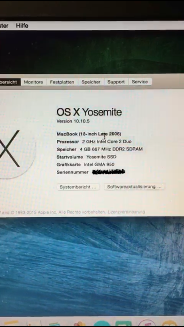

I know it is possible to run Yosemite with MacPostFactor, at least it works perfectly on mine (except graphics acceleration). You could actually run Mojave on one of these but you would have to swap the logic board with one from a non unibody 2009 MacBook. As far as I can tell the 2006-2009 MacBooks are pretty similar in how they are built. I've swapped multiple parts between my 2006, 2007, 2008 and 2009 MacBooks. Sometimes connectors are different (e.g. SATA/IDE and the connector for the LCD) but for the most parts they are interchangeable. I think it should work with the logic board as well.
I even thought about purchasing a black MacBook LCD, top case, bottom case and a 2009 MB logic board from AliExpress which are brand new (except the LB) and building my own BlackBook that can run Mojave. It would be a cool project and I'd love to do it when I have time :)
No, you can't. On a Core Duo system (MacBook1,1), you can only run OS X versions that will boot in 32-bit mode. Snow Leopard and lower, last time I checked.
Feel free to prove me wrong if some work has been done to bypass that, but I think it is impossible.
Newer MacBooks (2,1 and others, I believe) have a Core 2 Duo which is 64-bit. However the EFI code is 32-bit. So a custom boot.efi is required to boot, but it is possible, unlike on fully 32-bit hardware.

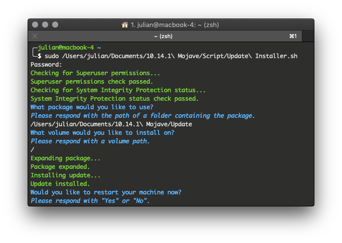

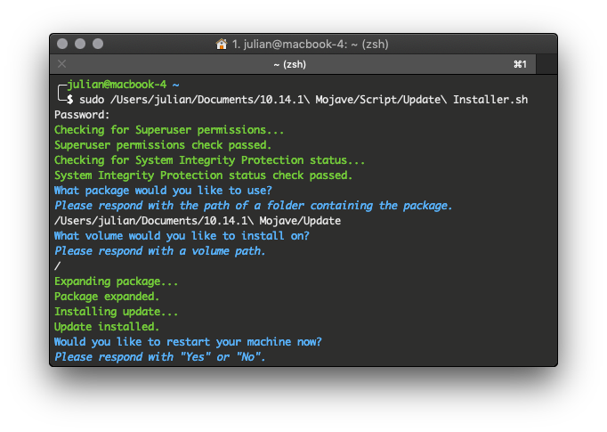

How to Install macOS Mojave 10.14.1 Betas
If you're having firmware update issues on your device that makes installing macOS Mojave 10.14.1 betas impossible, then you can use the script I have developed in conjunction with the update package to install manually by copying over the files directly from the package to your system.
To use the script, download it from this post and run chmod +x /path/to/script to make it executable. If you're running the script from a normal system then you must run sudo /path/to/script. If you're running it from a recovery or an installer volume then you have to run it without sudo.
The script will ask for two paths, the path for your package and the and path for your volume. For the package, you have to enter the full path to the folder containing the package. For the volume you have to enter either / if you'd like to install on the volume you're currently booted from or /Volumes/volume/ if you're running from a recovery volume, an installer volume, or simply would like to install on another volume altogether.
You have to use the full path for the package folder, which means, if you have it on your desktop for example you can't do ~/Desktop/, instead you have to do /Users/username/Desktop/ or /Volumes/volume/Users/username/Desktop/ if you're running from a recovery or an installer volume.
You can also run the commands manually if you prefer. If you want to do that then you must run these commands one after the other and wait for them to complete.
pkgutil --expand-full /path/macOSUpd10.14.1.pkg /path/macOSUpd10.14.1
sudo cp -rf /path/macOSUpd10.14.1/Payload/ /Volumes/volume/ or /
You can download the update package from here.
If you have any questions or issues please don't hesitate to contact me.
That is true. My oldest MacBook is a Late 2006 (I think it the identifier is 2,1) and Yosemite works great on it. I never owned an Early 2006 so I can't say anything about those. But in order to run Mojave a logic board swap would be necessary which I think can be done quite easily. I'm not a trained/professional technician by any means but I've done many repairs before and I find it quite simple to replace parts or do modifications on the original MacBook series.
For the Yosemite MacPostFactor Installation I can say that even cloning the system between MacBooks works without any problems (I did this on my MacBook Late 2006 for which I simply cloned the patched OS partition from my MacBook Early 2008 via FireWire).
Sorry for MacPostFactor-Offtopic, back to Mojave discussions :)

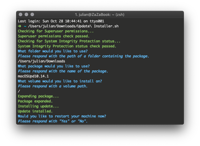

Version two of my script is attached here. You now have to type the name of the package in addition to the path of the folder containing it. This is for compatibility with future versions.
A couple of questions please.
  1. Do I need to run @dosdude1's mac post install (from his mojave patcher app) before reboot after the update?
  2. If I need to install beta 4 instead of beta 5, can I use the macOSUpdate package downloaded from my developer beta seed? Reason for this question is that noticed beta 5 performance is worse than beta 4.
P.S. Although I was able to successfully update via OTA (System Preferences | Software Update) on one of my unsupported macs (MBAir4,2), it failed on my unsupported MBPro5,5. So I want to test this "manual" update.
Thanks.
