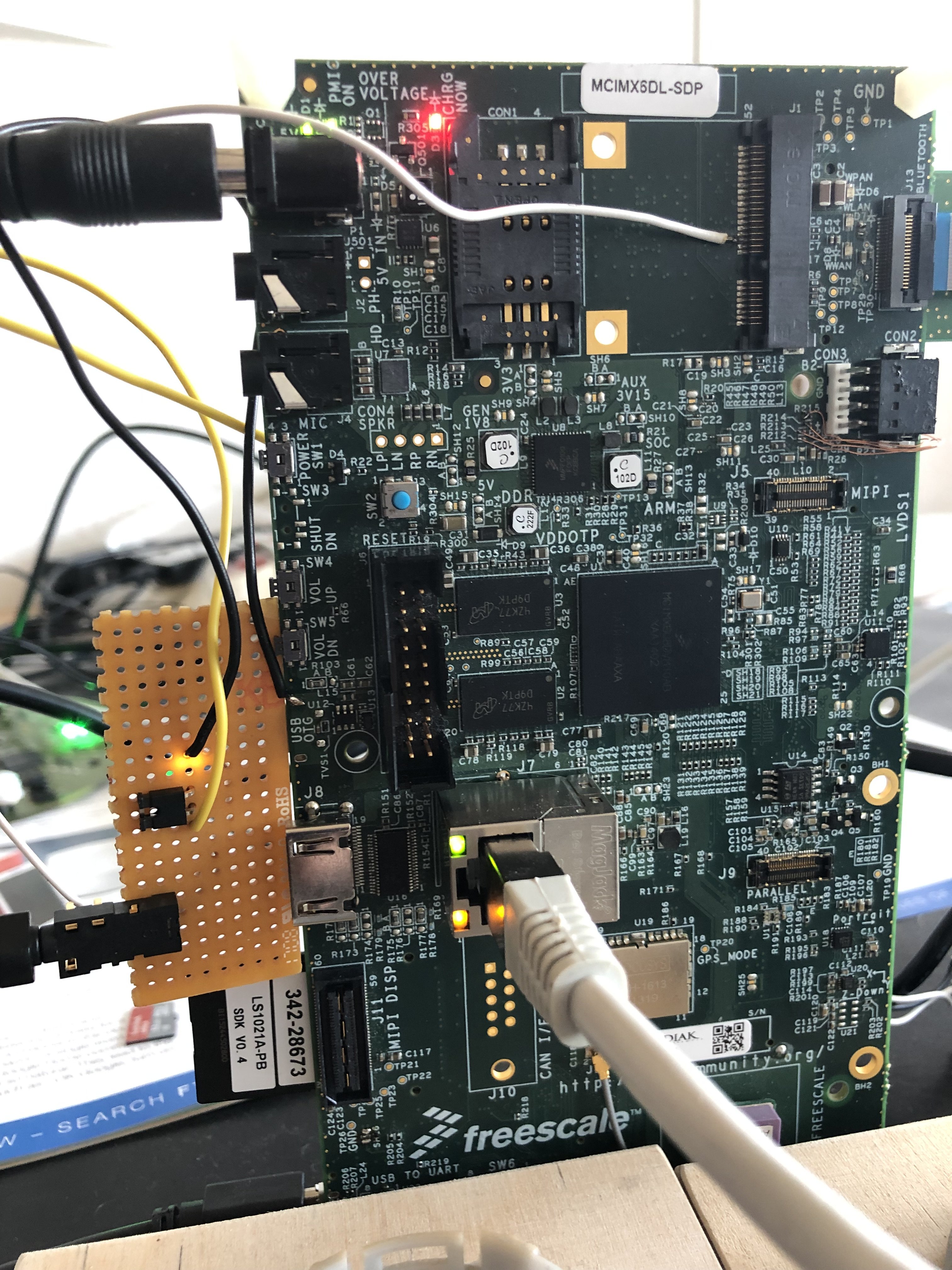

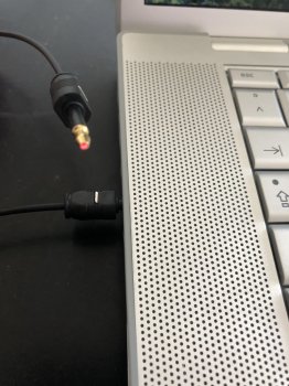

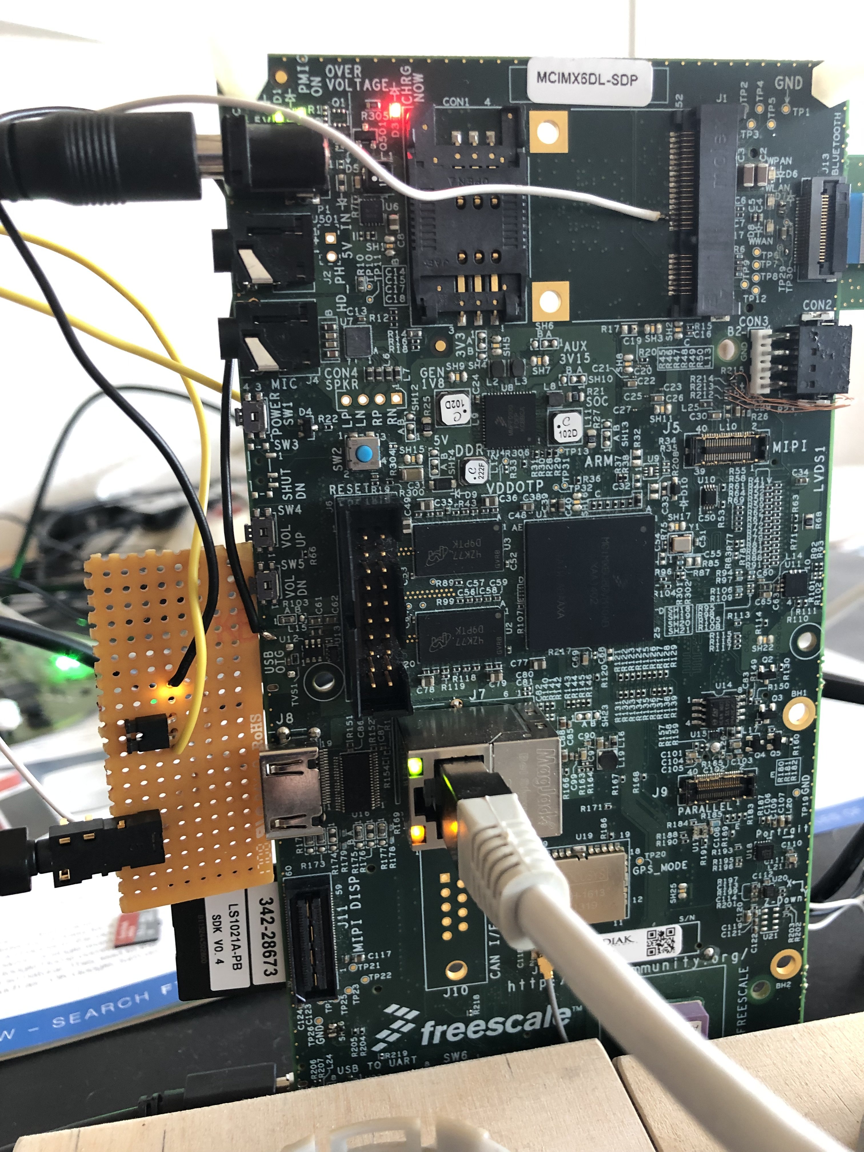

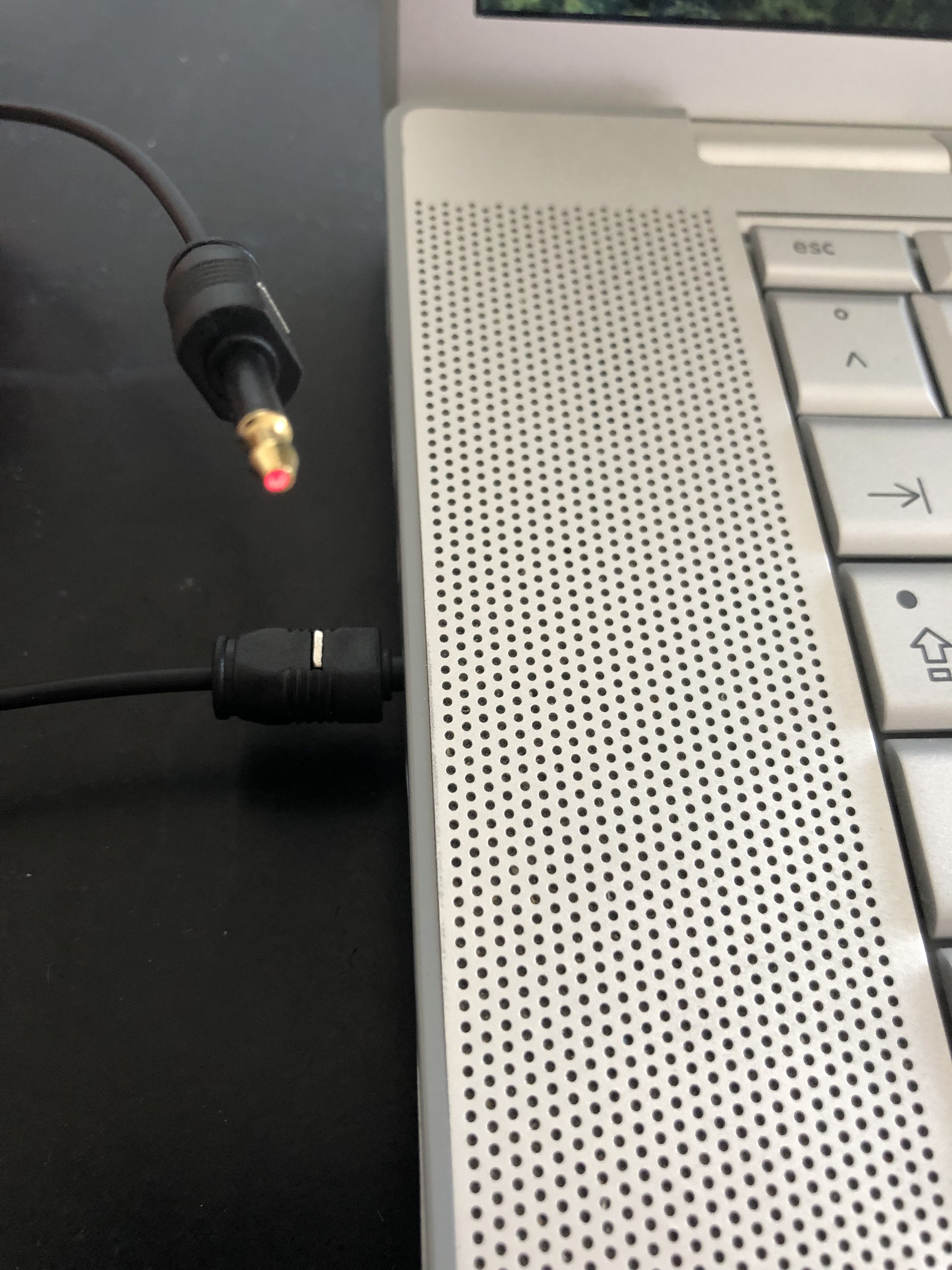

Got my cables today and it still works on old MBP4,1 under Mojave. Great.
We could even connect to a Freescale eval board.

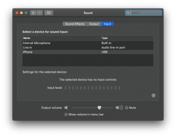

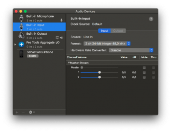

Might also be of interest to the rest here: The tool "LineIn" can mux input to output in any combination, so it´s great to play through from digital in to internal speakers etc.
https://www.macupdate.com/app/mac/11333/linein
Perhaps.

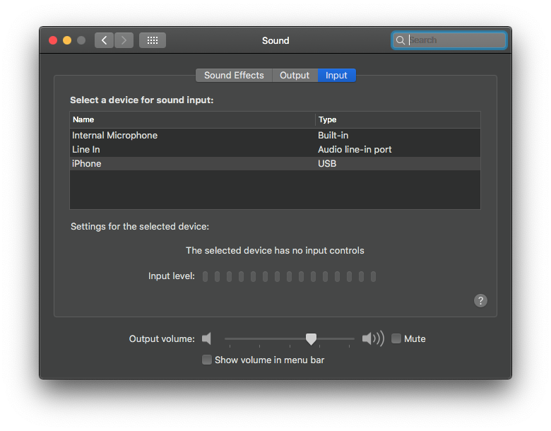

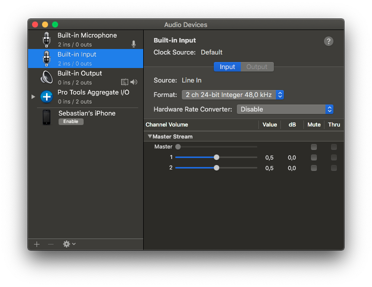

I know, this is pretty amazing. You can even connect your iPhone (Lightning required) and use it to stream music through your mac (if you have some nice speakers connected to your mac for example).
Just go to Utilities, Audio MIDI Setup and enable your iPhone. After that you can select it as an input source (Trusted iPhone - Mac connection required).
