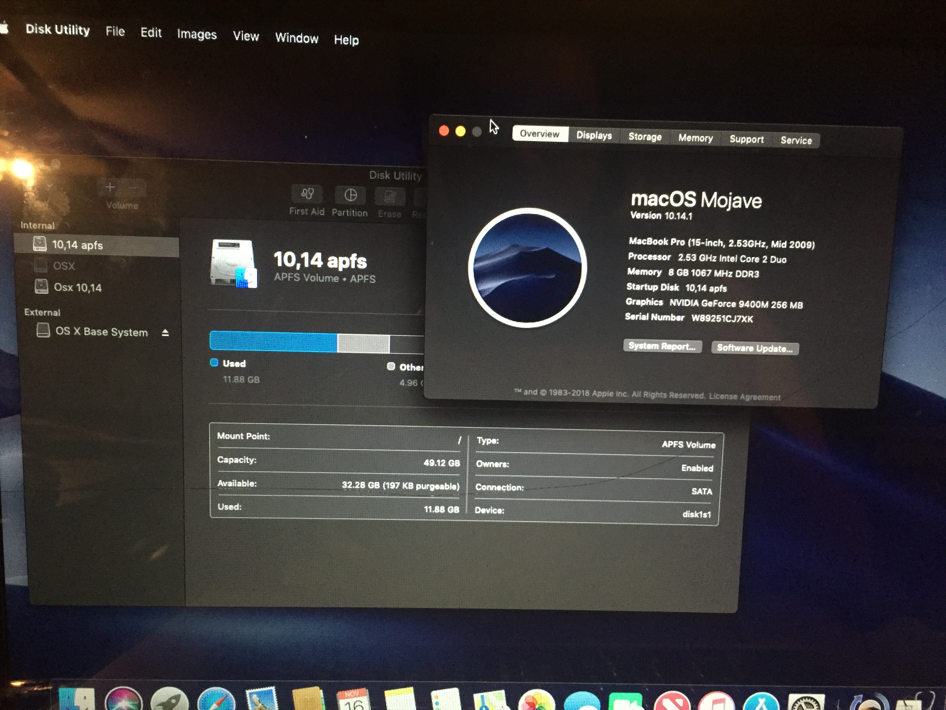

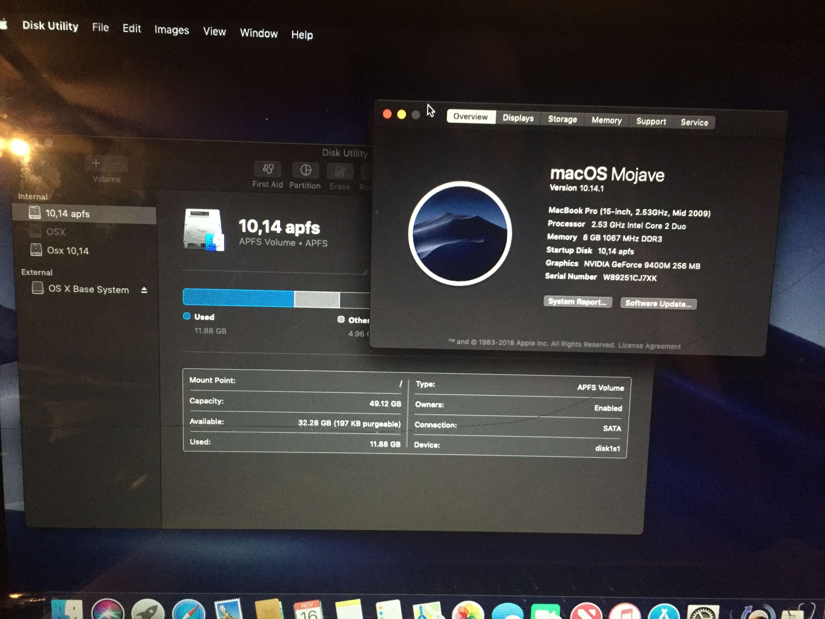

Can someone make me an apfs rom for my mbp mid 2009?
Thx

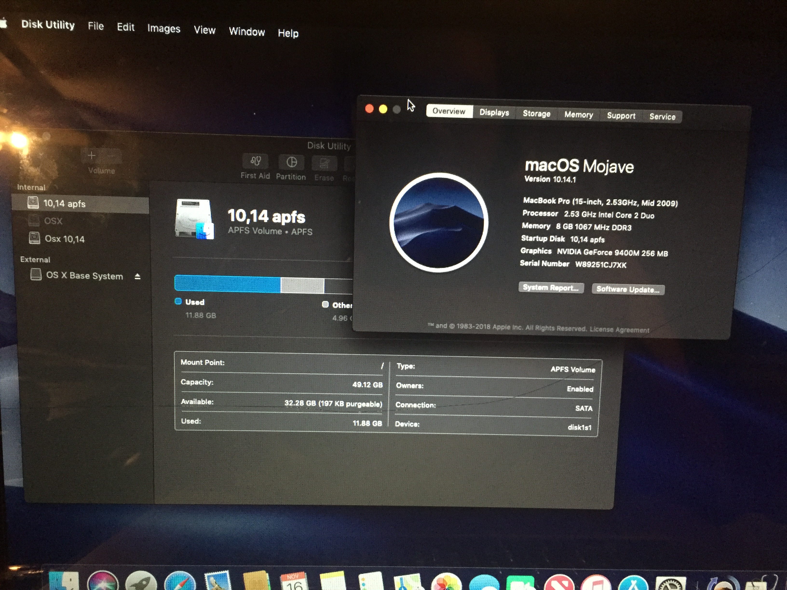

apfs works on my mid 09 mbp. just dose the code thing as stated in dose dudes vid.
you guys rock thanks. i just installed 10,14 on my mid 09 mbp last night to try it out. using a Small repeat partitions and other then the as stated glitched with light and dark modes it seems to be working like it should. but again i did this as a test not ready to jump ship to it untell you all work more out on it. ps liking dark mode
also just to throw this out there optical audio appears to be working on mine if that counts for any thing.

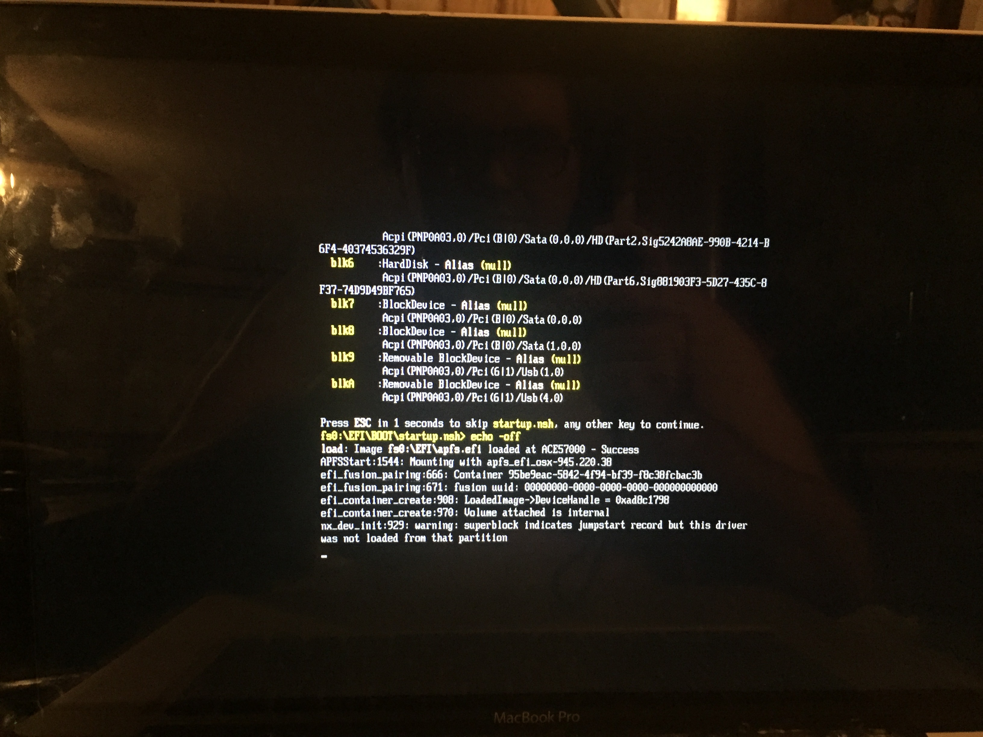

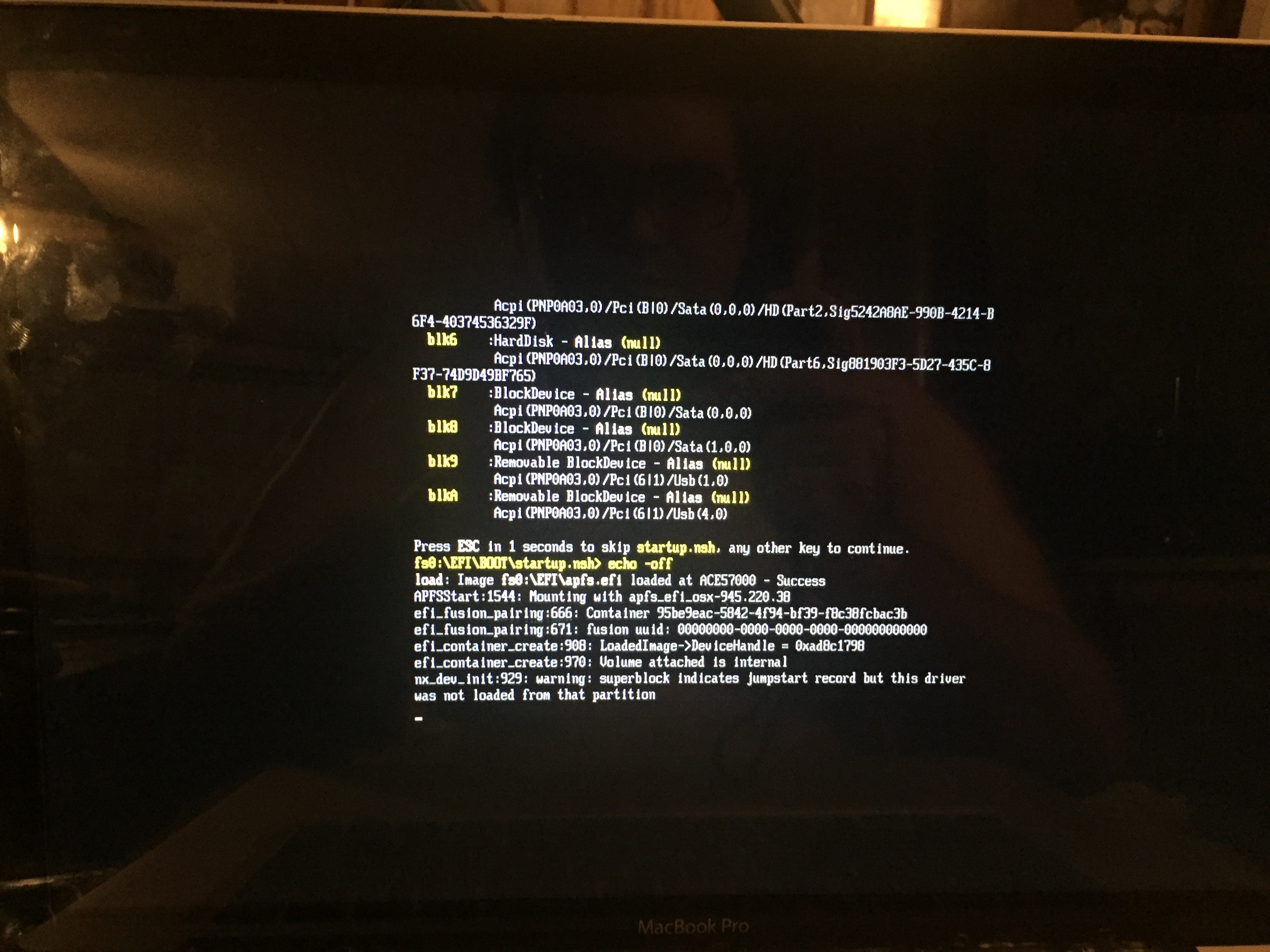

whats up with the code thing on apfs boot any how ?

Running the latest 10.14.1 and dosdude1 patches.
I must say the system is faster than 10.14. Apple did the great job on the update and the team here did a great job making it so seamless to install. I've been doing a fresh install each time. Hope to install on top next time as I am finally settling down.

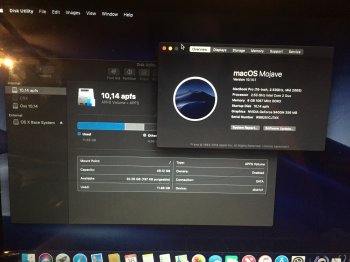

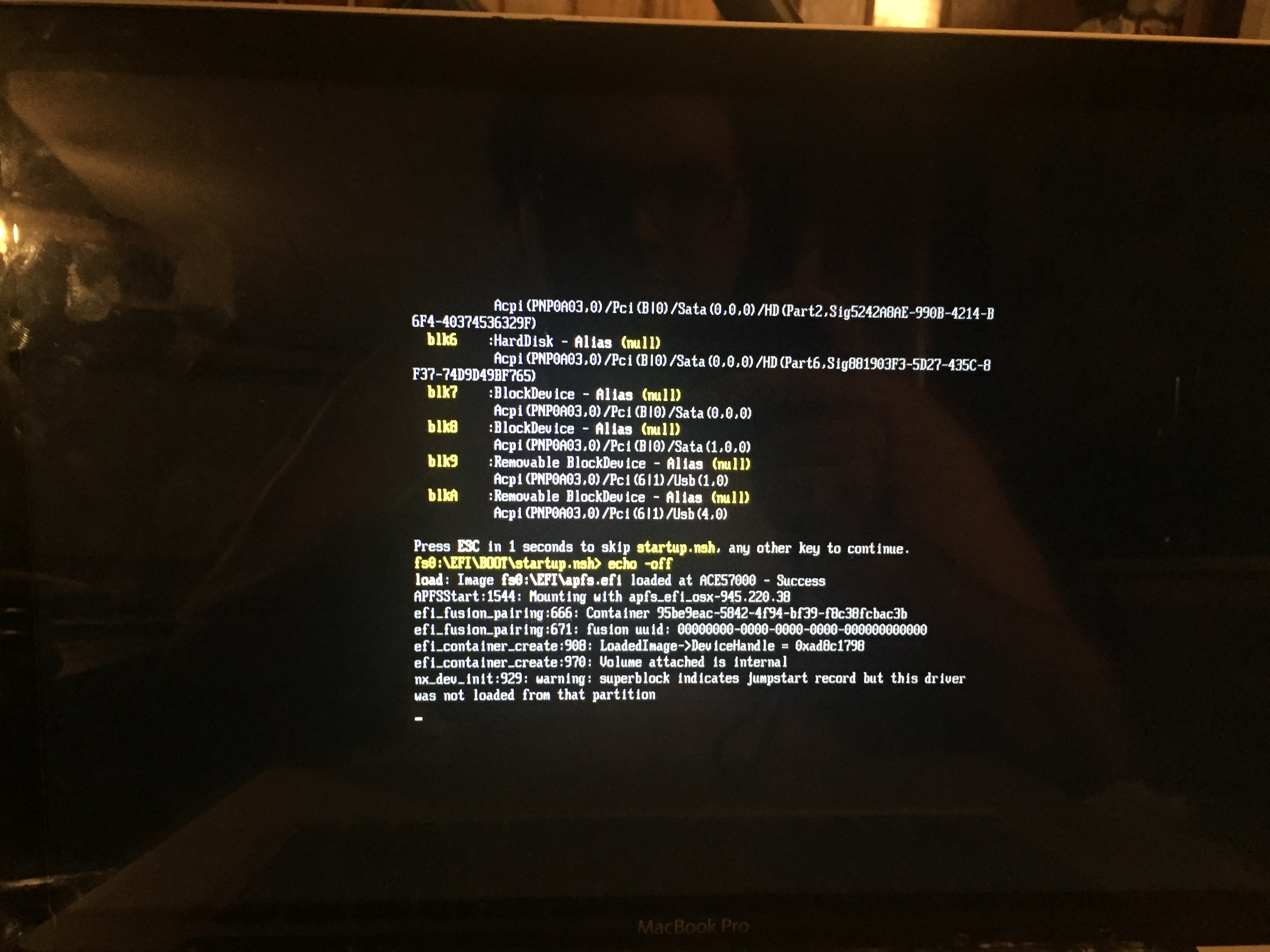

I created a fresh 10.14.1 installation on an external APFS formatted SSD, to see if I could duplicate the seamless OTA update to 10.14.2 Beta 3 on my mid-2009 13" MB 5,2 that I had achieved with my Early-2011 15" MBP 8,2.
Installation from System Preferences Software Update completed without incident, but booting initially failed, completing the verbose software APFS boot steps before falling back to boot into the 10.11.6 installation on the internal SSD.
Applying the relevant post-install patches from @dosdude1's v1.2.3 patcher for the 5,2 rectified the boot problem, and it is now running 10.14.2 Beta (18C48a).

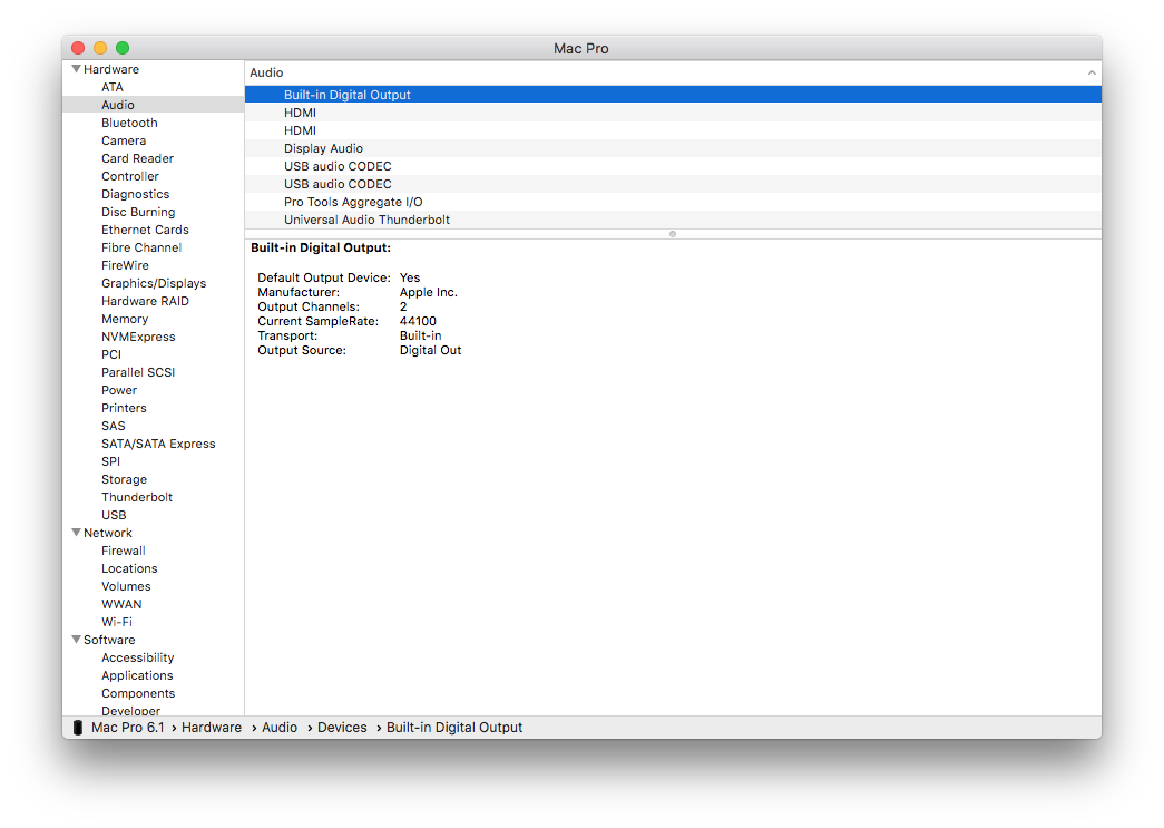

Interesting. System report is not showing the Intel Audio section at all on my MBP 2012.
On my cMP 1,1 and 5,1 it's excactly as you say. S/PDIF is shown in audio system settings and the system report. I can't find a mini Toslink cable to check if the behaviour on the MBP is driver related (broken installation) or supposed to be like that. I just remembered that it only shows up if connected (like it does with headphones connected)
EDIT: My nMP 6,1 is not showing any S/PDIF either and it's suppose to support mini Toslink as well..
I could be way off here, but I think that may be the default for Mojave. Mine only showed, microphone, system audio out, and headphones. Can you copy the drivers or kexts from whatever operating system you're using and paste them to it?

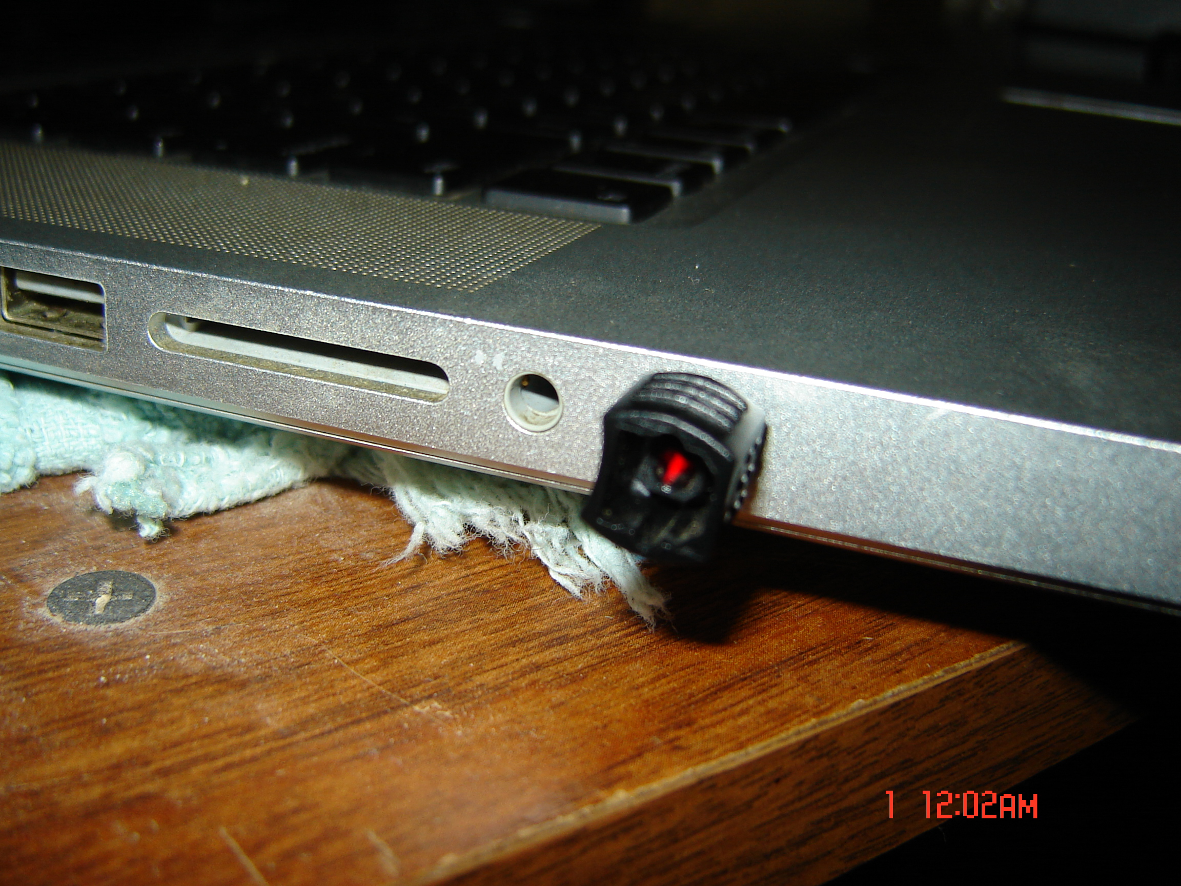

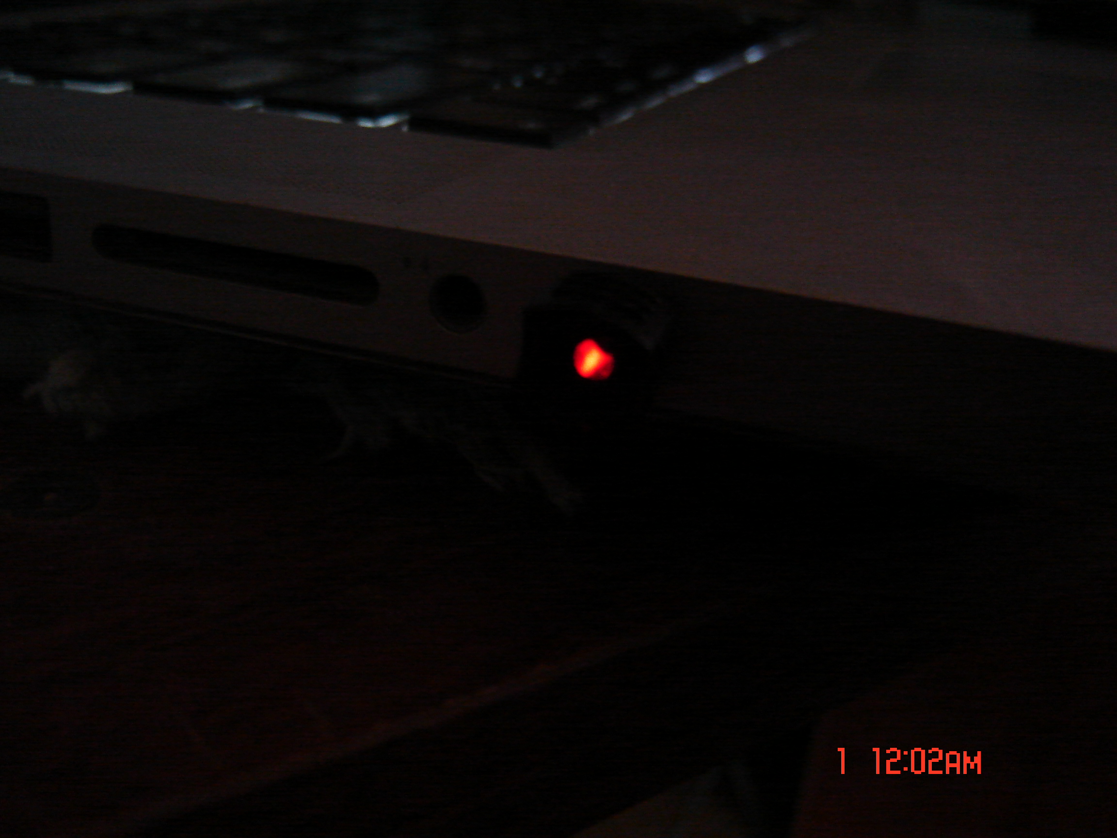

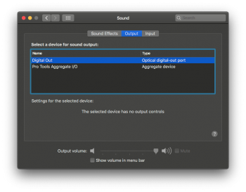

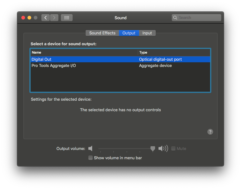

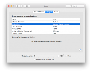

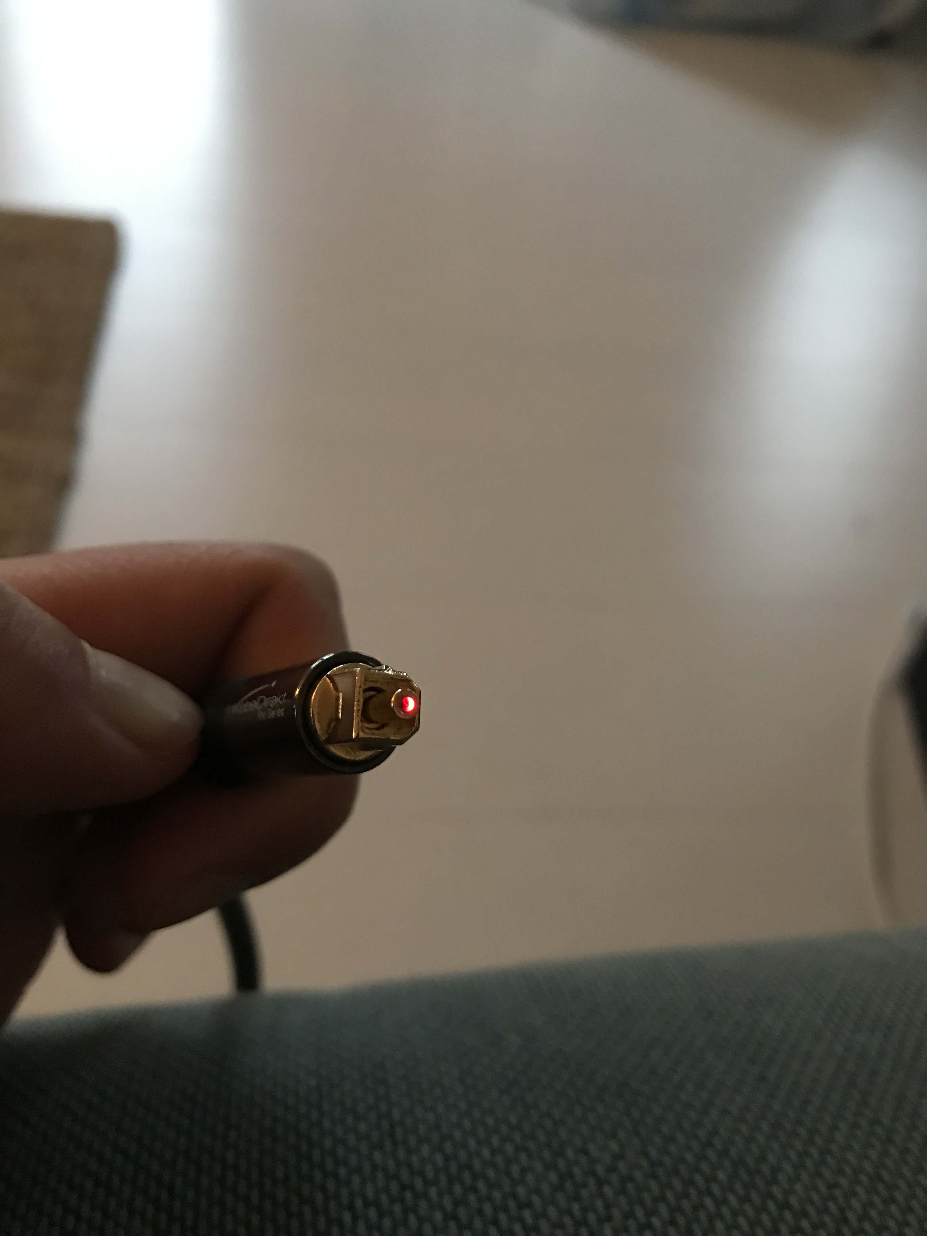

To bring some light (literally) into the digital I/O discussion within Mojave.
I bought a mini Toslink cable and did some testing.
As soon as you connect the cable to your headphone jack it's recognized within the 'sound' tab in system preferences.
1. Select the digital output (no red light on the other side of the cable yet)
2. Start iTunes or any Player you would like to listen to
3. Hit play (red light turns on, meaning it's automatically syncing with the connected device)
4. Depending on your setup you should hear whatever you're playing (don't listen to bad music)
Btw. it's not shown as Intel Audio Device within system report anymore though the output source says 'Digital Out' when connected..

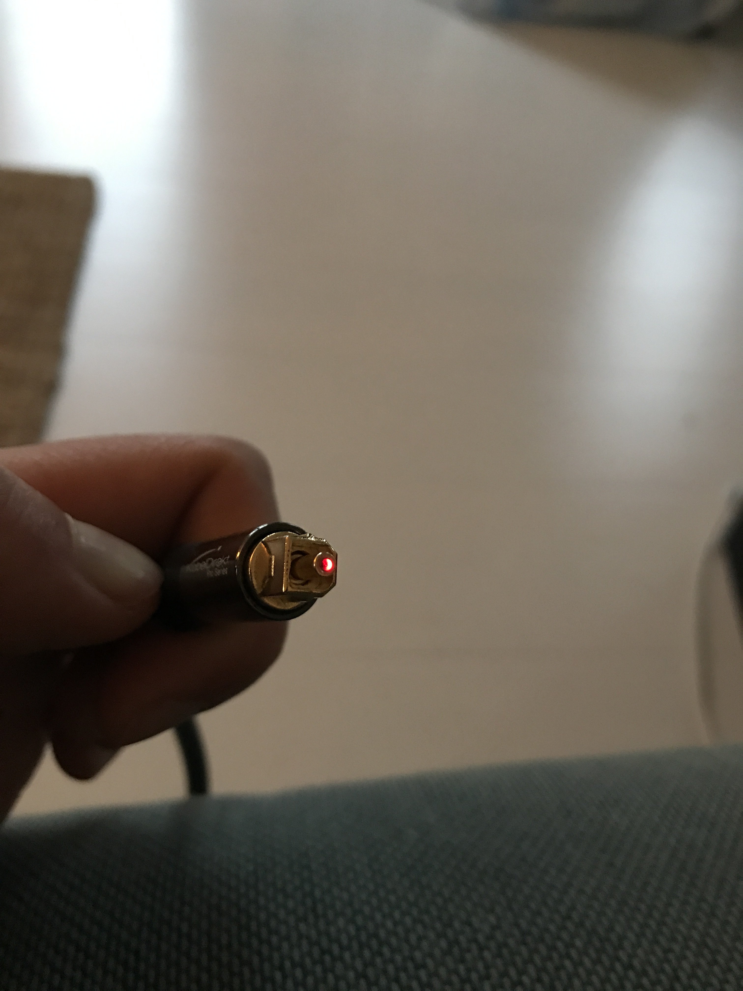

I need to get my Digital Out working again. Lost my cable or I sold it and forgot about it. But I have this large Samsung speaker bar that my neighbor was throwing out the window and its has Digital Out, HDMI out, Analog Out, and I forget what else, but it's awesome I picked it up for free and its works great.
Reactions: TimothyR734
I need to get my Digital Out working again. Lost my cable or I sold it and forgot about it. But I have this large Samsung speaker bar that my neighbor was throwing out the window and its has Digital Out, HDMI out, Analog Out, and I forget what else, but it's awesome I picked it up for free. I would image this bar costing at least 100 dollars.
Should work as soon as you connect the mini Toslink cable to your computer.
Otherwise you could use a miniDP to HDMI cable to connect the speaker. Depends on your Mac if audio via miniDP is supported.
I assume you mean 'In' when you wrote about the Samsung speaker?
Another thought: Perhaps in this S/PDIF case some voodoo might help? (I´m absolutely no fan of mixing hackintosh and vintag
View attachment 804708 View attachment 804709
The "code thing" at startup is the workaround for booting APFS as long as you have not patched the boot ROM.

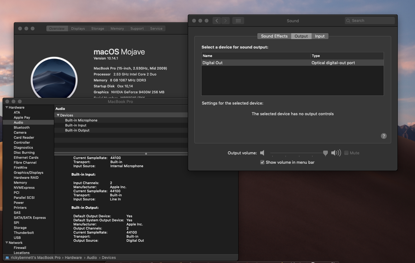

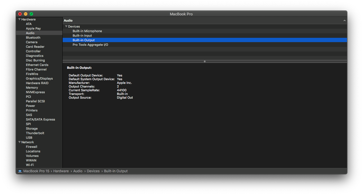

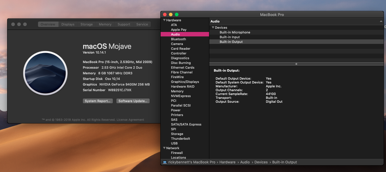

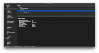

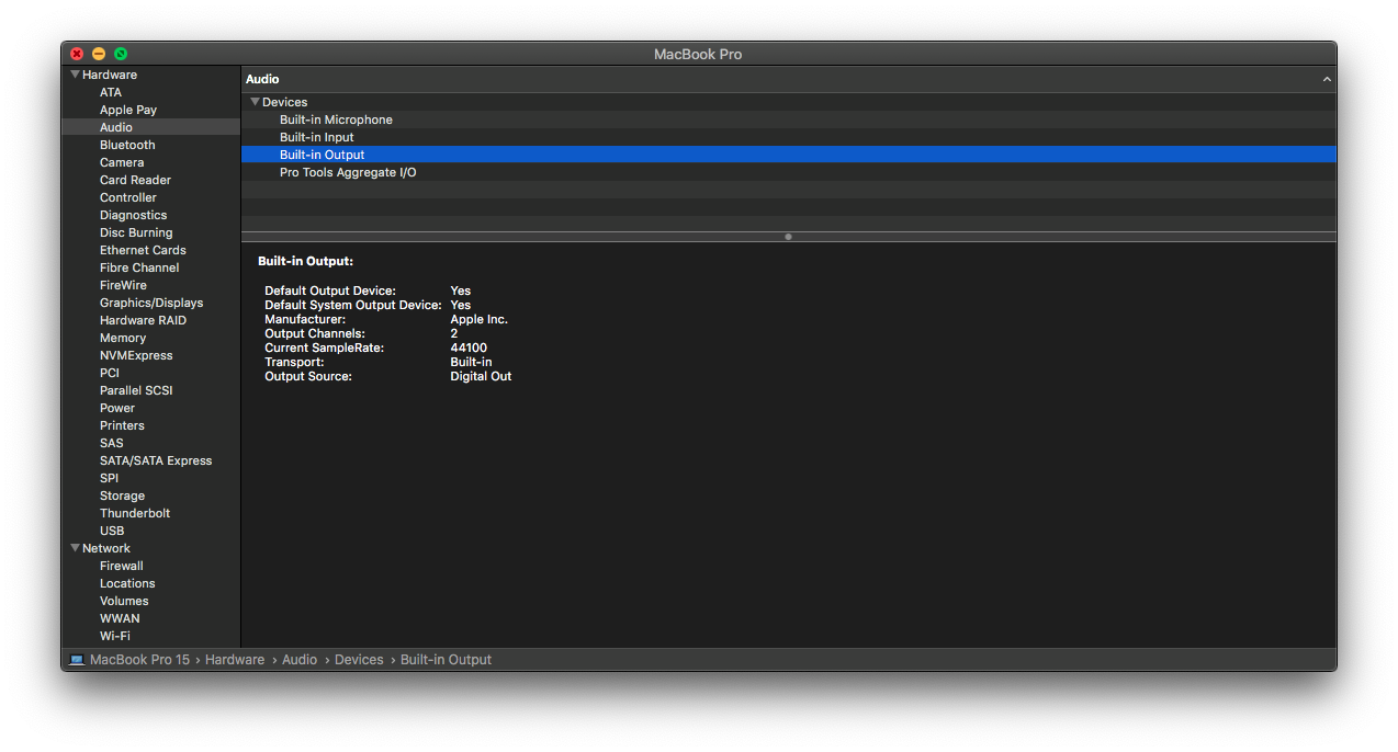

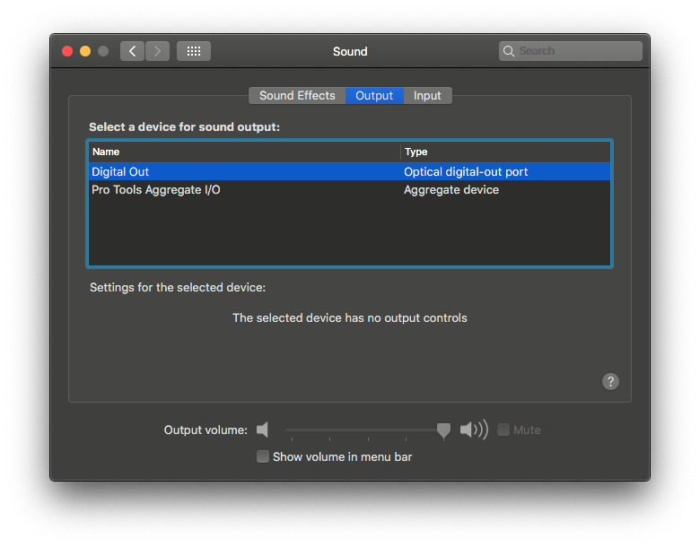

Could you send a screenshot of the system info about audio, I´d like to see how S/PDIF digital audio is represented there... thanks!

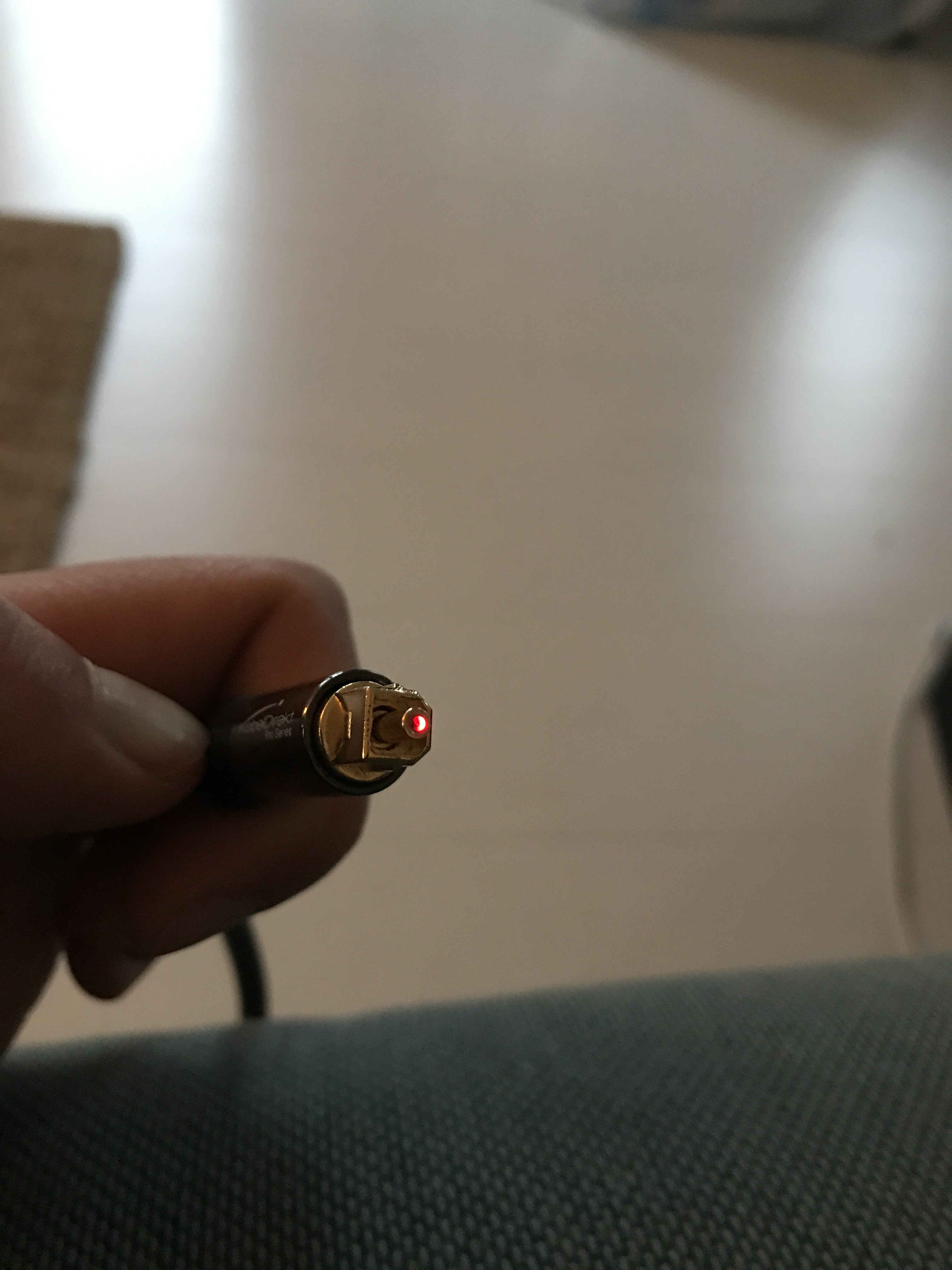

View attachment 804782 View attachment 804783 View attachment 804784
THAT is great news - thank you! Then I´m looking forward to receiving my bunch of cables for the office work next week. Will post my results here...
Nota bene: I´m relieved that we don´t have to mess around with the voodoo kexts ;-)

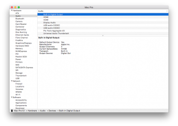

Just double checked on my nMP - same behavior. Digitial output appears as soon as you plug in the mini Toslink cable.
So you should be fine with whatever you're planning :)

this what you need ?

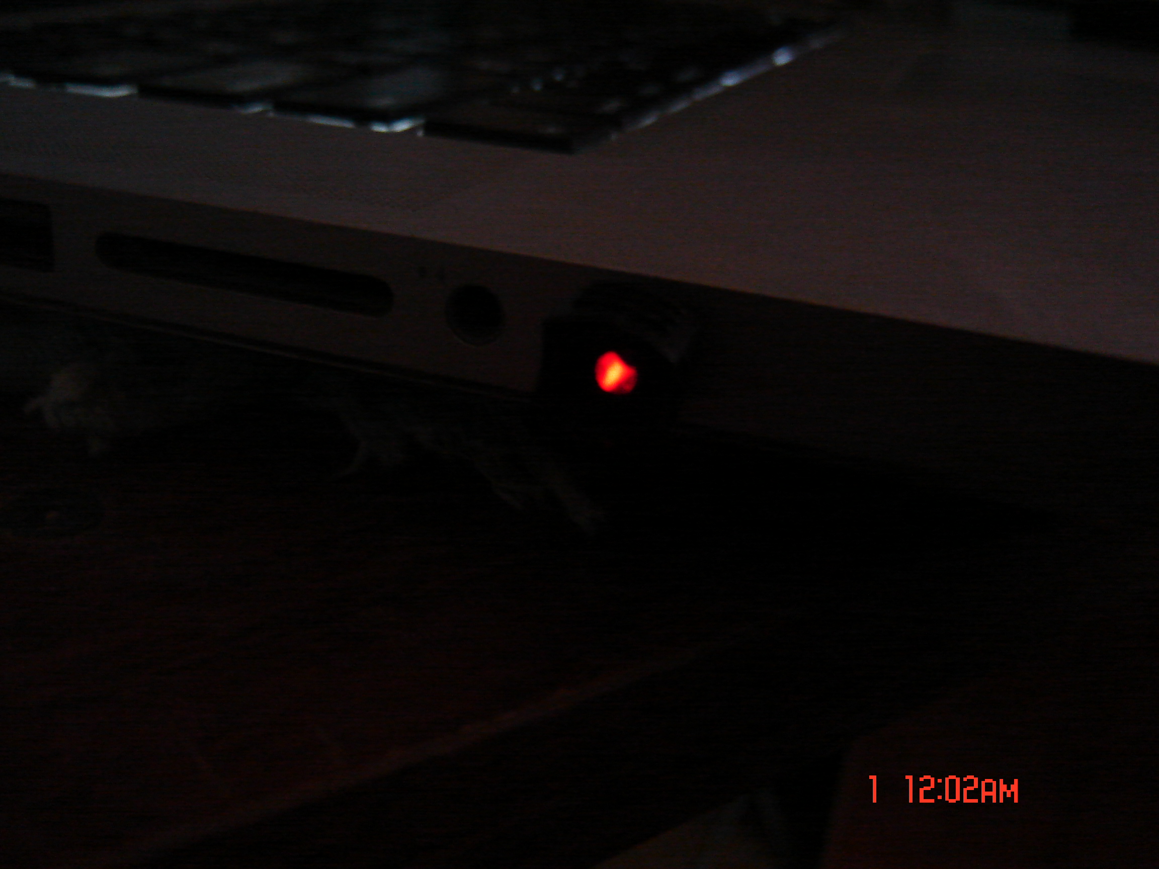

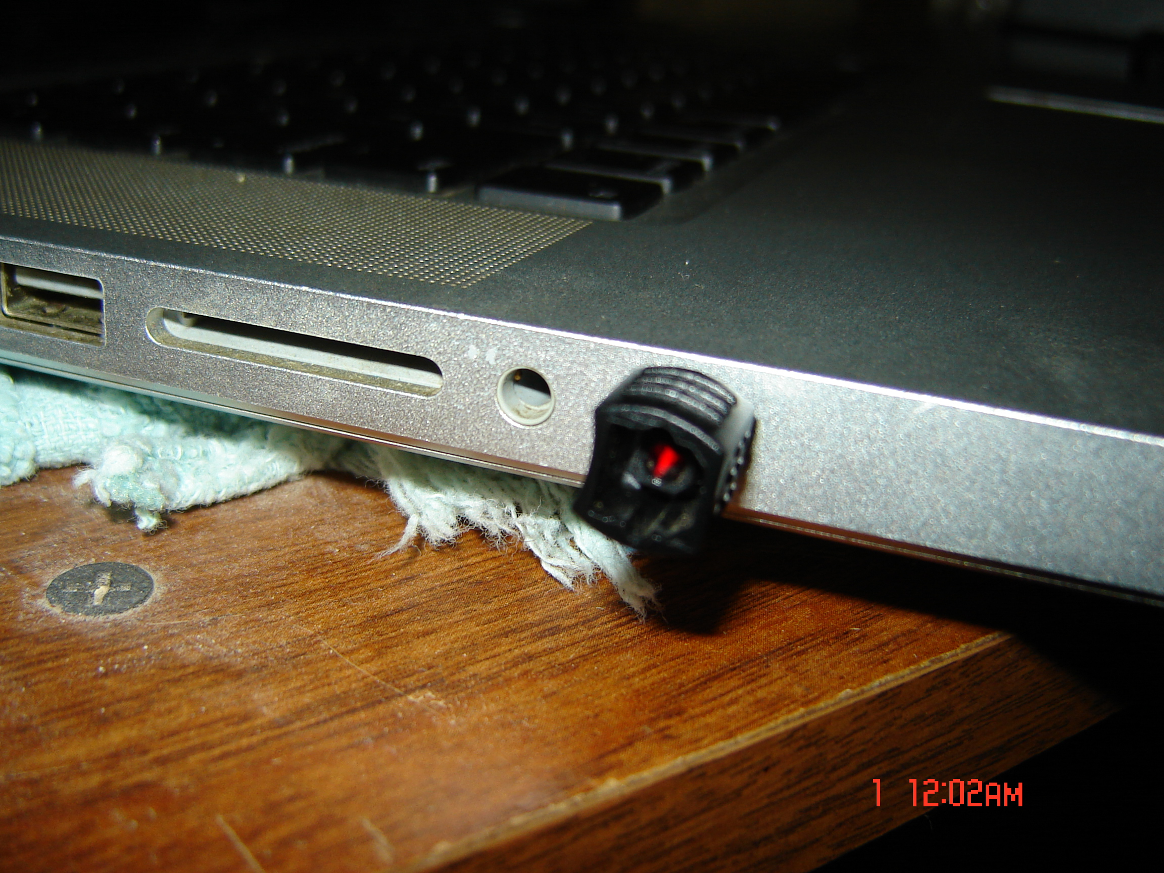

also hear is a photo of the optical adapter in the head phone port
uploaded one more screen shot
