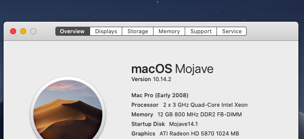

used current patcher 1.2.3, let the patcher app download Mojave (10.14.2)
created Installer Partition with it
installed over 10.14.1
let after patches run
works on Mac Pro 3.1 / HD5870 / HFSplus on spinner

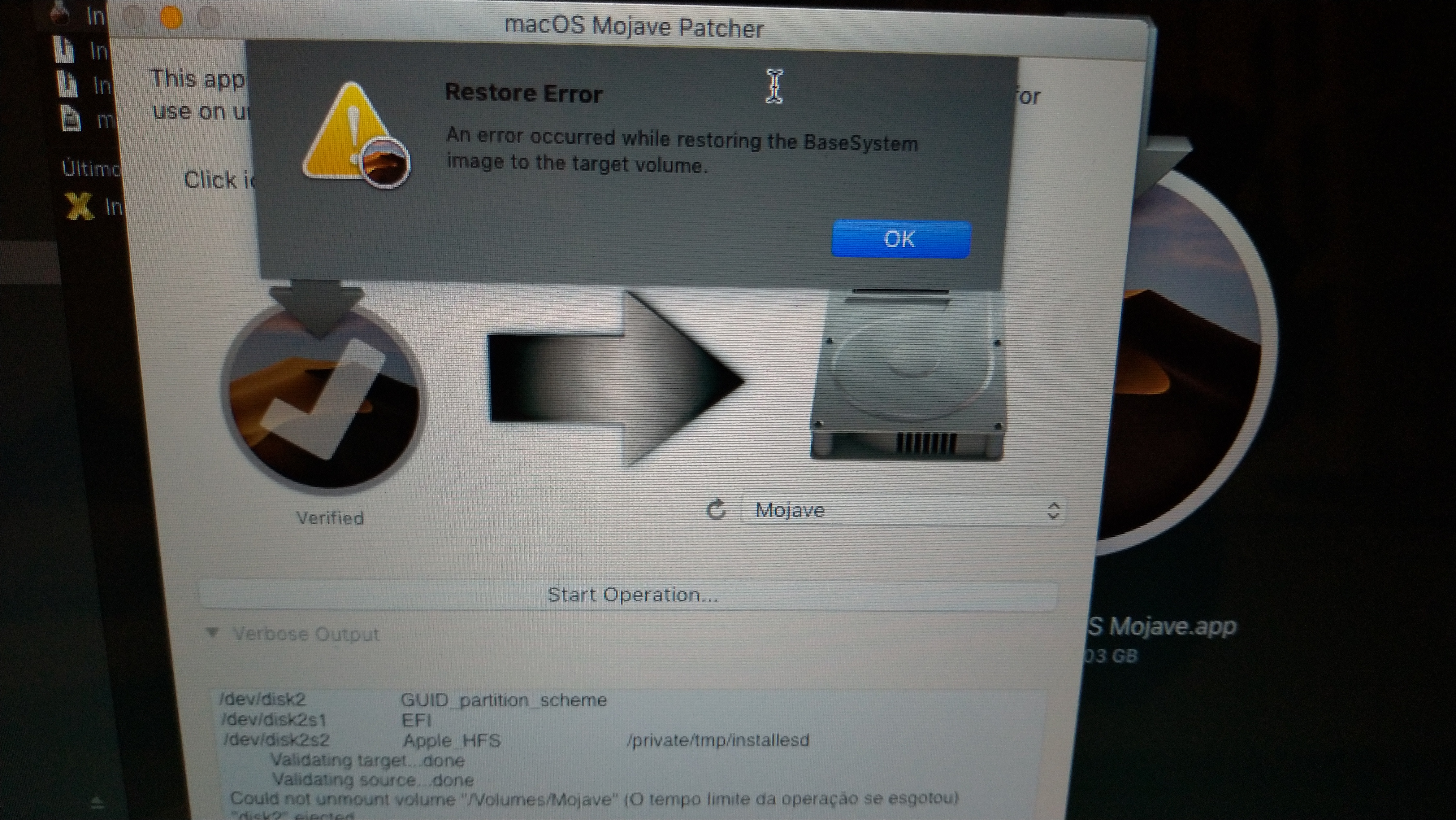

Hello guys!!!

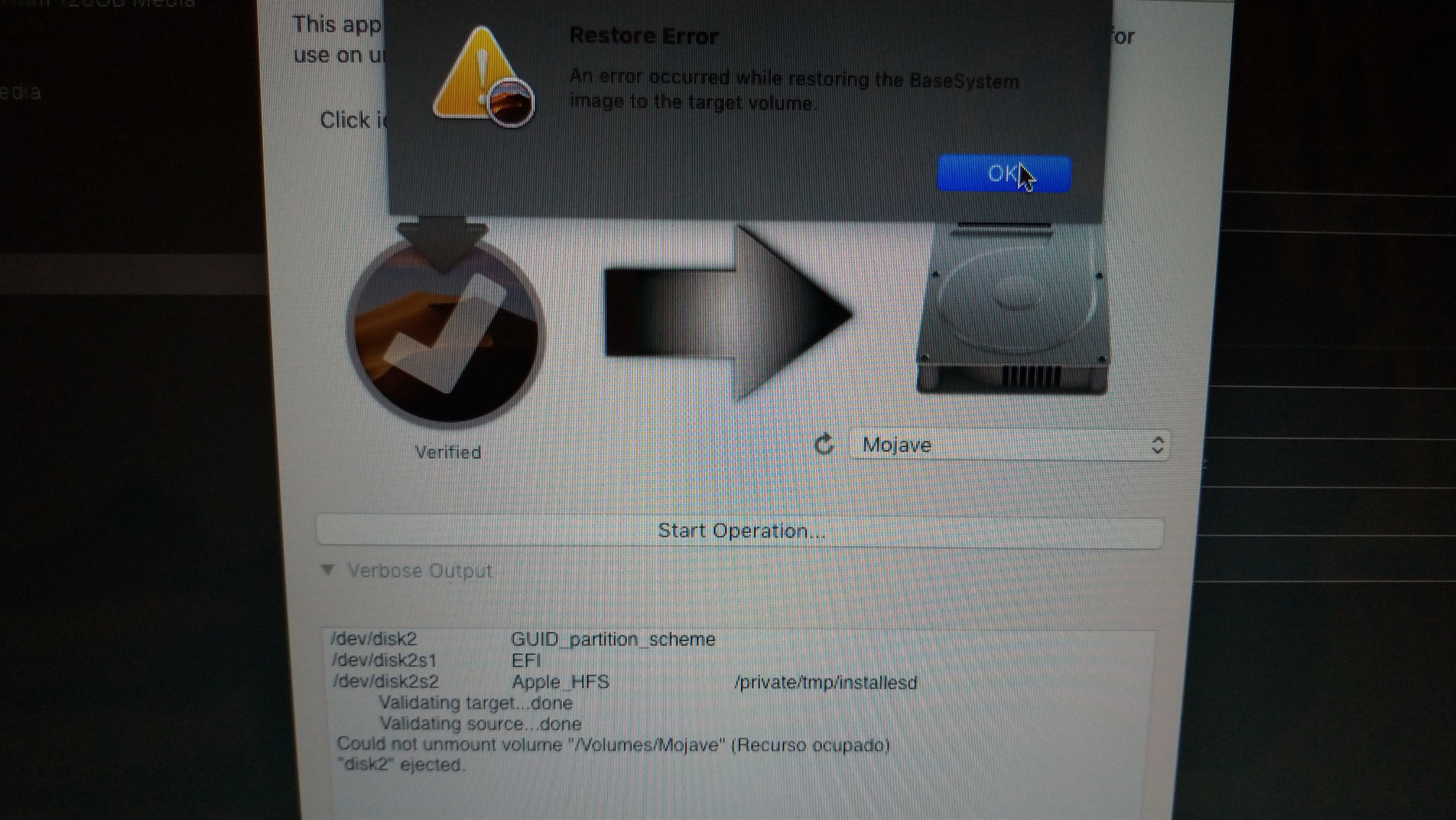

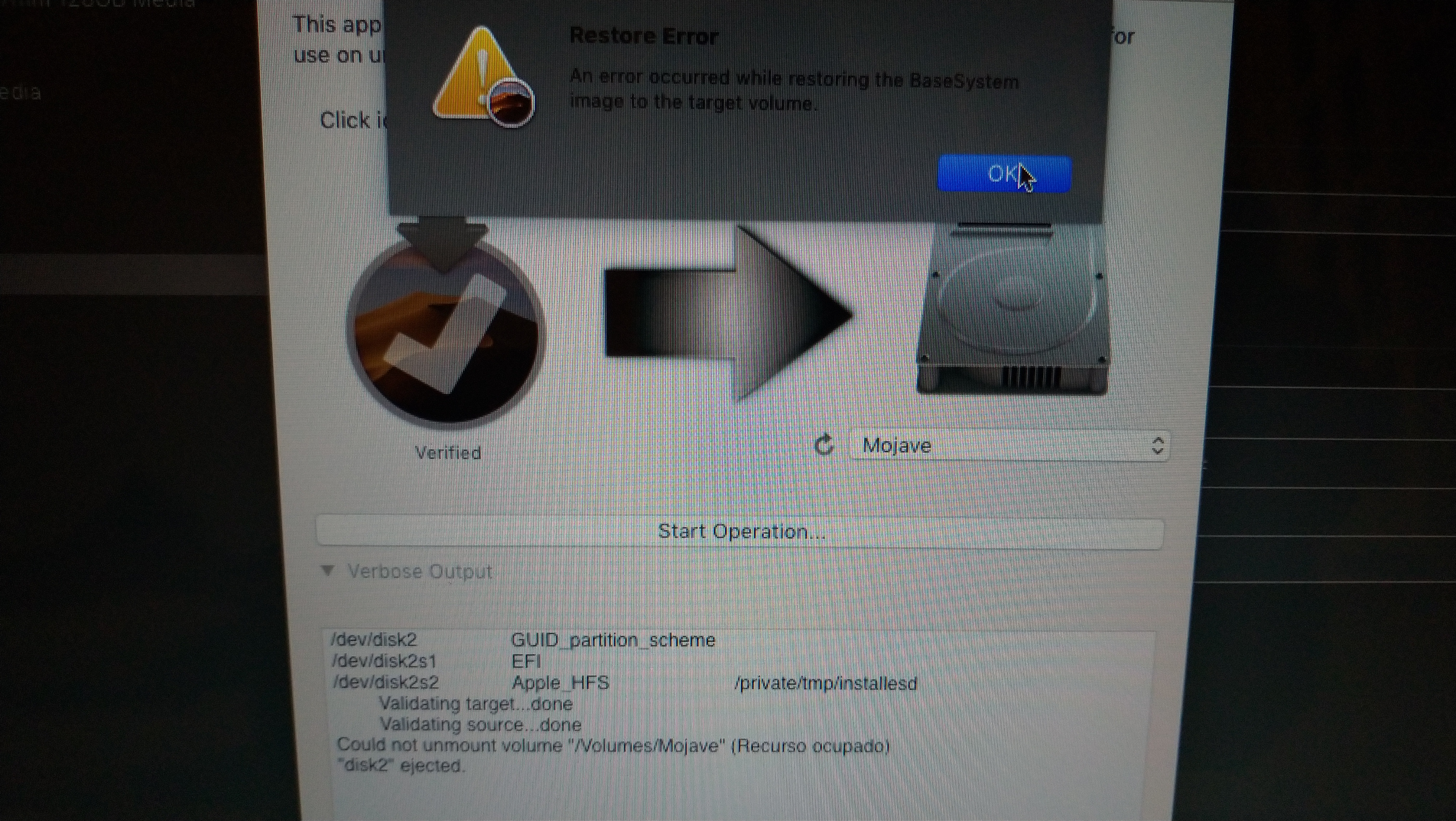

I have MacBook Pro (13-inch, Late 2011) with Mojave 10.14 thanks to the edits posted here. However, I can not upgrade to 10.14.1 or 10.14.2. I've used several different types of pendrive, sizes and brands. The information is that it was not possible to record. I'm using the correct patcher. I have already downloaded the installer both from Patcher and from the App Store. can anybody help me? Thank you.

I've done this several times. I used different devices.

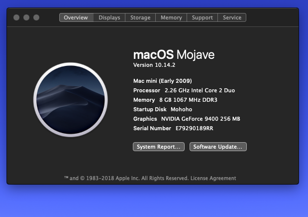

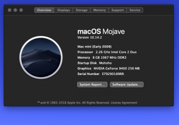

Yes, it worked perfectly as described on @dosdude1 s website:
  • Downloaded the latest version of Mojave Patcher
  • Downloaded the installer using the Tools menu of Mojave Patcher
  • Created a patched USB installer on a newly formatted USB Stick
  • Booted from the stick and install 10.14.2 onto my current drive (usually named Macintosh HD)
  • Rebooted the Mac
  • Selected my MacMini 3,1 in the MacOS PostInstall tool
  • Installed the patches (using force cache rebuiled)
  • Rebooted to the operating system and voila I am now on 10.14.2
Perfect 🙂

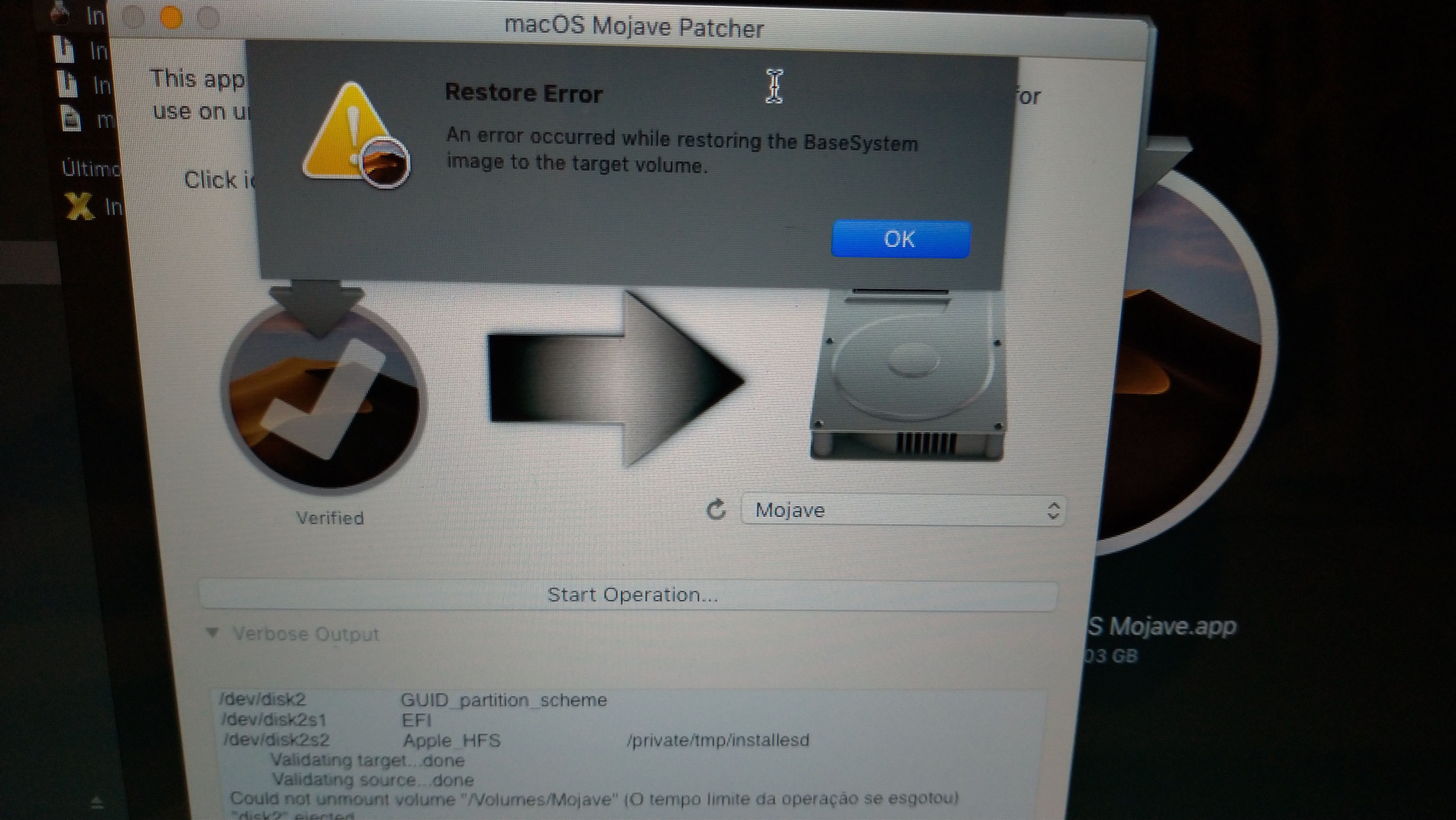

Sim. Primeira vez (10.14). Everything is OK. But not now.

Dont understand this language but the picture. Got kinda same message when running the patcher in Mojave. Later I used it in El Capitan and it worked. So somehow the patcher itself will run not in Mojave ?
Oh, I didn't realize that was the issue. Yes it's still HFS+, I'm running it on a hard disk, so I figured that was best.
And even if you applied the update successfully, you would still need to use the usb installer to reapply the patches for patched files that may have been replaced during the update.
